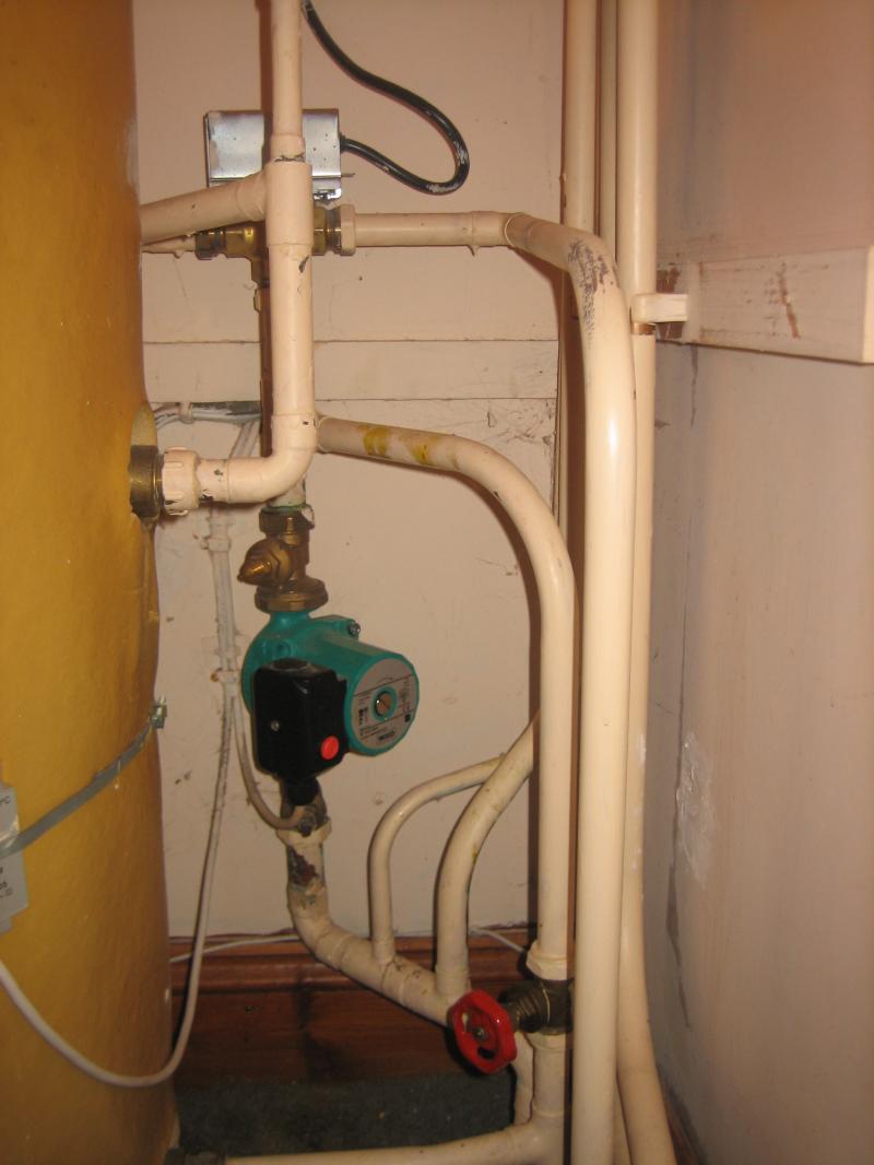

Magnaclean or Powerflush?

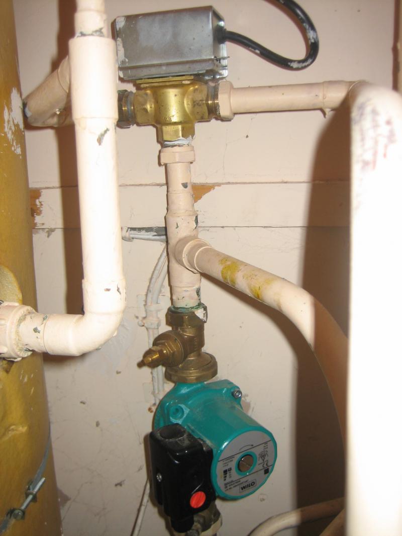

There is no room between the motorised valve and pump, but there is a pipe coming off the motorised valve which is hot, which would have enough room. would that work?
Best to move the pump or MV to allow the magna clean to be installed between them.
post some pics of your pipes so we can all have a look
what is the function of that pipe tee'd off between the pump and the 3-port valve?

What would be better given the circumstances, powerflush or a magnaclean?
Try a double dose of X400, AND a Magnaclean, for about a month. Then replace any radiators that are still completely crudded up. In most houses the total bill will still be less than a powerflush.

Due to the amount of rads i used a double dose of X400, and if i did change a rad wouldn't it be in the pipes still?
yep. try the X400 and Magnaclean for 4 weeks first. If that solves your problems you don't need a powerflush. If it doesn't you have just spent £15 on X400 and used a few hours of your time.
p.s. the mistake you made last time was leaving the X400 in too long. It loses its effectiveness so the sludge settles again. You should have drained it all out after 4 weeks when the sludge was loosened and washing round like dirt in a washing machine.
cut out and replace the open vent section, clean out the header, fit magnaclean before powerflush and do each rad individually.
