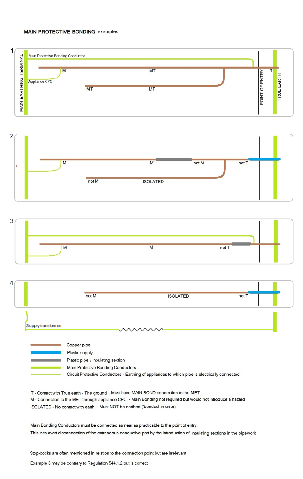

Main bonding diagram (2)
Well, yes, it could matter in some cases. If the insulating section were sufficiently far from the point of entry that not even you would regard it as being 'at' the point of entry, then the regulation would not be wrong, because it would then require the pipe upstream of the insulating section to be bonded 'as near as practicable' to the point of entry - which is what you, I and electrical common senses says should be done.
Well, yes but that just makes it (the reg.) even sillier.
Indeed - and I think we are agreed that when the distance is 'considerable', the reg is, arguably, not just 'wrong' but actually 'ridiculously wrong'/dangerous.
Exactly.
In fact, I've just realised that the situation here is far 'worse' than I have described. The 5-6 metres of pipe (before my meter) within my cellar which would be unbonded if I 'complied with regs' is but the tip of an iceberg. There is a branch from that pipe which travels in copper for 15+ metres along my cellar wall (exposed and easily touchable for most of its length) to supply an adjacent property. All of that would remain unbonded (at least, to my MET) if I 'followed the regulations'.

I don't think that even the infamous regulation ever requires that bonding be applied 'at' the point of entry - only 'a close as practicable', which allows one to take into account practicalities such as you mention.
It does when the meter is external.
Is it touchable at the same time as any equipotential parts?
Well, since I have contravened the regulation, it IS roughly equipotential (with my MET and everything connected to it), since I have bonded it - but if I had complied with the regulation then, yes, it (and unbonded extraneous-c-p) and things that were bonded to my MET would very easily be simultaneously touchable (pipes often run quite close together).
How about the cellar floor, is that damp and at local earth potential? Maybe you need mesh in the floor too!
Yep, and 'wet' rather than 'damp' at times (underfloor drainage pipes, a sump and a pump are kept busy when it rains!) - just (in many cases broken!) quarry tiles laid on top of quarry tiles which are directly on sand/soil. ... so, yes, theoretically it should be 'bonded'! Given that it's a TT installation, I'm a lot less concerned about this than I otherwise might be, since a substantial PD between bonded metal (pipes etc.) and the floor should only arise in the case of an 'L-E' fault within my installation, and that only for as long as it took an RCD to operate.

... and, as you suggested before, in this case it is far from clear whether 'at the point of entry' refers to a point on the external wall or the point where it enters the interior of the building.
I think the bottom line of all this is that any sensible person who does not feel constrained to 'comply with regulations, regardless' would probably simply ignore this entire regulation and simply apply electrical common sense. I suppose that is essentially what I (and quite probably you) actually do do!

The question is quite simple - whether we feel it is appropriate that EFLI should (in the wiki) 'advise' people to do what he (and I, and others), believe to be 'correct', despite that being apparently contrary to the regulations, because we believe that complying with the regulation could, in some situations (like my cellar) be dangerous. In view of what you say (predictably) about my speed limit analogy ....
It is an offence. However ridiculous you find speed limits at a particular time and place, you do not have the right to decide that they don't apply to you, and the police would be perfectly within their rights to prosecute.
... I suspect you will say that EFLI should 'advise' people to comply with the regulation in question, even if he (and I, and others) believes that to comply could, in some cases, create a danger.
Kind Regards, John
I don't think the analogy appropriate.
A more accurate one would be driving past the school at 20mph even though the speed limit was actually 30mph.
I.e. thinking - knowing - the regulation is wrong and dangerous.
