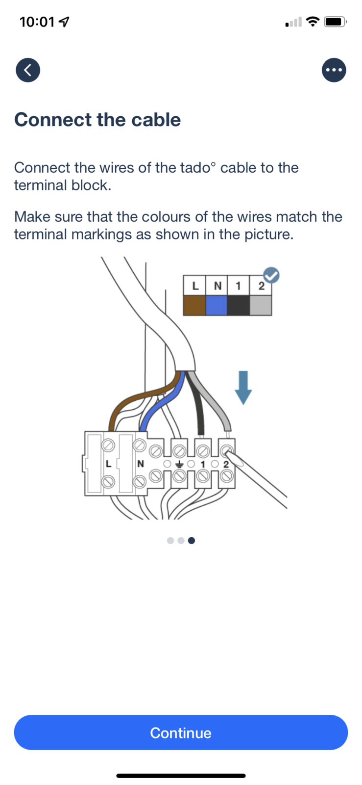

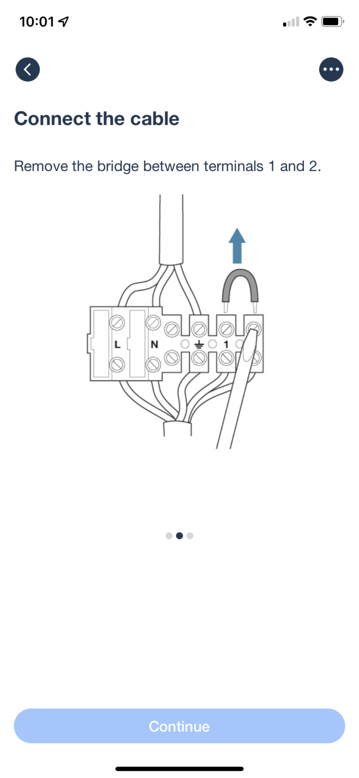

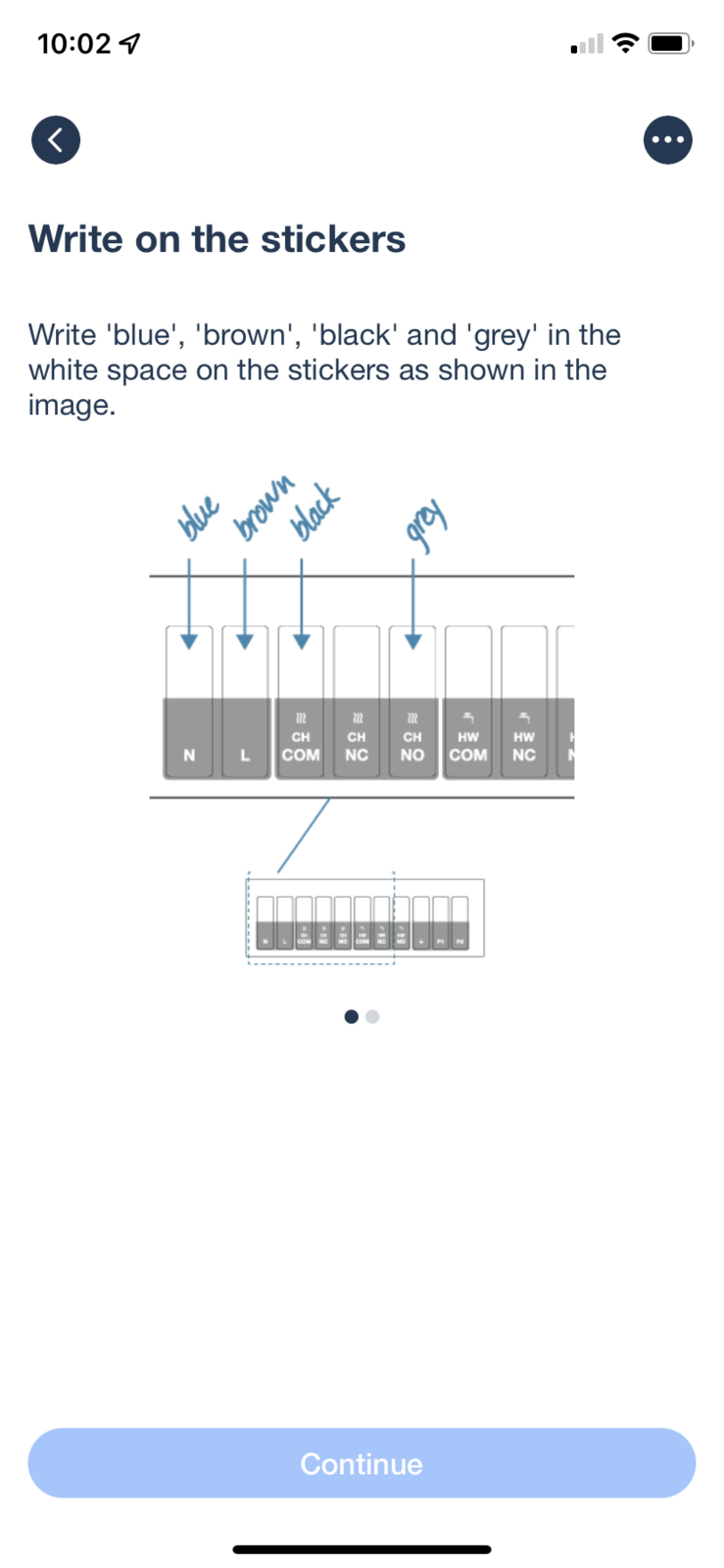

I traced the Salus back in the pcb and unplugged it then wired in the tado as said above. The tado was working and the testing of the relay to call for heat was working, you could hear it clicking on and off. Only problem was that the boiler was not coming on to heat the water. Lights had come on to show the tado was asking for heat but no LEDS lit up on the boiler and not hot rads.
I looked through the tado app and there is actually instructions for my type of boiler……oops!! I wired it how they said as it was different to what was said on here but still not working.
Any ideas would be great. I have attached the way they said to wire too.
Tom
I'm sorry if this sounds awful, but I'm afraid the questions you have been asking aren't filling me with confidence that you understand what is going on!
Basically, all the suggestions we have made for wiring so far, will do exactly the same task.
The wiring from the Tado app is exactly the same as that suggested first off by @ianmcd
The suggestion I made, was based on the boiler manufacturer's recommendations, due to protection by an extra fuse - but it will work in exactly the same way.
The only extra factor is the removal of the Salus, hence:
and I have no idea of what logic could be going on on the PCB (others may though!) - just disconnecting the Salus may, or may not work. There may be a need for an extra bridge somewhere.
Without investigating the PCB, you could bridge terminals 3 and 4 of the Salus, and see if the Tado works?
Did you try bridging terminals 3 and 4 of the Salus?
...I'm afraid it may be time to book in an appointment with a Pro :)
Put everything back the way it was, the 4 wires connected to the Salus receiver, connect L&N to L&N on the Tado, the other two wires go to CH COM & CH NO, on the Tado, either way round doesnt matter, make sure the yellow link for the thermostat is back in place , the salus will do nothing now except fill the hole on the facia
