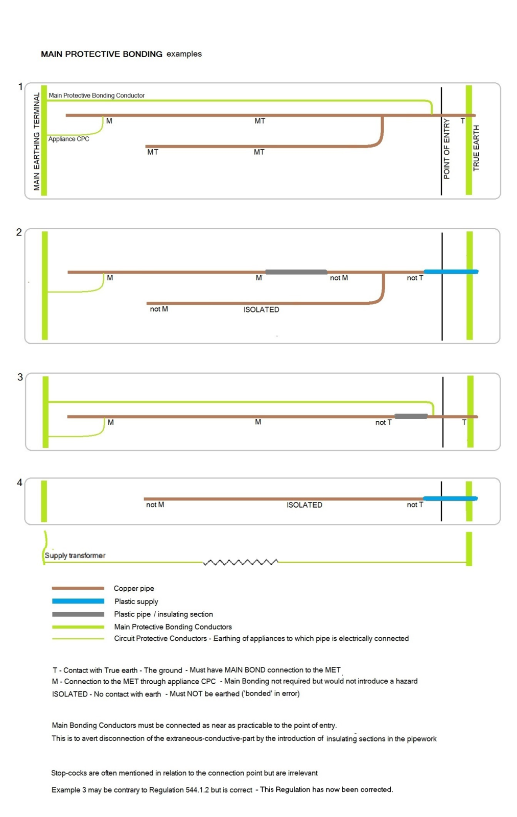

Main water bonding question
Supposing a live conductor made contact with that internal copper piping? The only path to earth would be via the water in that section of plastic pipe.

What purpose does bonding a section of metal pipe serve, where the metal pipe disappears into the ground and is electrically completely isolated from an extensive metal pipe installation within a premises? Answer = none.

Water pipes themselves are not exposed-conductive-parts therefore do not require earthing.
If they are connected to earthed appliances then they will be earthed by the appliance but it would be better if they were not.
Because they are earthed by an appliance they might require supplementary bonding in, for example, a bathroom.
This has nothing to do with Main Bonding which applies to extraneous-c-ps entering the premises.
It stops external voltages from being brought in to the house.
You will note that your linked article refers to extraneous-conductive-parts. That is the pipe in the ground earthed by the ground - The Earth - not the other pipe(s).
Isolated metal parts are not extraneous-c-ps and must not be bonded.
Only parts that are already earthed by some means need bonding to equalise any potential should a fault occur.
