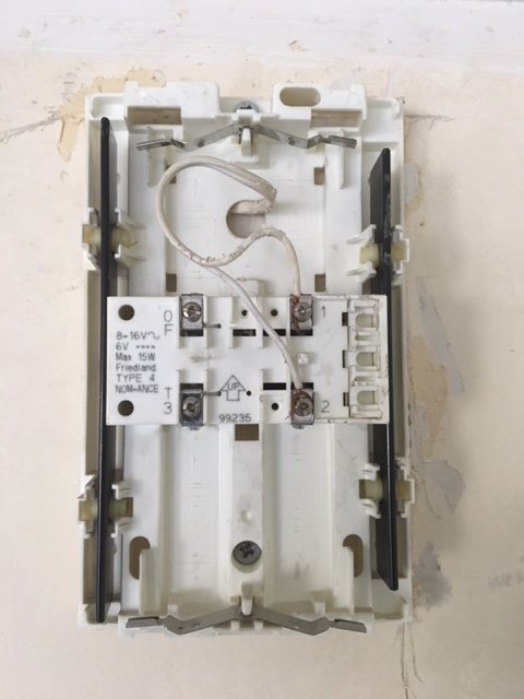

hi Everyone,
i moved into a new house and renovating. there is an old mains electrics door bell( please see picture) that i want to remove completely. it doesn't work and we already have a a wireless replacement.
my question is- is it safe to just cut the white wires and tie the ends with electric tape and push it back into the hole in wall, seal the hole and paint over?
am not sure if there is a transformer somewhere but i don't intend to use the mains wired door bell ever again but i also don't want to just push the cable into the wall if its dangerous.
am illiterate with electrics so please advise in plain English.
thank you

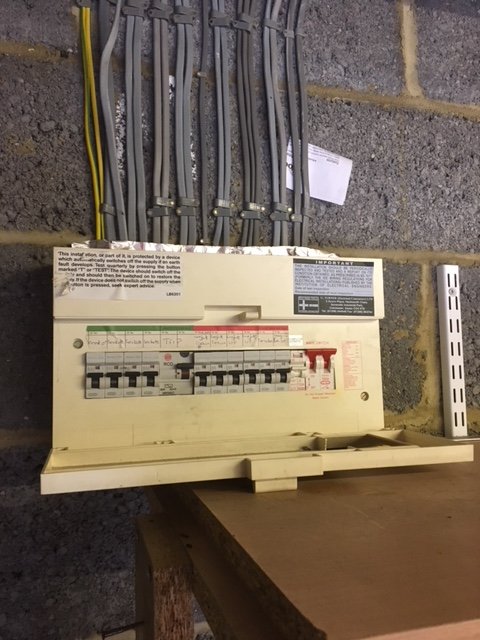

Please take a couple of photos of the consumer unit, and boxes near it, we may be able to guide you so you can disconnect.
Look for something like this
thanks . i just checked and i cant find any such box around the consumer Unit or in the garage. i have attached a pic. unless its hidden in the first floor?thank you
I just looked at the picture.
What makes you think it is mains powered?
When did it last work?
i only moved in 2 months ago and it doesnt work as previous owner had a wireless one already in place.
only reason i say its main is because of the 2 white wires i see in there. i suspect it goes in to the wall . i guess i can take the plate off to see if the wires actually goes in to the wall. you might be right, u know. i will check. many thanks

just checked with the decorator.checked both cables with tester and there is no power to the cable. in fact i held on to both cables. no power. so we will cut it as close as possible to the wall and push it in and seal the hole. thanks
yes diyer56, thanks for the diagram. from that it looks like it was battery powered. i agree. cables will be to the push bottom. many thanks to All for the replies. appreciated
What range did you set your “tester”?
You’ll be looking for 8v ish AC. can your tester detect that?
Don’t forget you won’t get voltage unless you press the bell button.
If there’s no voltage, You can test if the wires just go to the button, by selecting the ohms range and seeing if you get continuity when the button is pressed.
