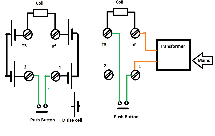

Mains Door Bell
Going by the fact that the wires are connected to terminals 1 and 2 with no wires connected to T3 and OF then it was battery powered.
The ends of the solenoid coil that operates the Ding Dong are connected to T3 and OF which are also connected to battery terminals
