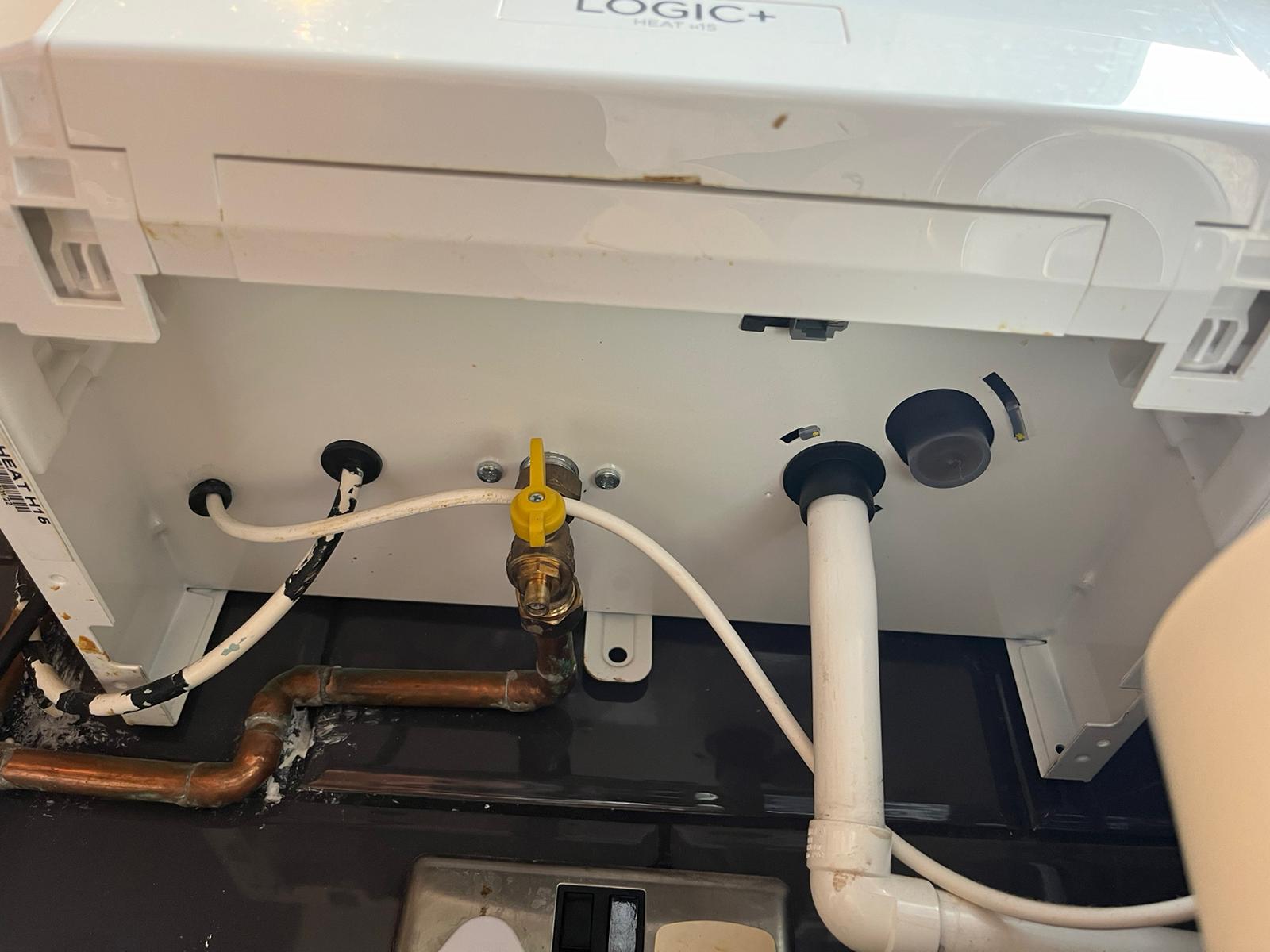

Hi all, my daughter has just moved into her new house. She has an Ideal Logic plus 15 boiler that was installed two years ago.

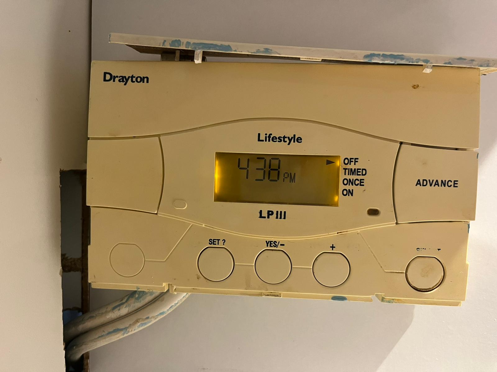

Attached to this is a Drayton Lifestyle controller that's for the hit water only.
She has central heating through the house, however there is no thermostat but all the radiators have thermostat valves in them.

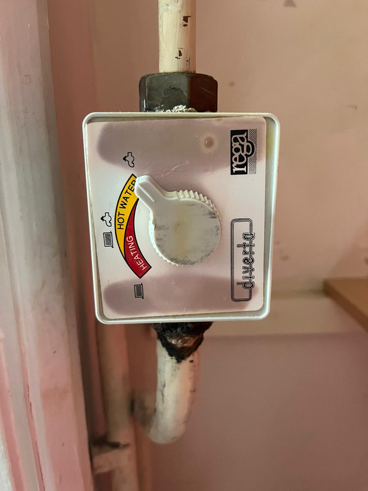

To select the heating/water/both there is a manual 3 port diverter valve in the airing cupboard. Hopefully if I can attach photos it will make more sense.
Anyway to select heating/ water or both she has to go upstairs and turn the selector switch to whichever position she needs.
This seems totally stupid and inefficient.
If I was to buy a hive system and a motorised 3 port valve will this solve this weird setup?
Will the wiring from the boiler just be a straight swap to the hive back plate as there are two wires going into the current controller even though it only turns on the water and the manual diverter chooses what happens with it
Thanks in advance

Not as simple as just adding a HIVE and 3 port I'm afraid.
Firstly - looking at the manual valve that's there, all that is doing is opening up the flow to the HW cylinder or the CH or increments of both. Ideally you don't want the system to become a Y plan, which adding a 3 port MID valve and HIVE would essentially do.
It also needs understood if the HW cylinder has a cylinder stat and presumably the CH is just relying on it's internal stat to control the boiler at the moment.
Really the system needs looked over by an experienced pro and an interlocked system designed and implemented. If the boiler was only installed 2 years ago then whoever did the job didn't do it properly. They haven't followed any standards whatsoever and lucky if the boiler manufacturer would honour the warranty, is there a mag filter installed?
Majority of not all wiring should be accessible via the wiring centre in the cylinder cupboard. Ideally upgrade to an S-plan (x2 motorised valves) and wiring alterations, so I’m answer to most of your questions, No. Unless you’ve done this stuff before, then as per @Madrab, get a professional in, or perhaps query why it wasn’t done to current standards at the time?

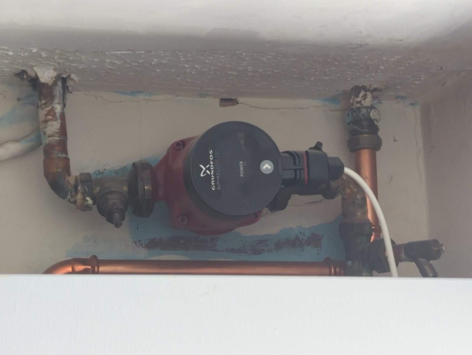

I just found this pump over the boiler too

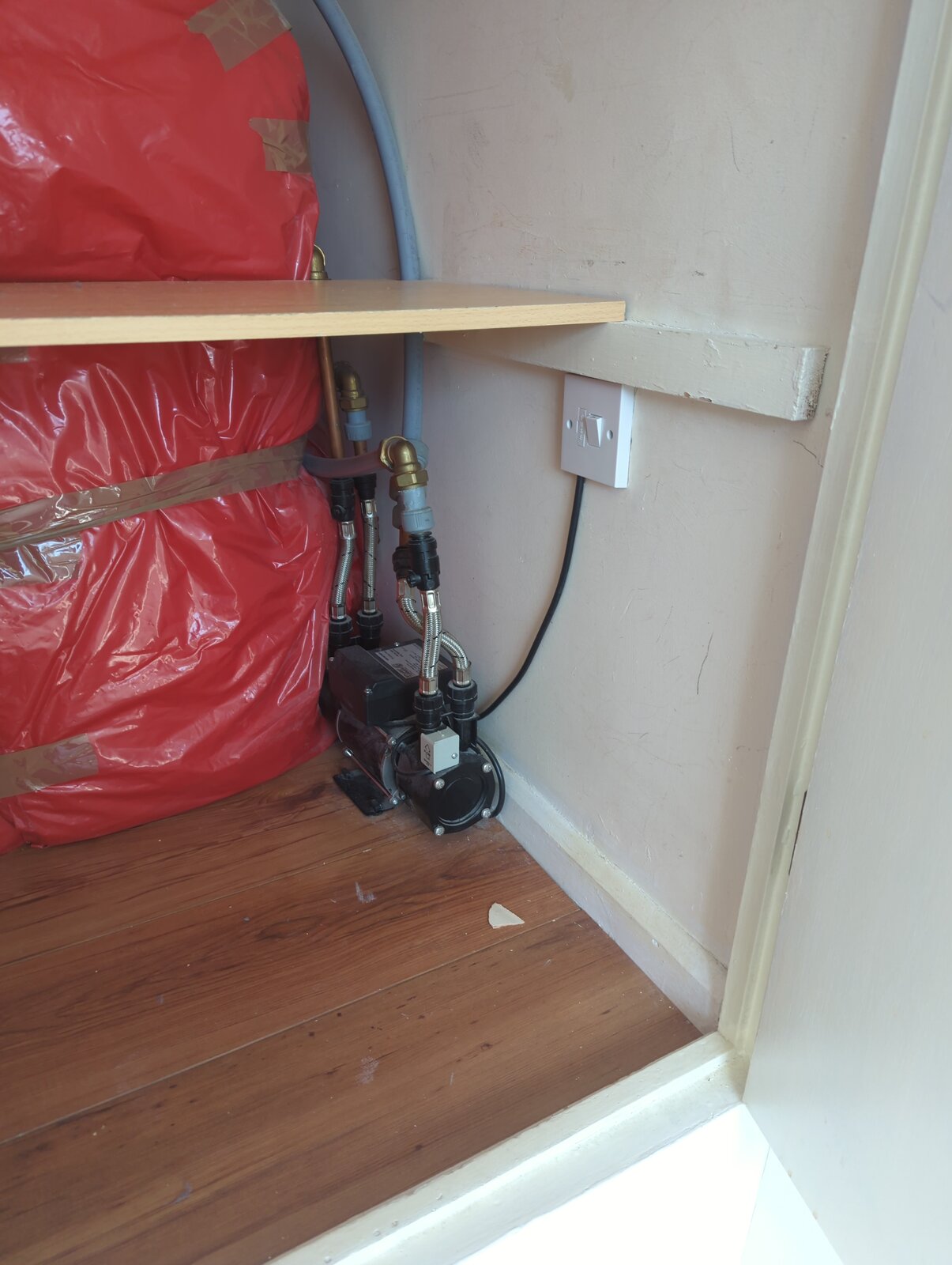

There is no wiring in the airing cupboard at all except for a pump to increase the water pressure to the shower
Thanks Anxious
In which case, it would need a big upgrade.
