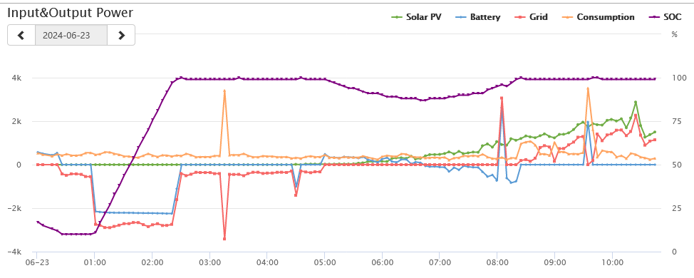

I agree with @flameport I get a graph showing what power I have used, One can see the spikes when I made coffee 1719136214916.png and having viewed the data over months, the only time we tend to exceed the supply from solar panels and battery is when having a shower. Once the sun is shinning the 3kW from battery, and the 1 to 4 kW from solar panels is enough to cover all power requirements. So in the main I do not use over 7 kW = 30.5 A, so one would be very unlucky to cause an overload, and if you did, the worse case is the MCB trips.

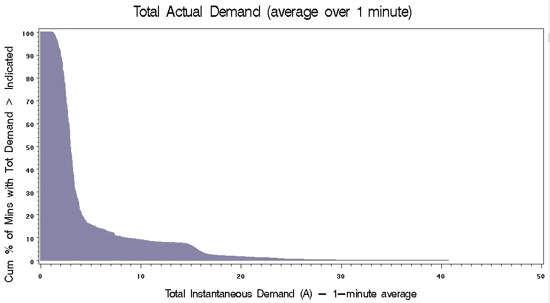

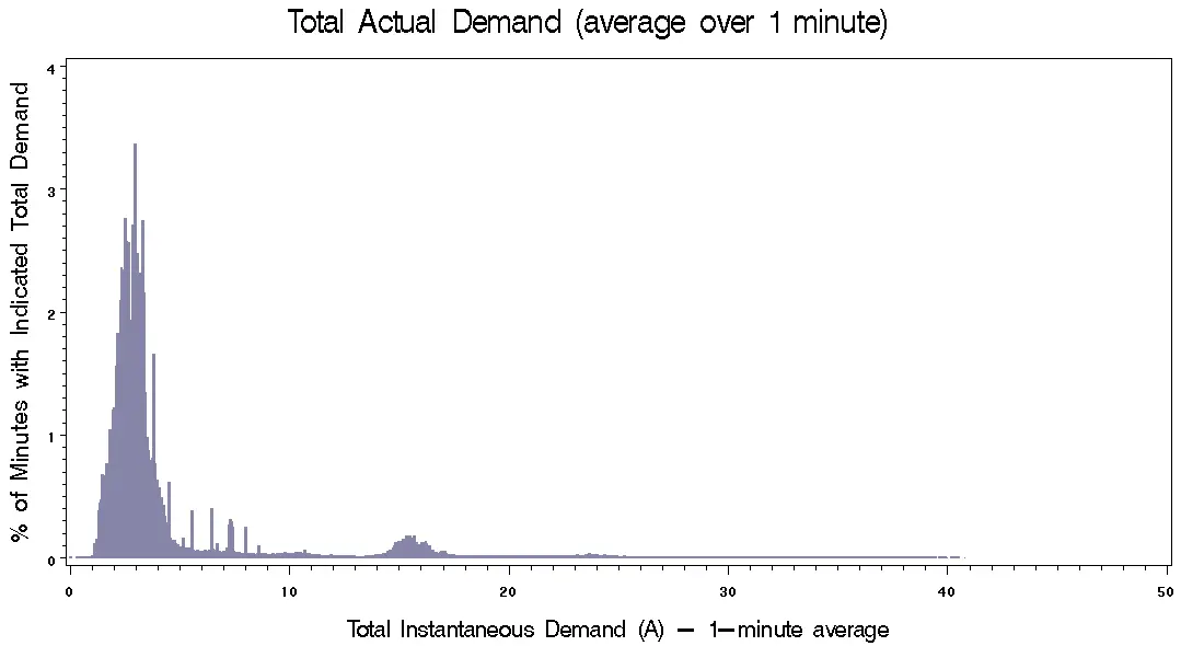

The first graph below shows the distribution of the instantaneous (1 minute) total demand, indicating that for the vast majority of periods the total demand is under about 5A. The small peak around 15-16A relates to periods when the 3kW immersion is the main load.

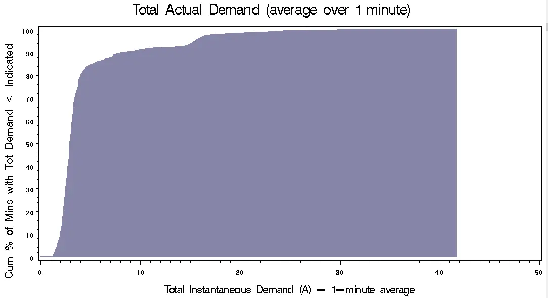

The second graph shows the same data, but in terms of cumulative figures, indicating that some 80% of all minutes have a demand below about 4A, about 92% of all minutes have a demand below about 14A and about 98% of all minutes have a demand below about 20A.

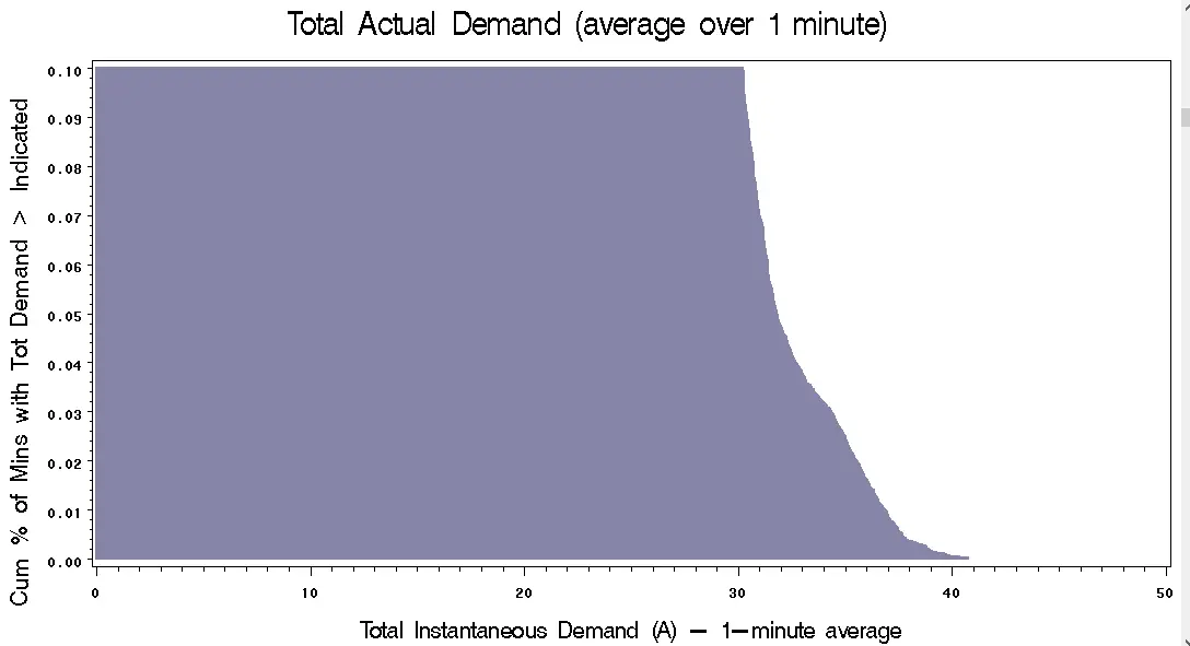

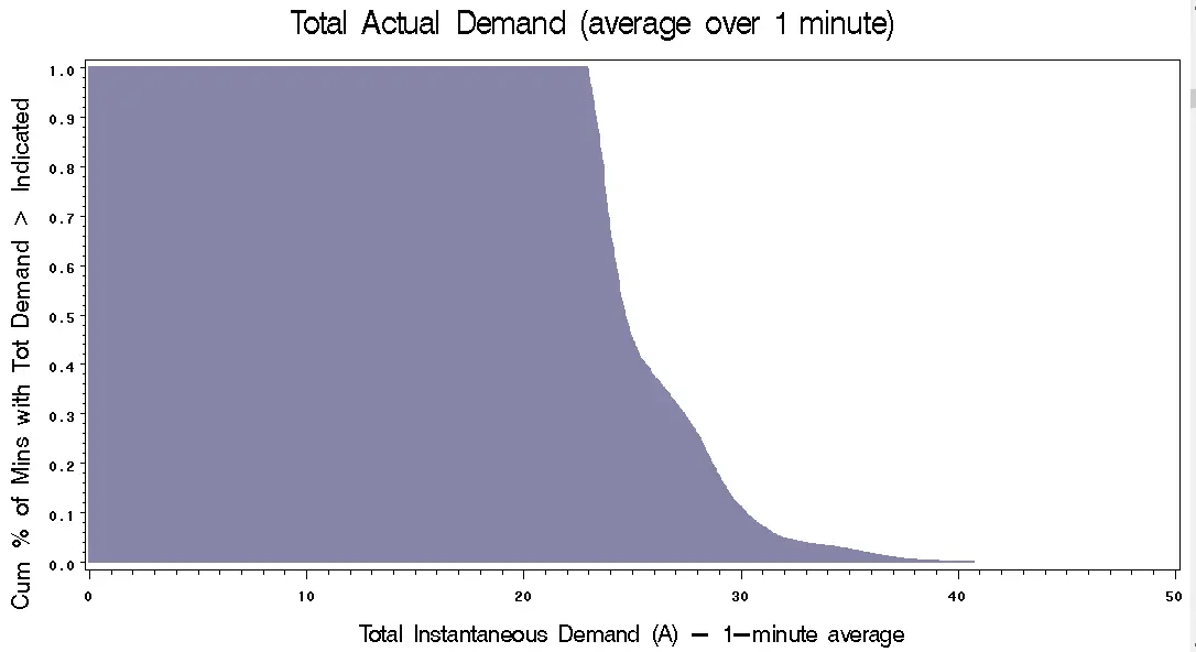

The final three graphs are ‘inverted’ versions of the second, the final two being ‘magnified versions’ which show what happens at the extreme tail (moments of highest demand). These show that only about 1% of minutes have a total demand >24A, and only about 0.01% of minutes (about 1 minute every week) have a demand >32A.
Over all the ~1.35 million minutes observed, the mean total demand was 4.35A and the median 2.97A. The lowest demand was 0.35A and the highest 40.36A. Summarising the number/percentage of minutes with total demands above a certain figure. As can be seen, under 2% of minutes had total demands >20A, and almost none had total demands above 30A. For about half of all minutes, total demand was under 3A.
