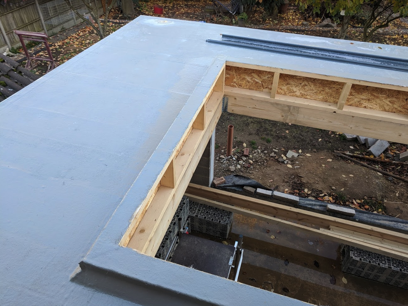

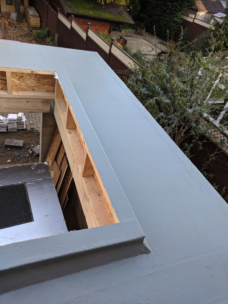

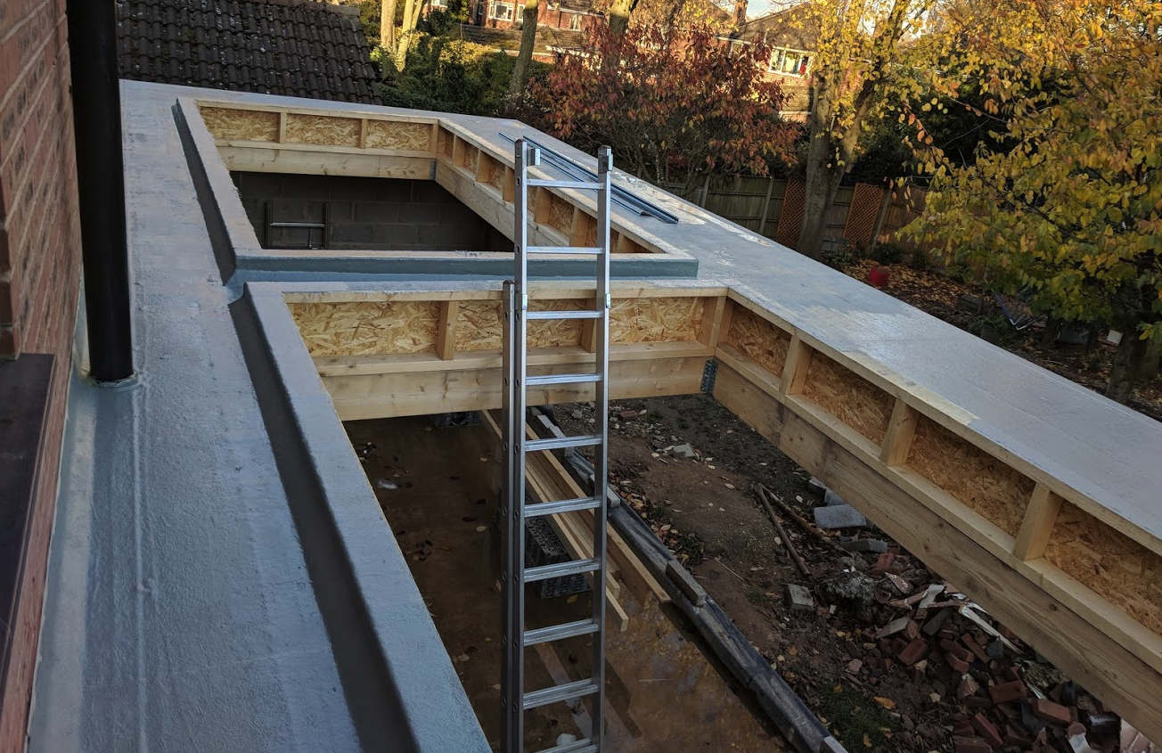

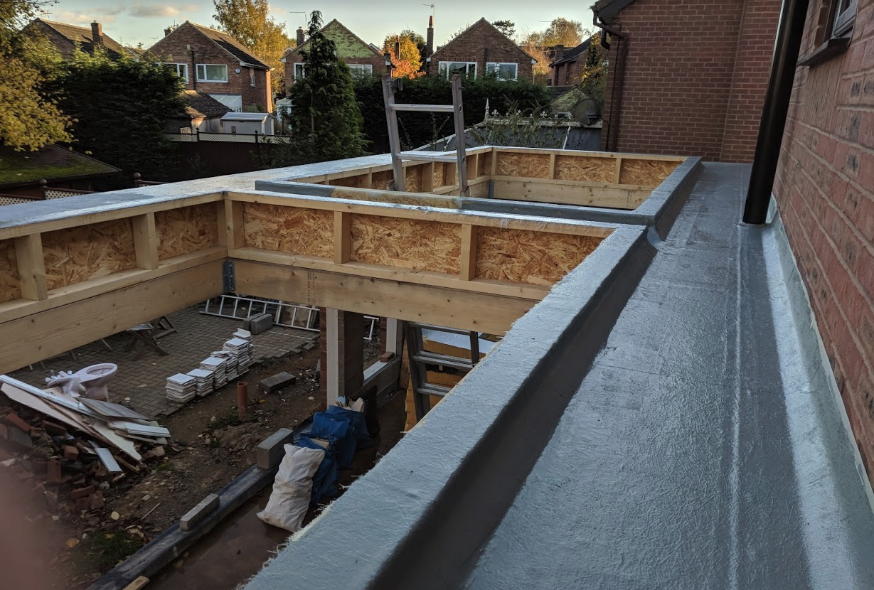

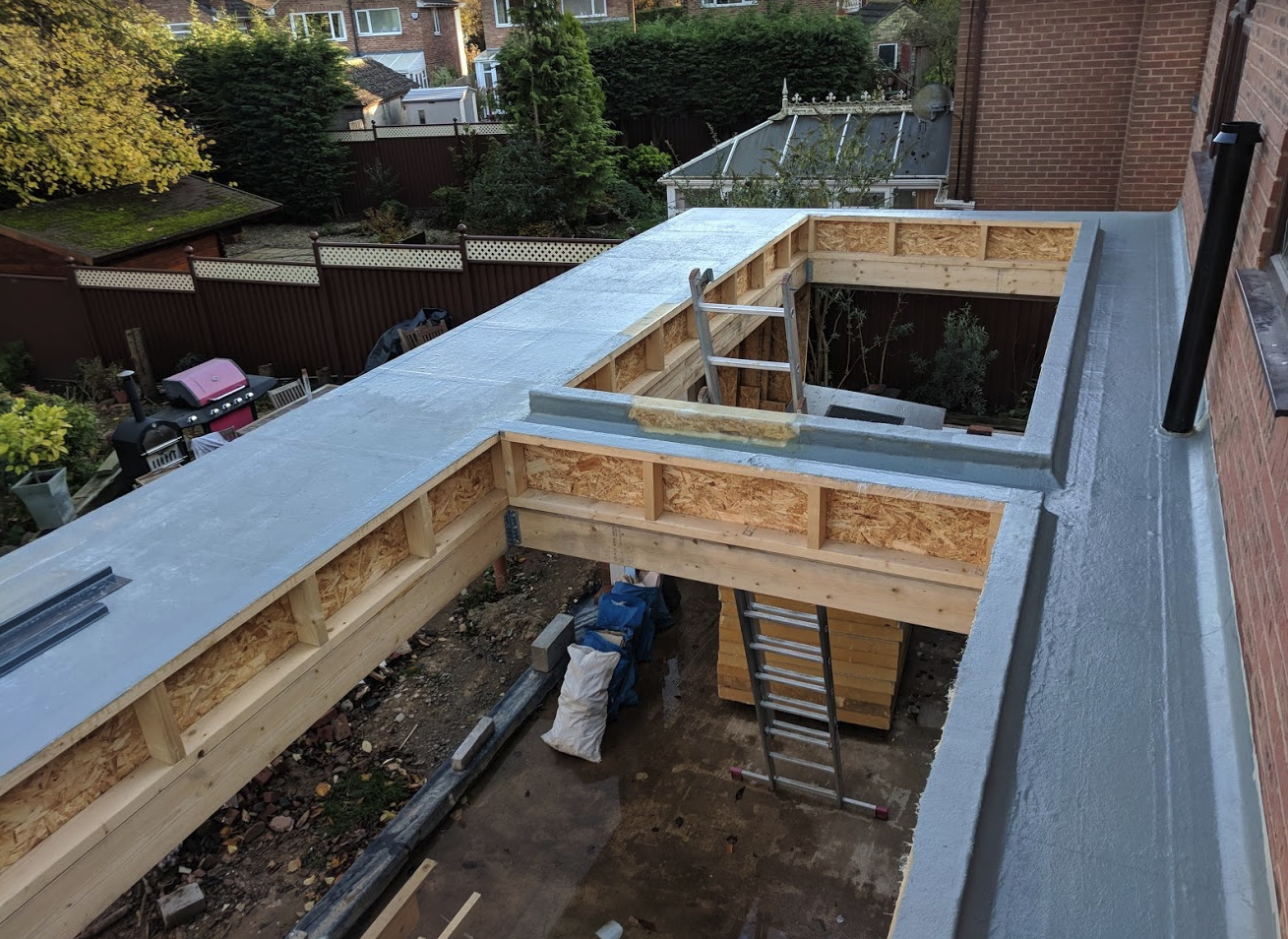

Roof is now 99% done. Pain to try and fit in a couple of dry days! I never want to mix a batch of resin again.

What is that stuff you used on your roof ?
When I get to roof stage I was thinking of the fibre glass stuff

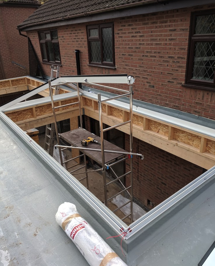

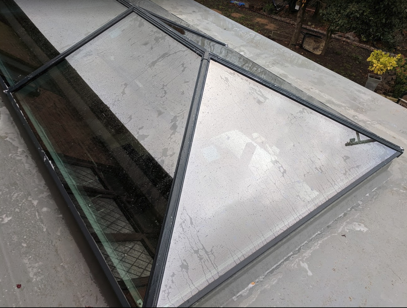

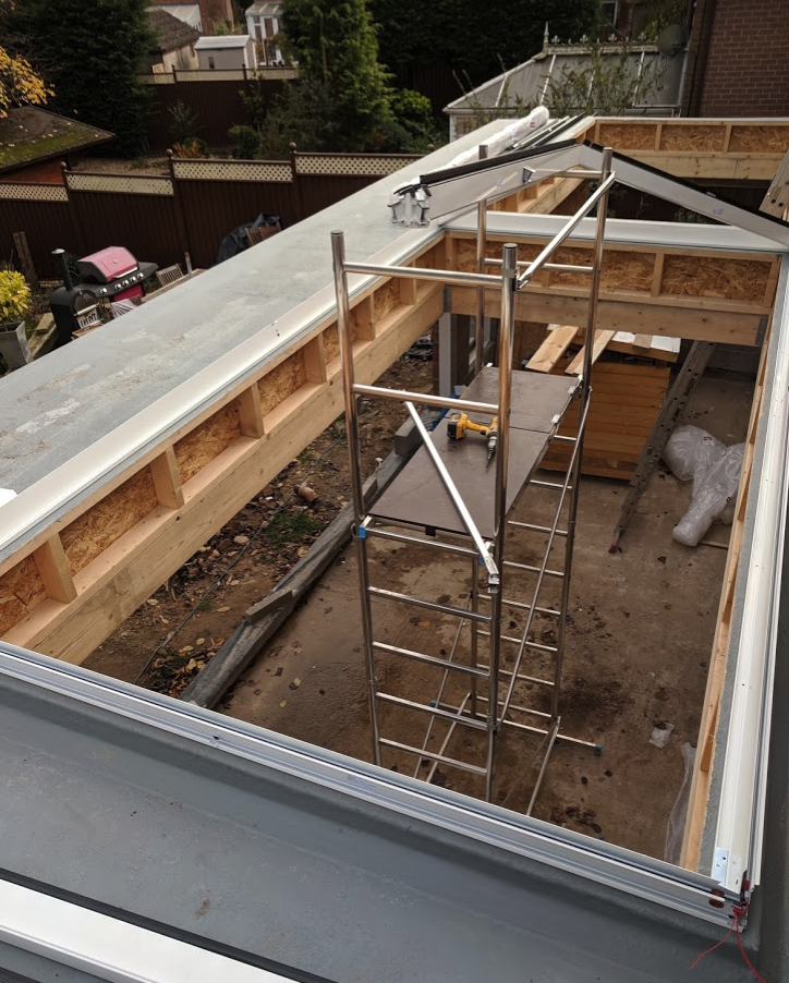

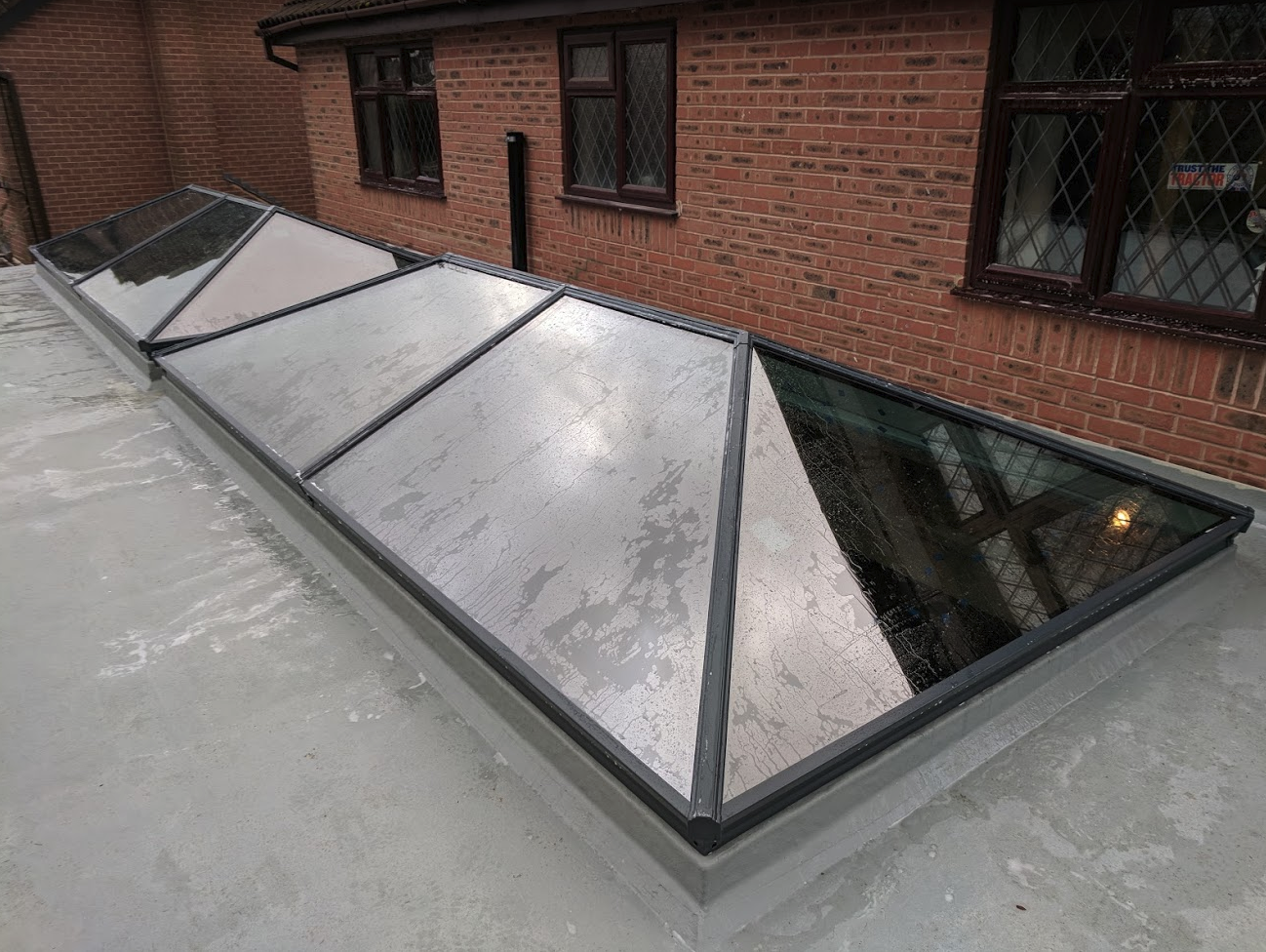

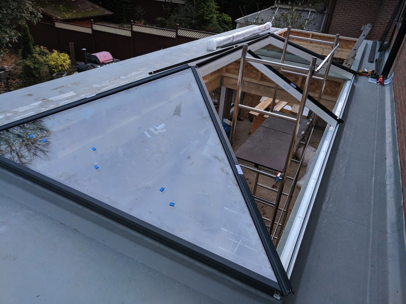

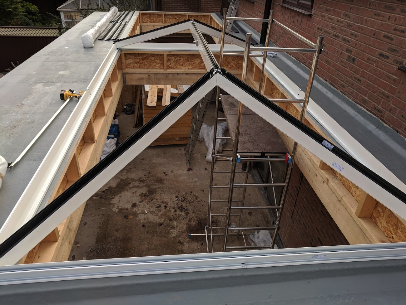

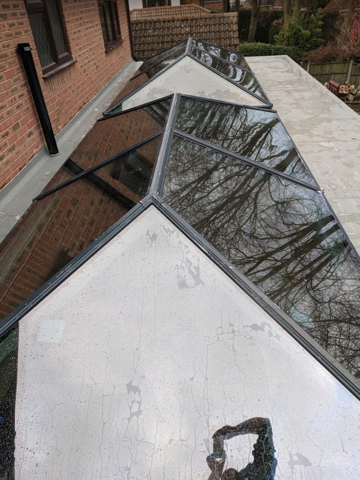

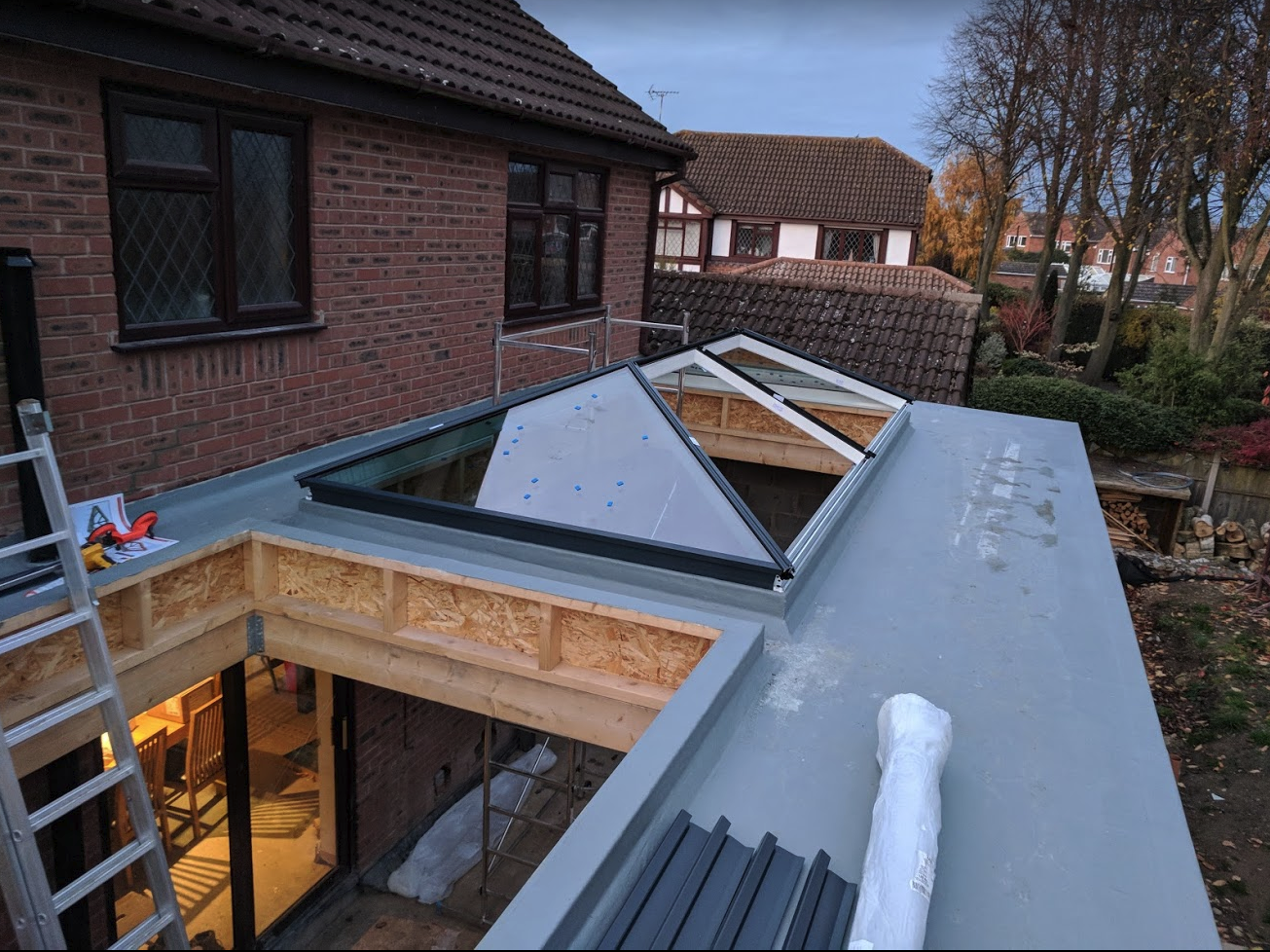

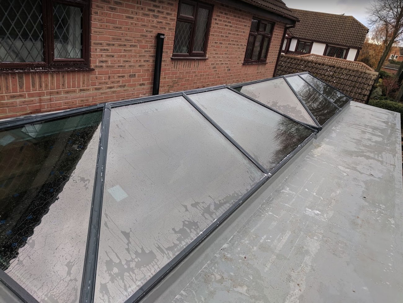

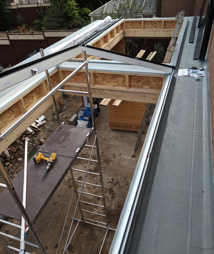

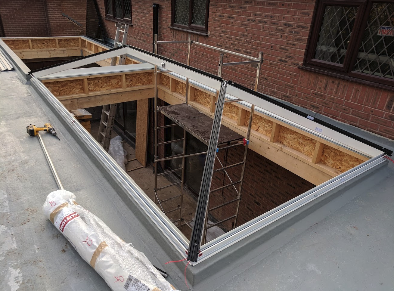

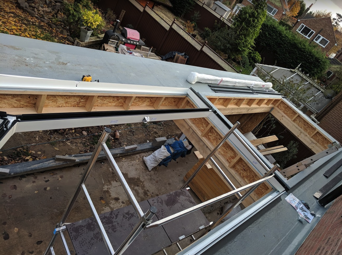

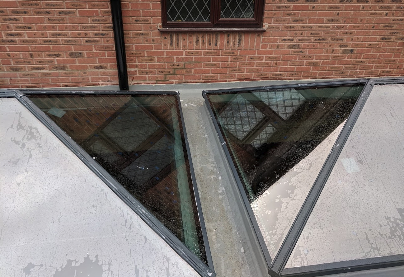

Roof Lanterns finally in.
Guttering and the flashing for where the extension joins the house and the roof will be complete.
GRP/Fibreglass. A pain due to the up stands for the Lanterns. Although I think any roofing sytem would have been a pain with them. So far so good, but with any flat roof system only time will tell.

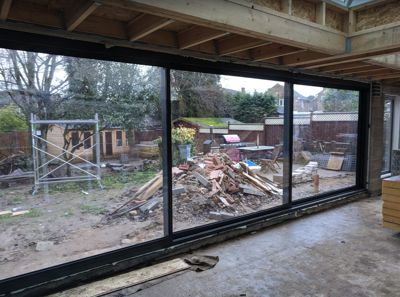

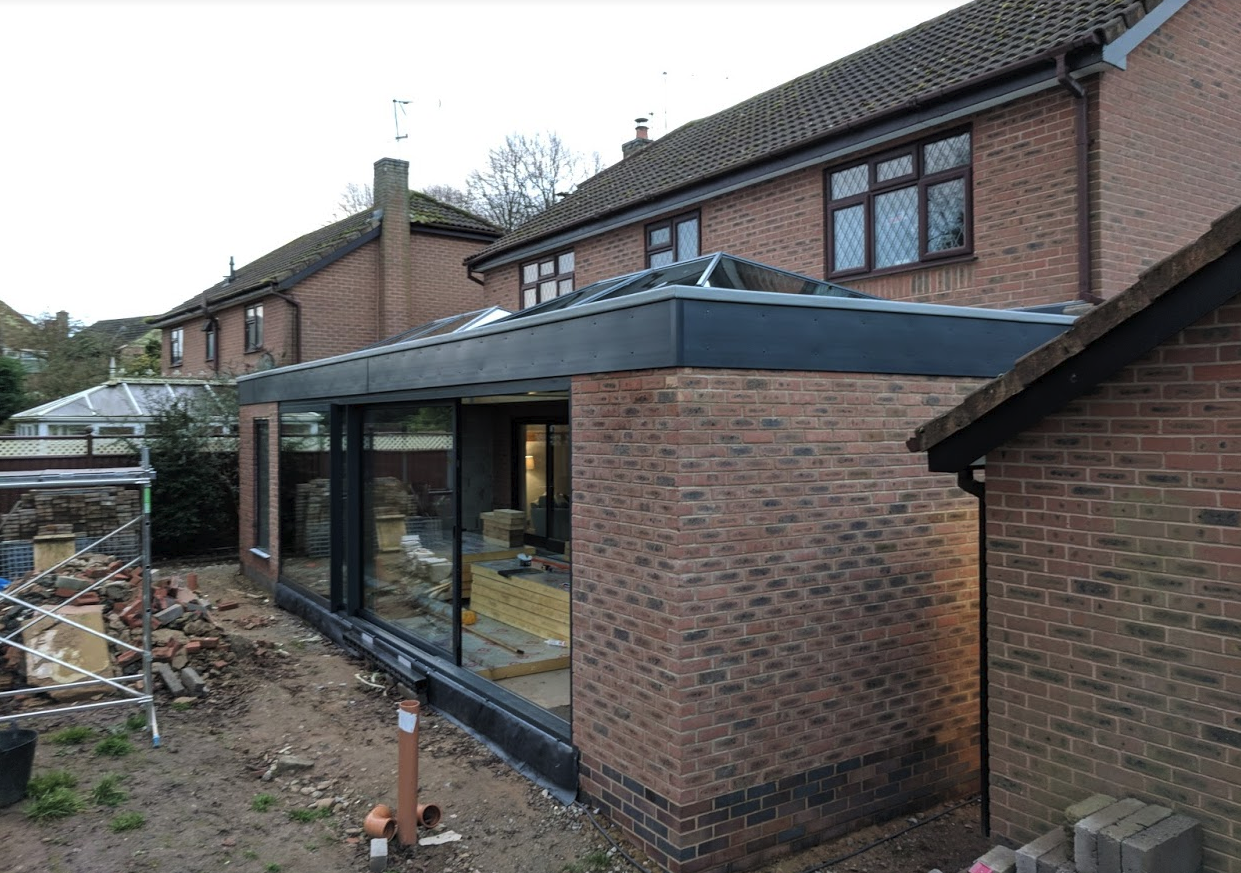

Rear doors are in! 1 side window to install and I think I'm water tight............. Wasn't going anywhere near these. supplied and FITTED!
Looks really good -the end is in sight!!
What overall dimensions is the extension? I can’t see it on the thread but may have missed it?
Looks similar to ours which is not as far on as yours. Our is something like 4m x 8.5m and will have three sliding glass doors on it so not too dissimilar.
Looks excellent!, bet it's nice to be weather tight at last.

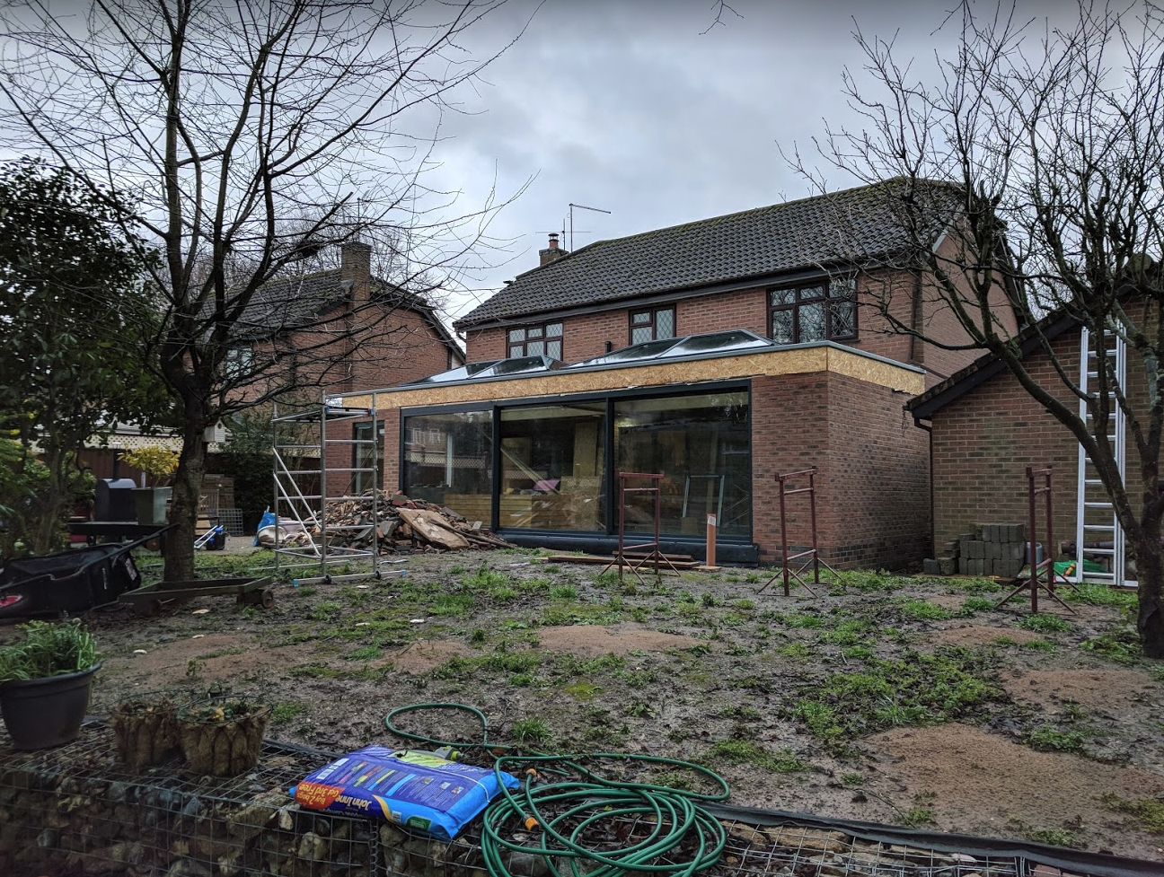

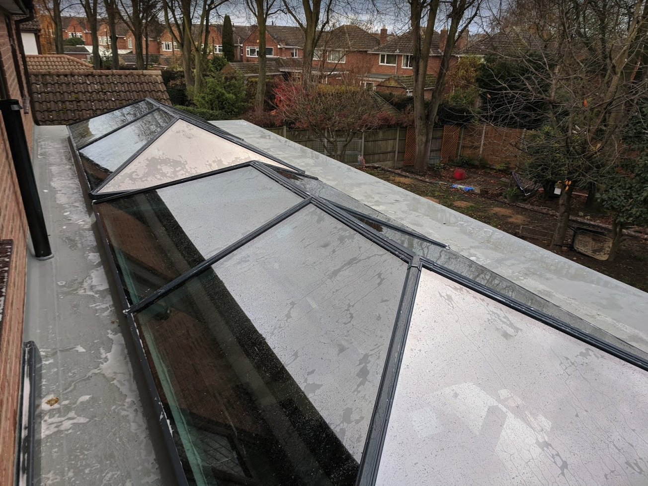

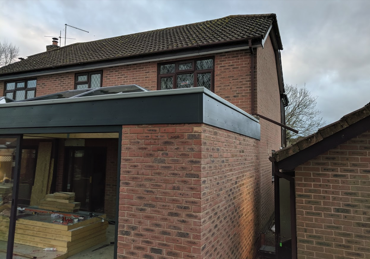

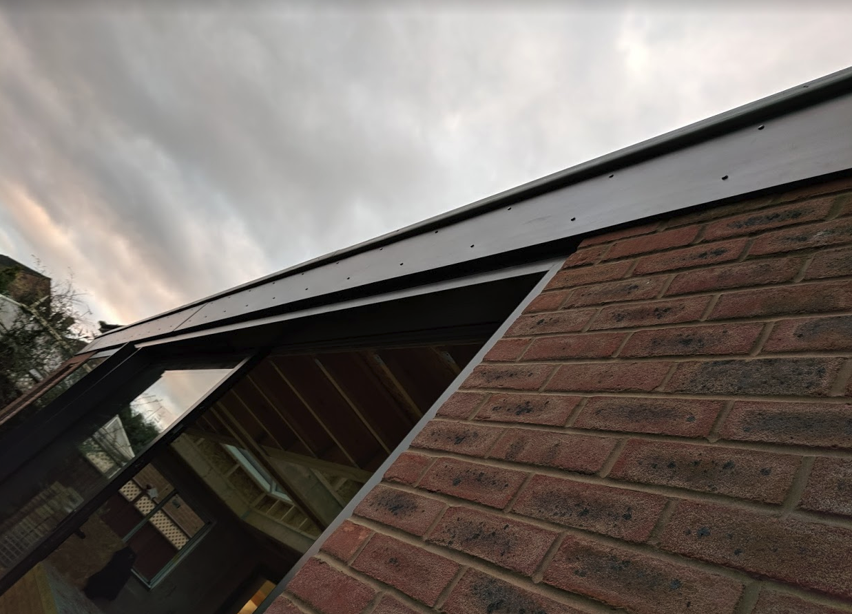

Finally got round to putting the fascia up after being lazy over Christmas. Roof has been signed off by building control. Next visit is completion.
