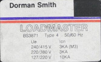

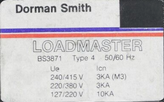

The old LoadMaster MCB by Dorman Smith
looked very like the isolator

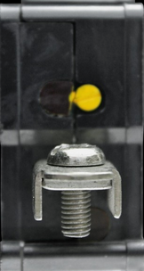

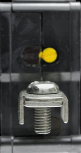

the MCB went up to 70 amp version, and my charge hand in Sizewell was fitting isolators thinking they were a 100 amp version. He was quite put out when his error was pointed out. Today, Isolators and MCB's look very different. Some were marked 1745322200838.png this one type 4, but many no marking as to type. And on the caravan site I was stopping at, someone worked out by screwing in the yellow screw, 1745322385364.png they would trip at a higher current, we had 6 amp supplies as the whole supply to the site was 100 amp split phase, and this resulted in the standard kettle not working, I remember talking to the site owner, and he would go around with a 2 kW heater and see if they would trip, if not change them.
I think that is the only time I have seem MCB's tested. But as a result of what happened on that site, I would never buy second hand MCB's.
