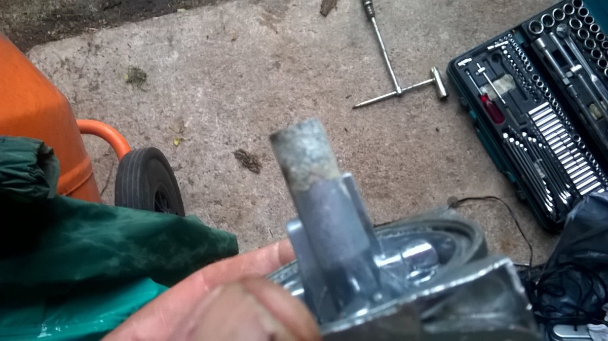

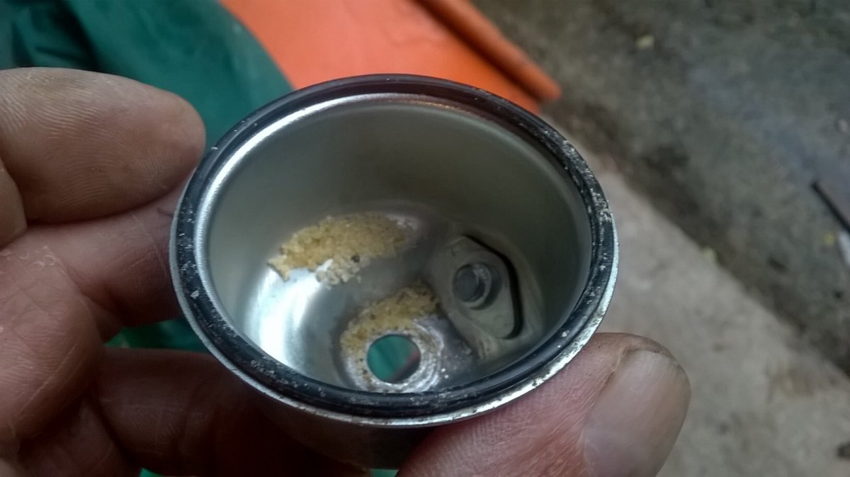

I have had several cases of lean seize from using old fuel which is why I asked if you had checked the piston through the exhaust port.
Ethanol is hygroscopic and if left too long in the carb will do more damage than in the pics.
If you are feeling flush and want to avoid the problems with ethanol you could always use Aspen.

^Thanks! I hadn't even thought about the ethanol until I started wondering what was different.
I don't think it seized (luckily!) it'd just basically drop back to tickover. It's running as sweet as a nut now.

I wonder if this time it's our "old" friend ethanol. Here's my theory. Ethanol had evaporated, leaving 10% less fuel thus making the oil mix more than it should be. Hence causing the engine to run weak until it overheated and stopped due to fuel vaporisation.
