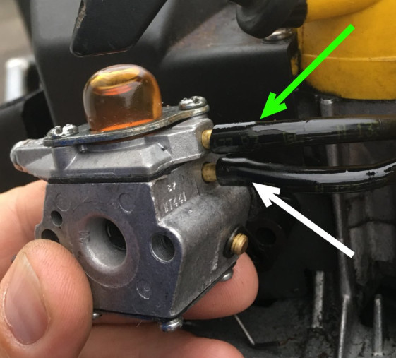

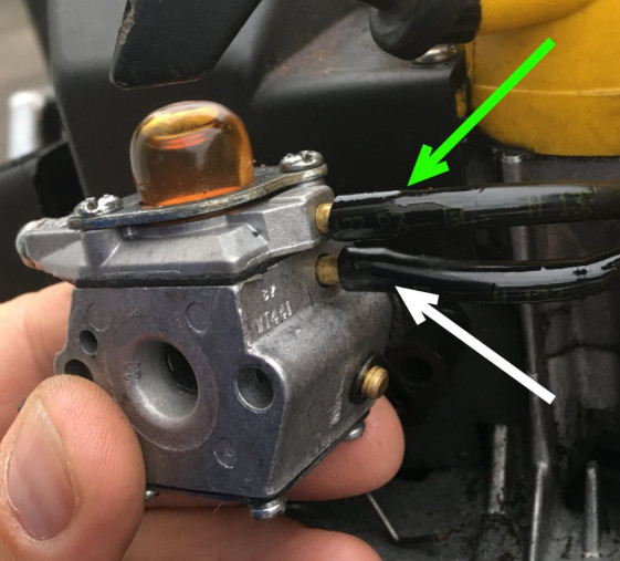

Just something to add to this.
In one of my first posts i added this photo.
I mentioned that the top green arrowed pipe enters the tank & has a filter on it.
The white arrowed hose enters the tank & thats it.
Ive put mine back the other way around so now im doubting myself ???
With some fuel in the carb & both hoses off when i press the primer bulb i get fuel coming out of the top metal pipe.
This is why i thought it was a return
Sorry, I threw you bum info on this and the way you now have them is correct.
