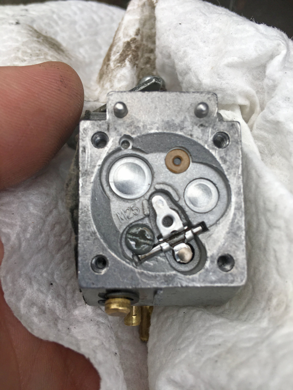

Last night stripped down carb again & fitted a kit,i used the old needle vale,spring etc as the new one didnt seem to do anything when you operated it like a sea saw in your hand.
I put the carb back on and this morning i was able to pull the cord say twice & it started,ok rough but it run.
It then died & nothing at all.
When i did manage to get it to run again i was able to start it 8 times in a row & each time seemed to run / tickover on its own poorly,but as soon as i tried to rev it the item died,but was able to start it straight away after.This was with choke on & throttle lever tapped open.
Exhaust back on again & nothing so i was going to the shed but i felt something on my leg,i looked down & fuel was running out of the exhaust.
Whilst it was poorly running i did up the fuel cap and in no time it stalled.
I unscrewed it again & started ok, screw it on & engine stalled.
Exhaust was set on fire yesterday for a good few minutes.
So now exhaust is off & just allowing the fuel to evapoarte.
At this point i tried to pull the cord but it seemed like hydraulic lock.
Turning the item on its side no kidding the fuel run out of the exhaust manifold,the n pulled the cord to get the rest out via plug hole / exhaust manidolf.
Just started to rain.
So why would there be so much fuel in the cyclinder if the H & L screws are only turned out once.
Did i do something wrong i fitted the kit.
If i did then maybe good as its never started / run like this at all but the fuel situation was like having a tap on.
Should i remove the carb again as show photos of how ive put it back together & which gasket was used etc.
You might see something wrong but i dont see how so much fuel can get in the cylinder if theres only a slight squirt when rpulling the cord etc & in such little time.

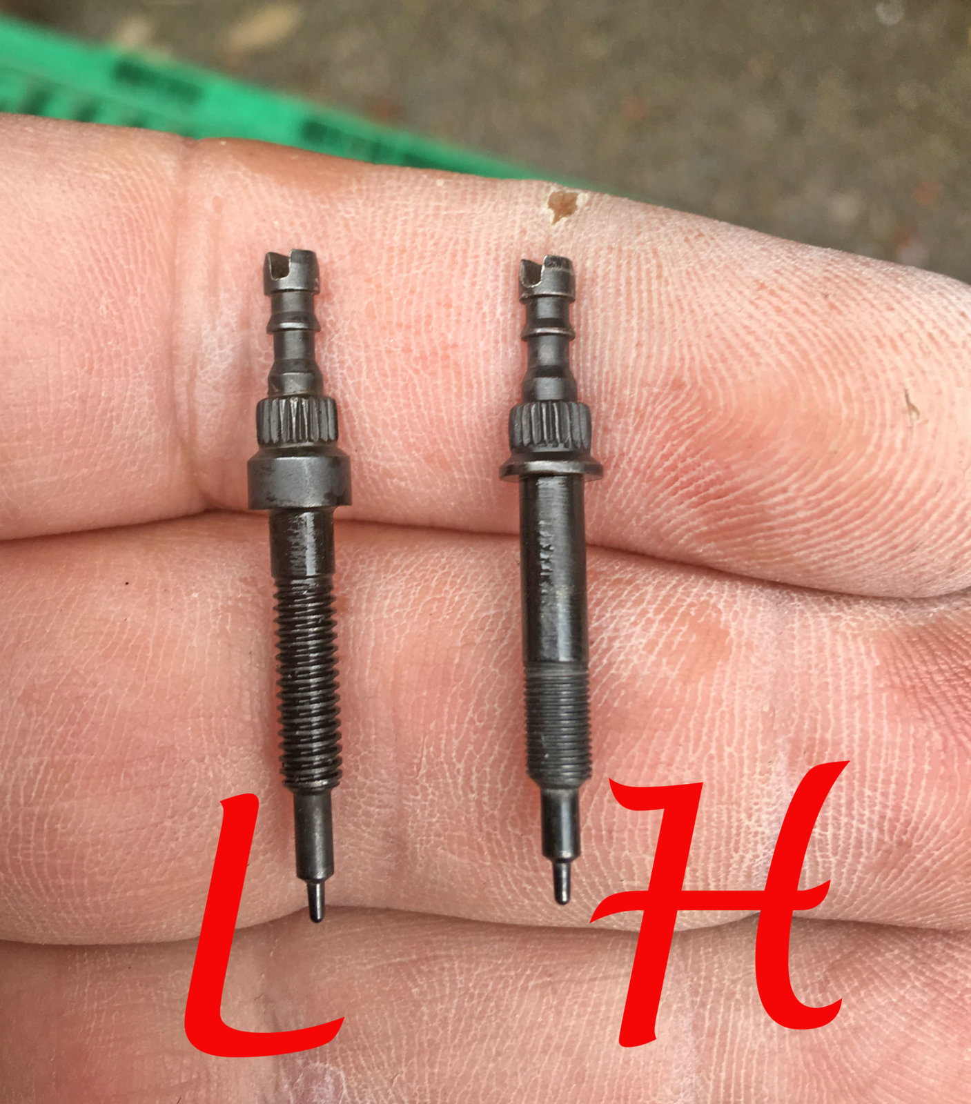

You didn't get the two screws mixed up, I hope? One turn out is usually about right.
It is possible for the needle valve to pass fuel and to check this I pressurise the carb with air, and heed the pressure needed to lift it off its seat. Difficult without the proper gear!
When it does start, remove the choke immediately .
John :)

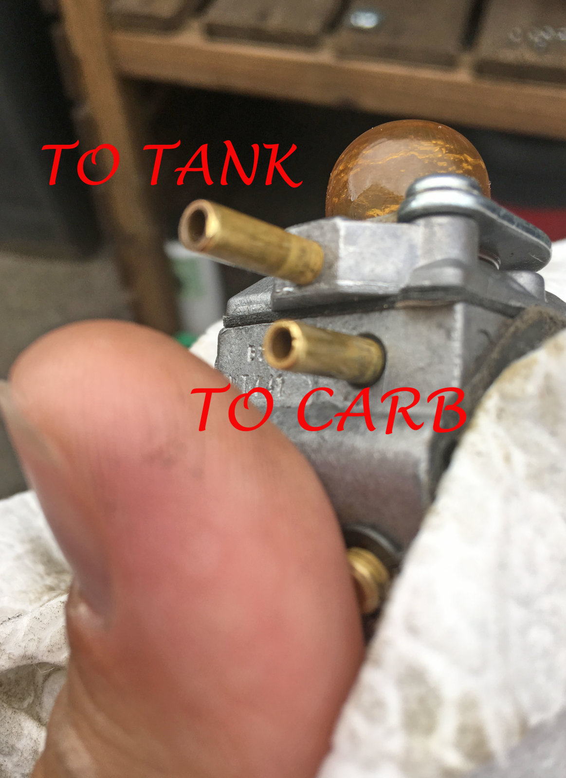

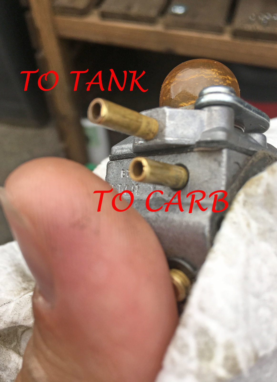

I thought i had the fuel pipes on the wrong & noticed one is clear & the other is black.
The black pipe has the filter on it & is connected to the lower metal pipe.
The clear pipe fits the connection which is part of the primer bulb plate.
With both rubber pipes removed & the primer bulb operated fuel/bubbles come out of the connection to which goes back into the tank.

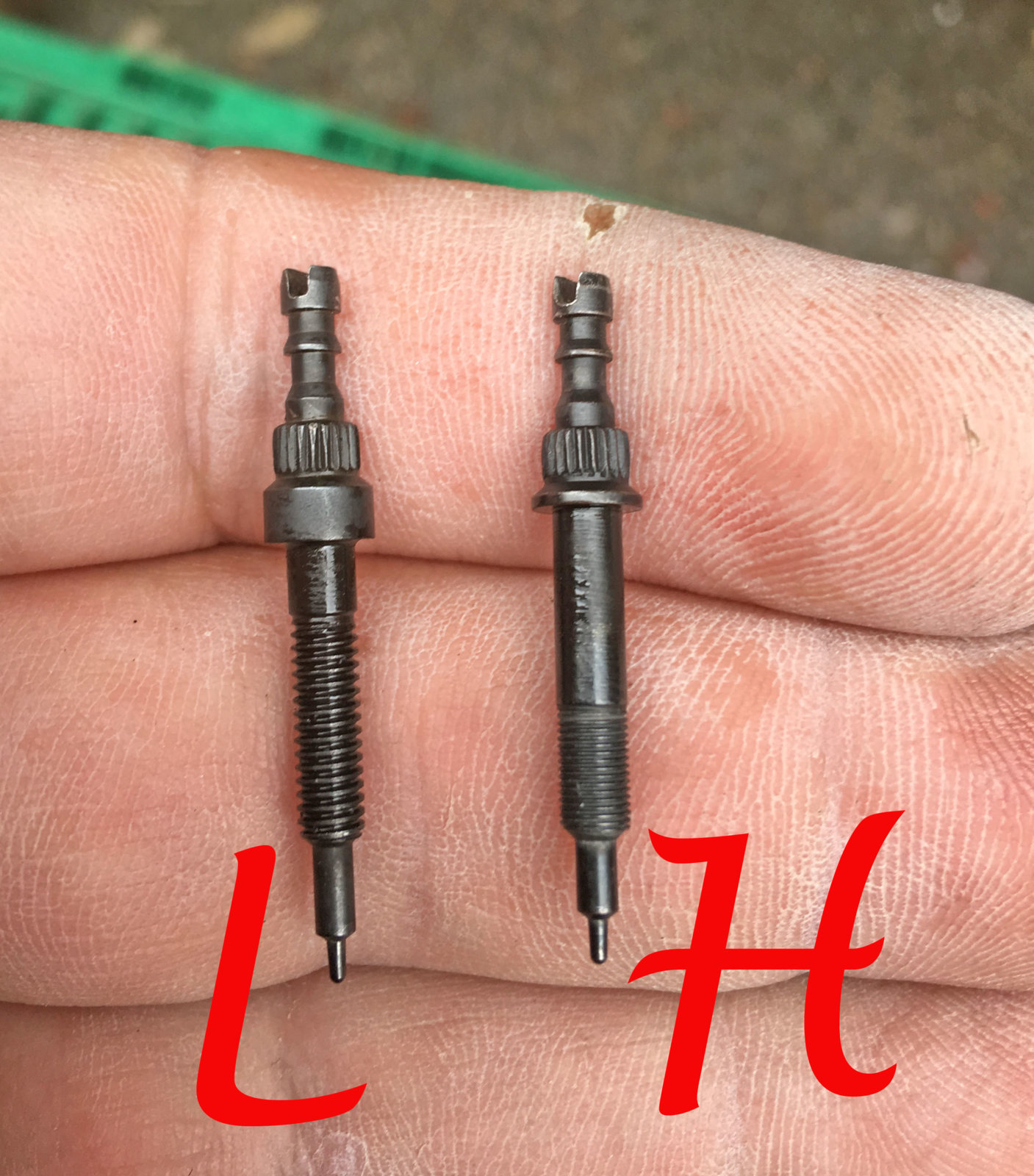

Sure, but you didn't mix the screws up though? The threads are the same but the screw profile is often different.
John :)
Im sure as i took one out at a time.

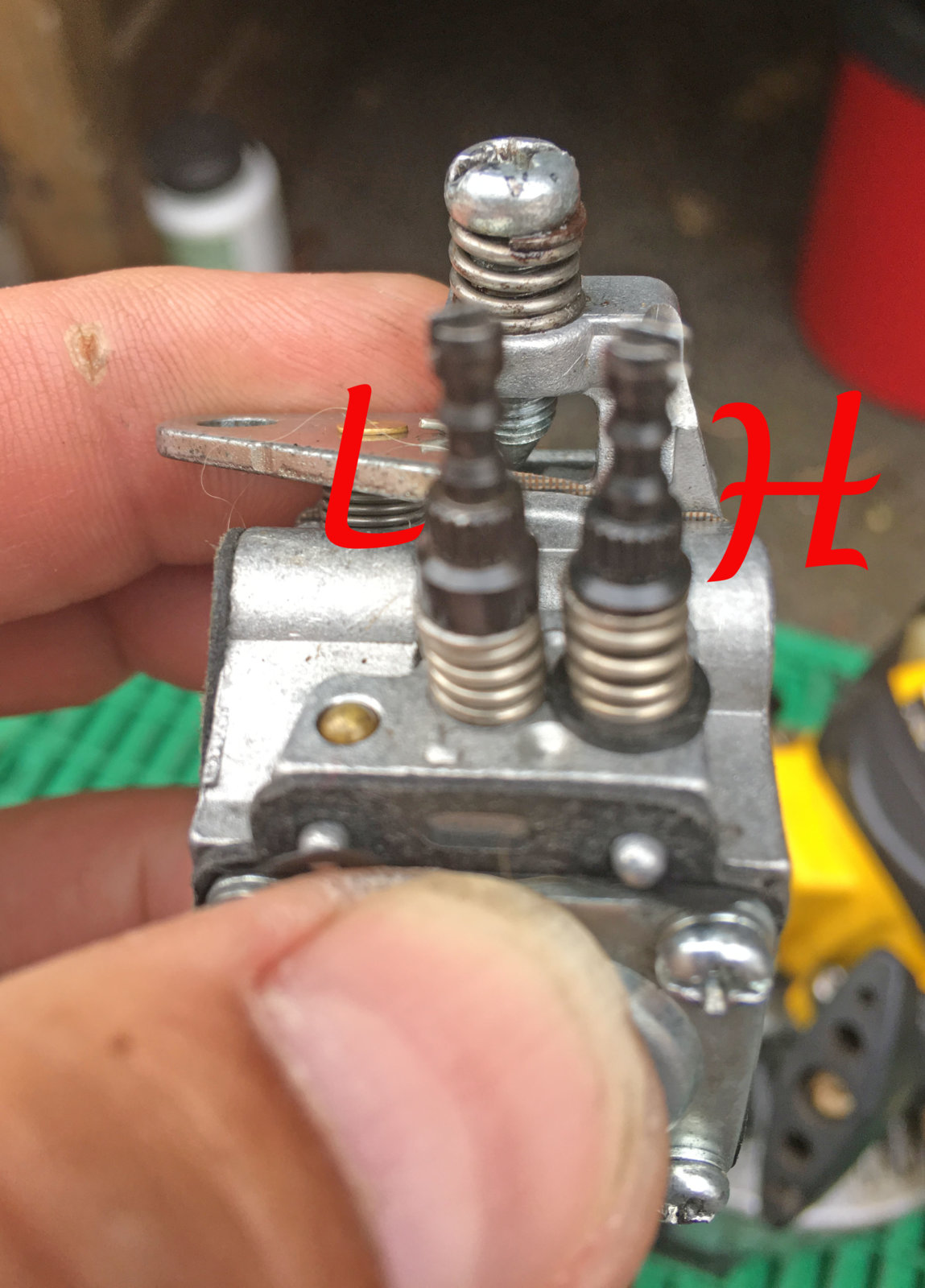

From memory when i took out the H screw there was a copper coloured washer then below that a black rubber seal.
The L screw didnt have anything.
In the kit they supply you with a thick grey gasket like material & i thought that was for the copper metal seal so i replaced it.
Anyway whilst the carb is off i will take a look again & also fit this copper coloured seal back.
I will also see if the needle is stuck open.
I will then remove it & spray carb cleaner down that hole where it slides up / down.
I will puts ome photos here for clarification before i put it back if you dont mind.
At this rate i will need to get somebody in to cut the hedge.
Hi,
I assume i dont have a spark arrester as this exhaust is all in one piece & nothing to unscrew.

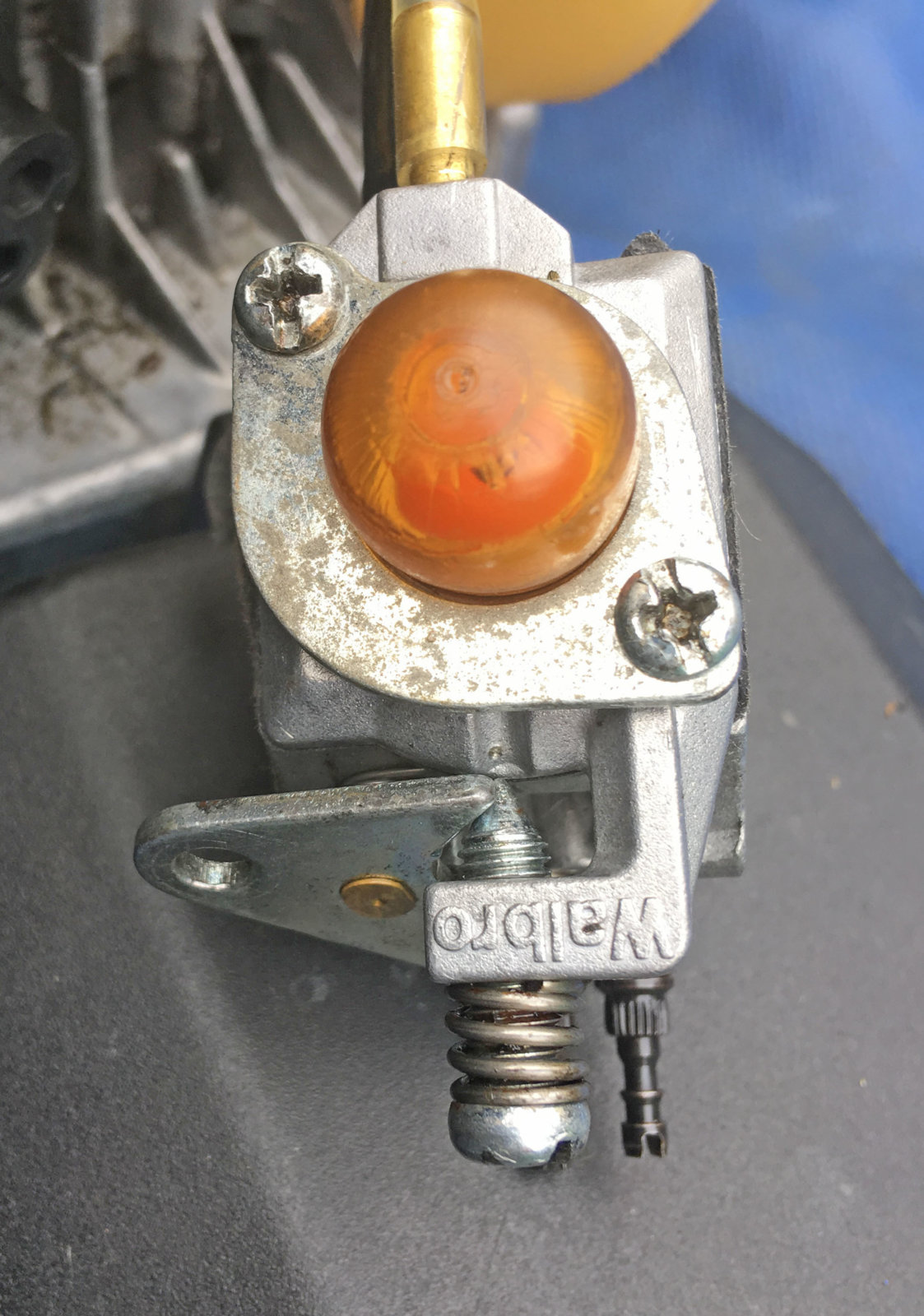

I have attached some photos now for you if you could advise anything wrong etc.

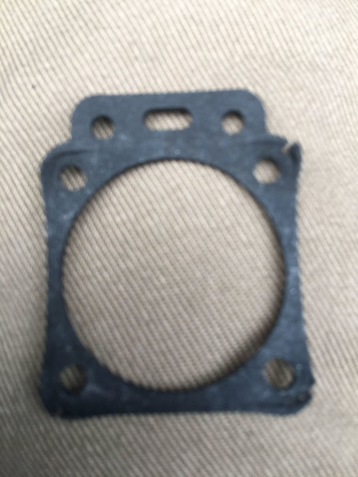

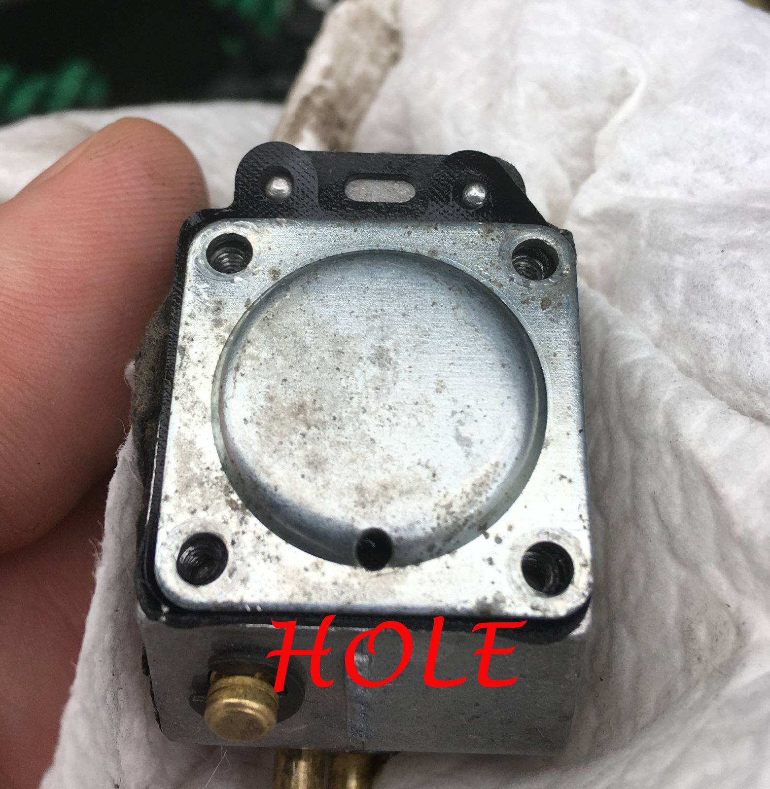

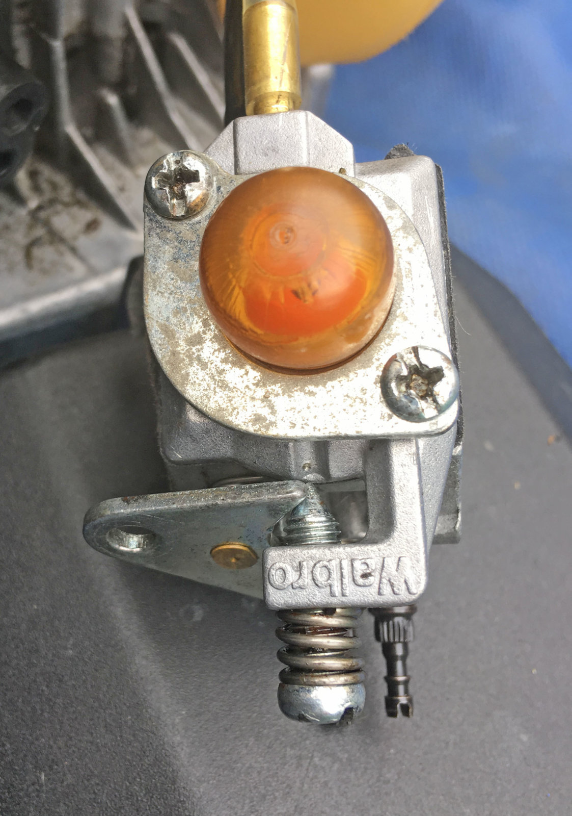

Image 1 just for orientation.

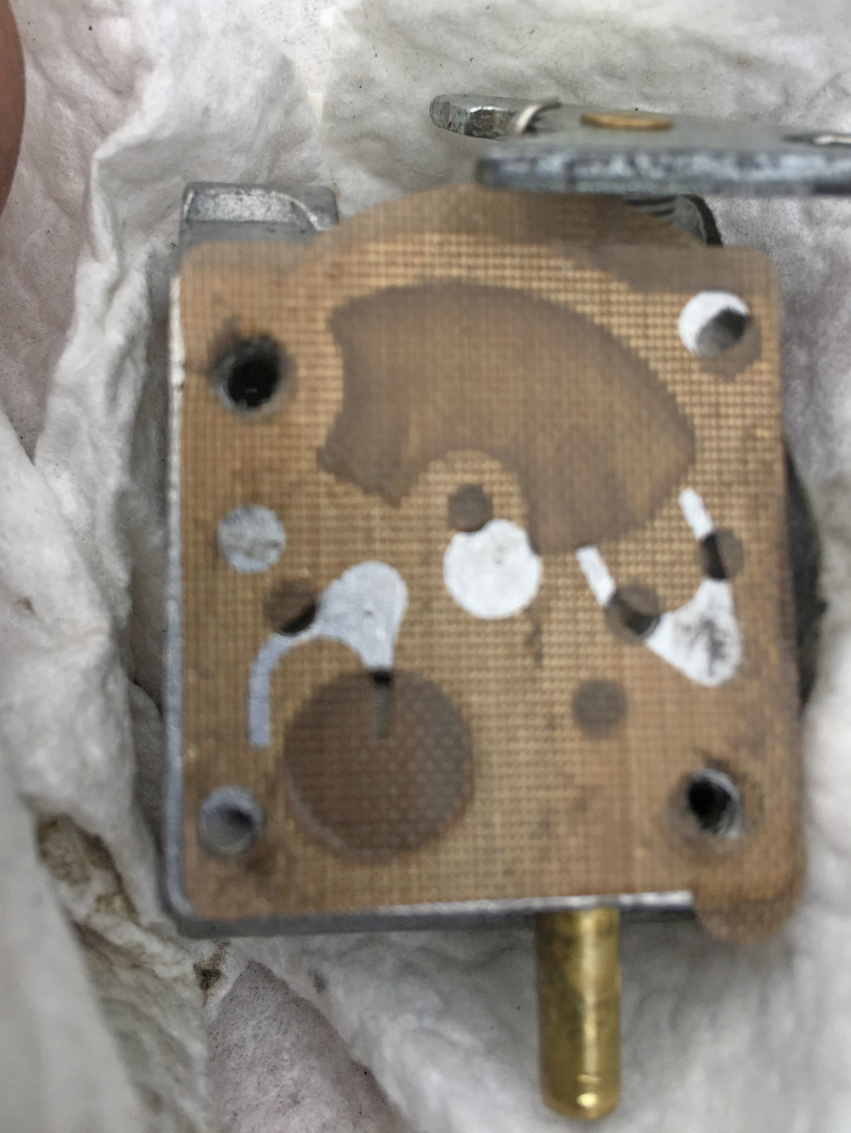

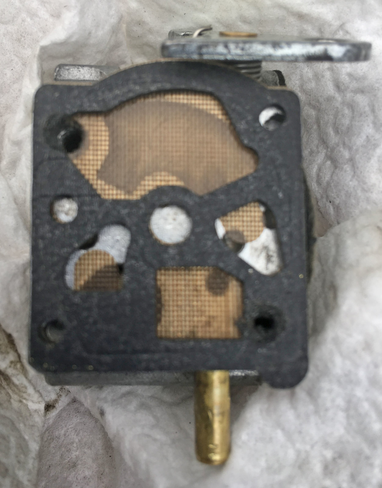

Image 2 Thin gasket on carb body first.

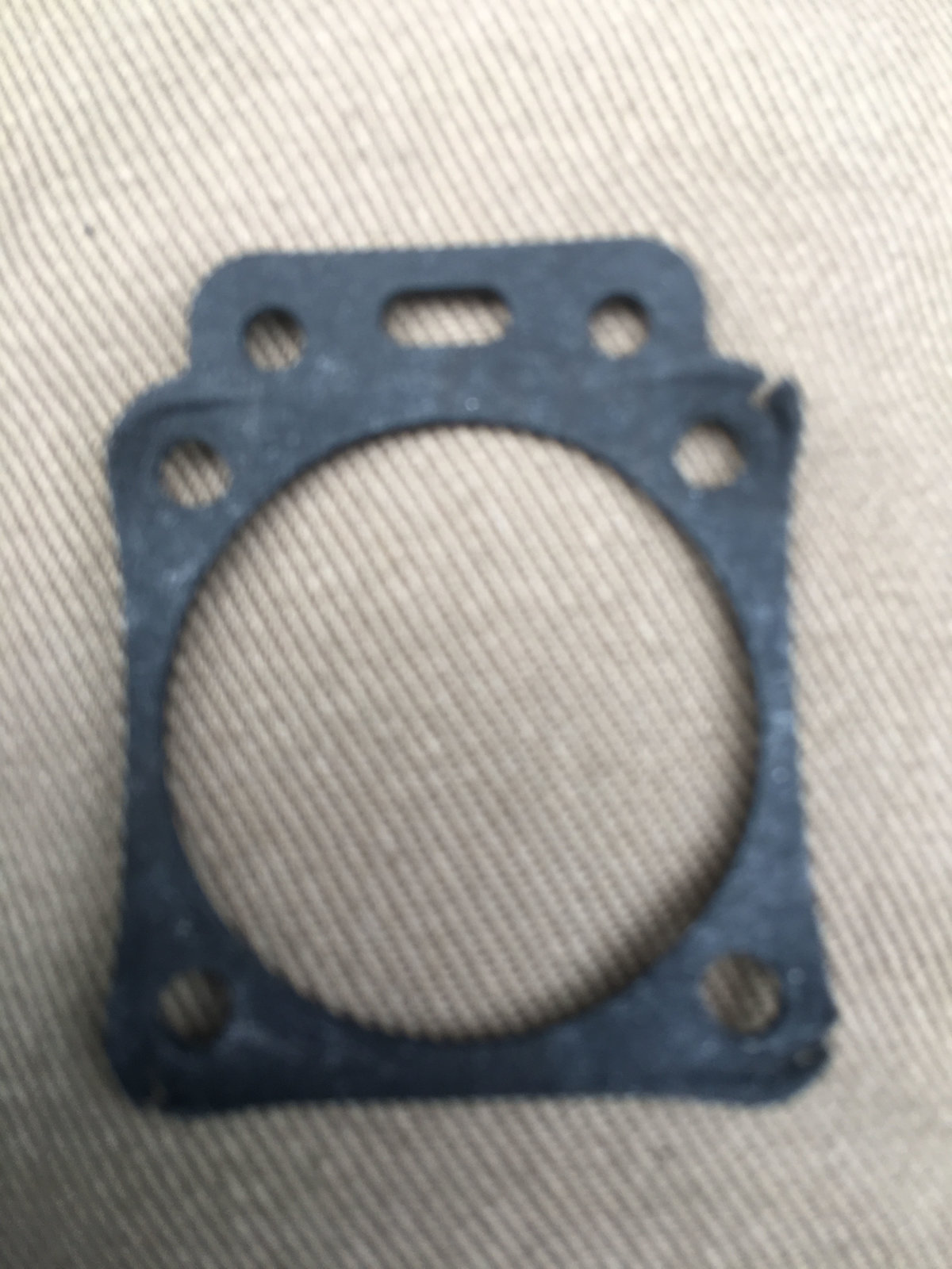

Image 3 Then thick gasket ontop of the thin one mentioned above.

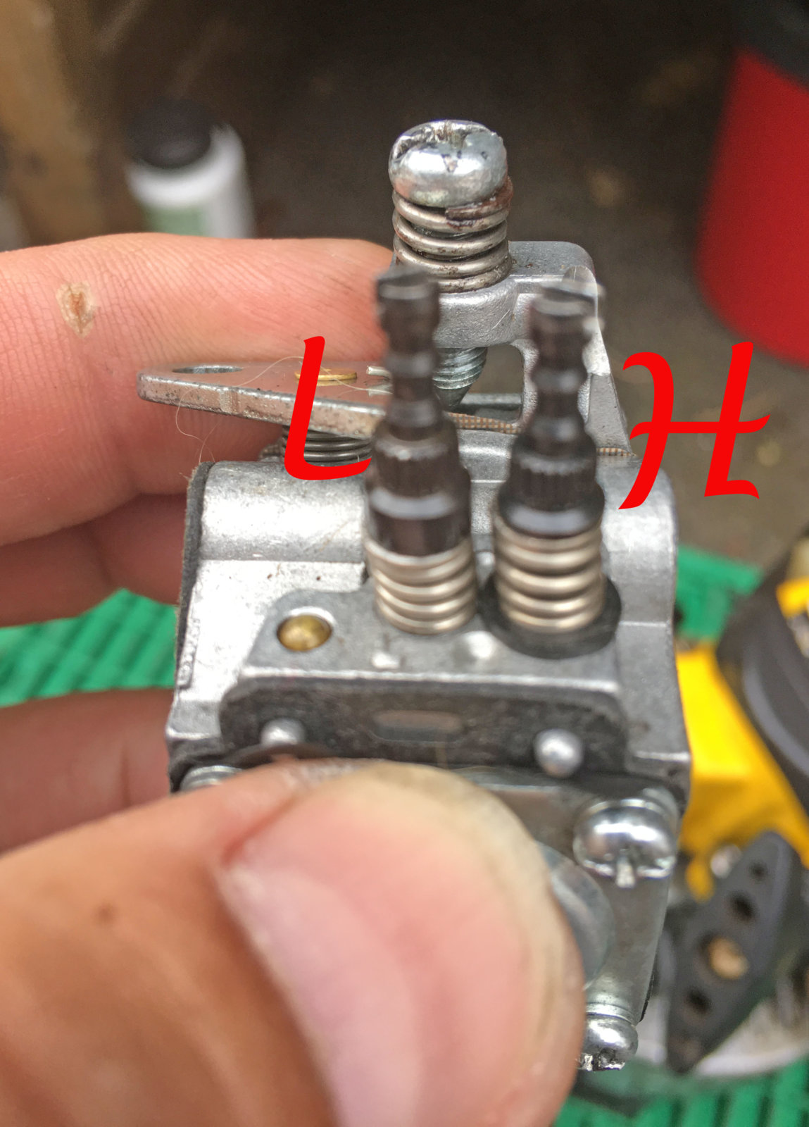

Image 4 L & H screws, H screw has that thick gasket on of which im now going to put the copper one back.
Image 5 L & H screws.

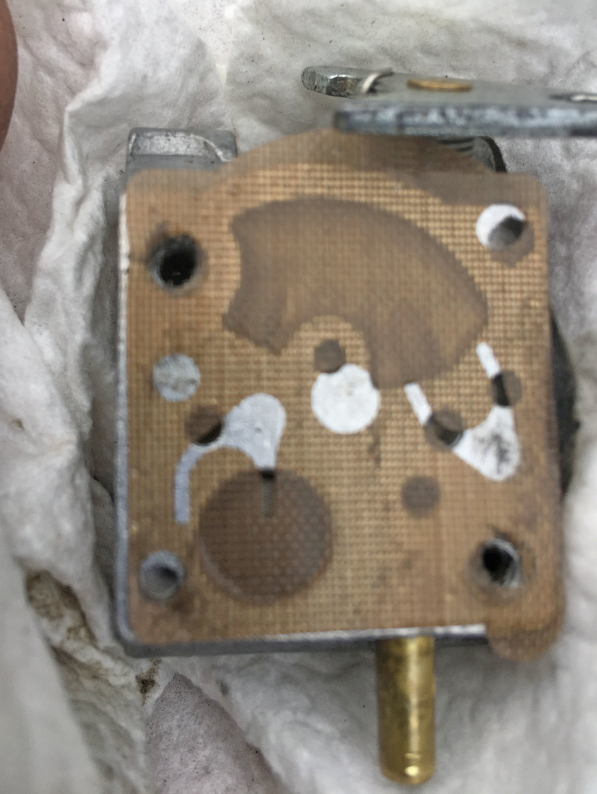

Here are the next set of photos.
Image 6 Fuel connectors BACK TO TANK has the short clear pipe, where TO CARB has the black pipe with filter fitted.
Image 7 I took notice of which end the whole was installed
Image 8 Gasket fitted to carb as shown so 6 circles etc tough carb first.
Image 9 Thick gasket that fits ontop of the gasket above.
Image 10 Pressing the rear end operates the needle jet up / like a see saw eavch time.

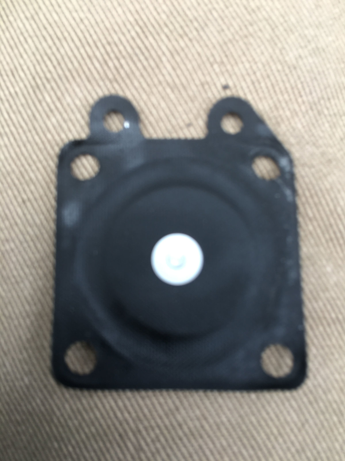

Image two....I'm not happy with the orientation of that pump diaphragm....those U shaped flaps need to cover drillings in the carb body.
Flip it over and see if those flaps cover the holes.
John :)

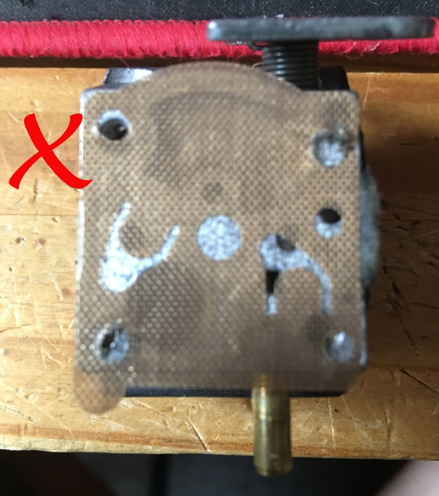

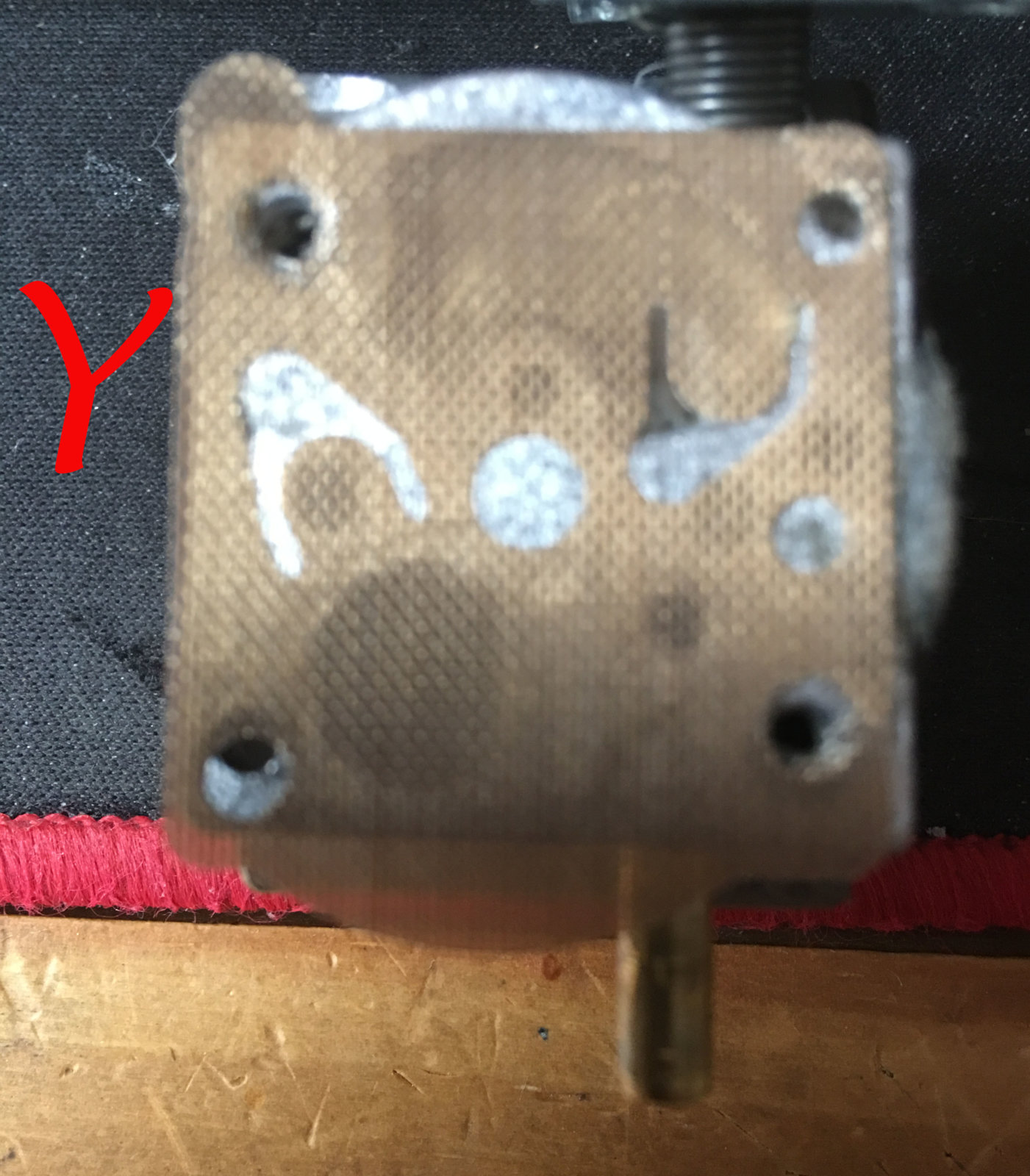

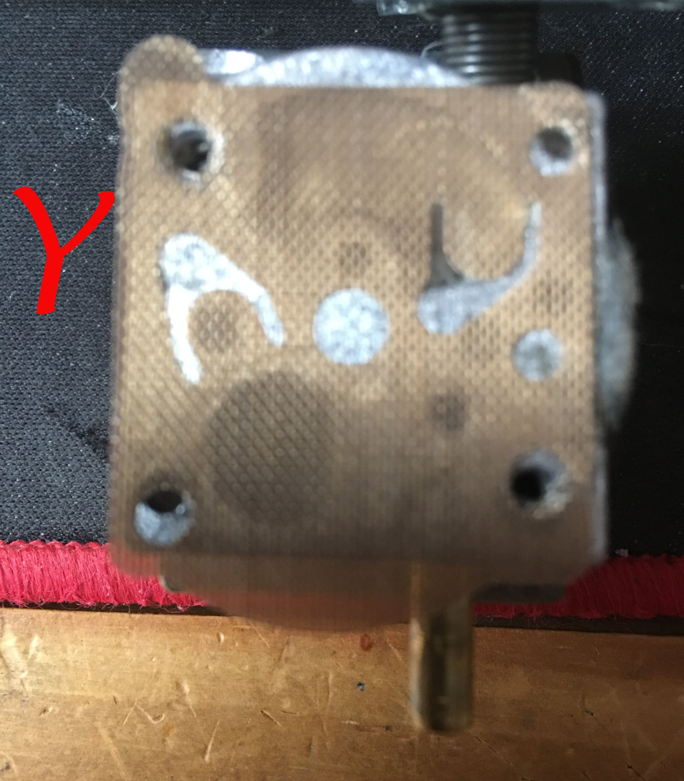

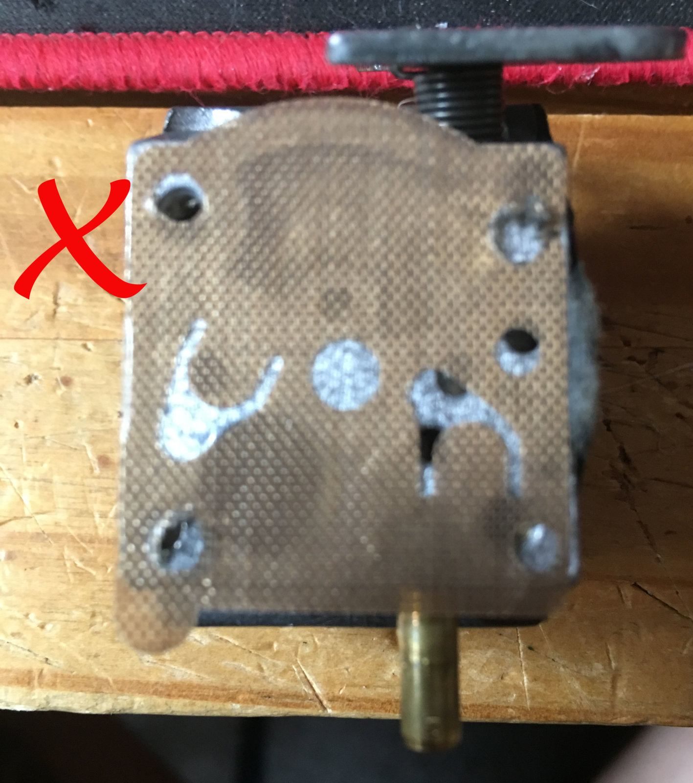

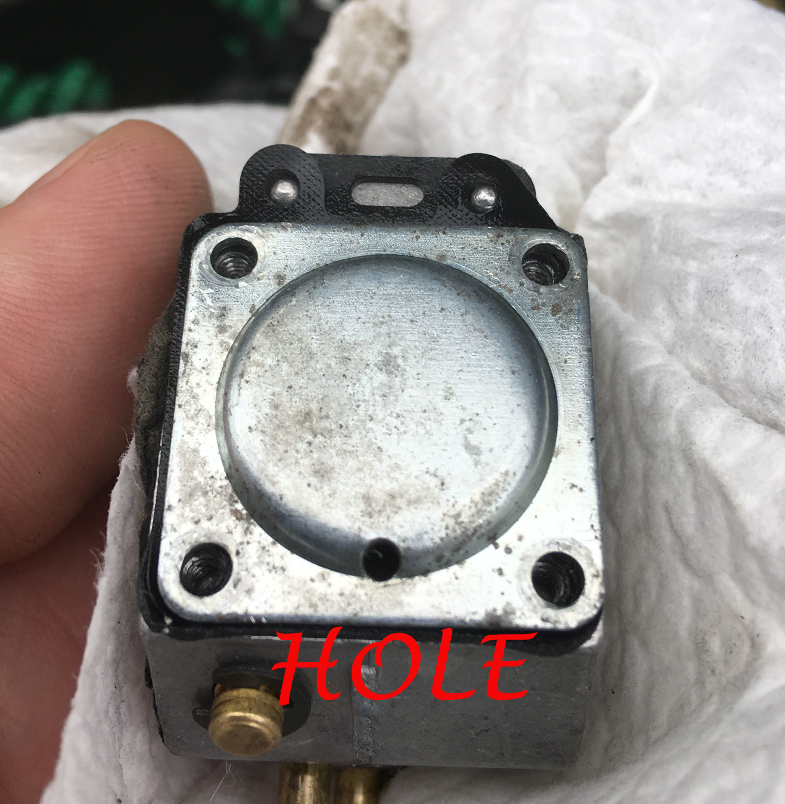

Hi,
Regarding your reply in post #69
Which is better / correct X or Y
Certainly not x, probably y but the image isn't too clear.
Can you understand what I mean by those U flaps on the diaphragm? They cover, then uncover those drillings in the carb body.
John :)
Its not y and if x doesnt line up when flipped 180°, flat side to flat side then its the wrong part but as John says, its not the best of pics
Hi
I understand.
I did look after and said no to myself.
I fitted it like Y this time.
Full choke & throttle wide open & 4 pushes of primer it’s like this morning where it starts & runs for a while so I turn off the choke and it either dies or if I operate trigger it does.
I did leave it alone once when it started but it wouldn’t tick over.
Tried backing out each screw 1/2 then then after a few tries give up.
Tomorrow will look again.
I’m waiting for a carb to arrive which looks close. If it’s anything like when I was young we just bolted anything in to make things run.
in your x y pics, is the diaphragm flat against the carb body which if its not may explain why nothing looks to be lined up?
