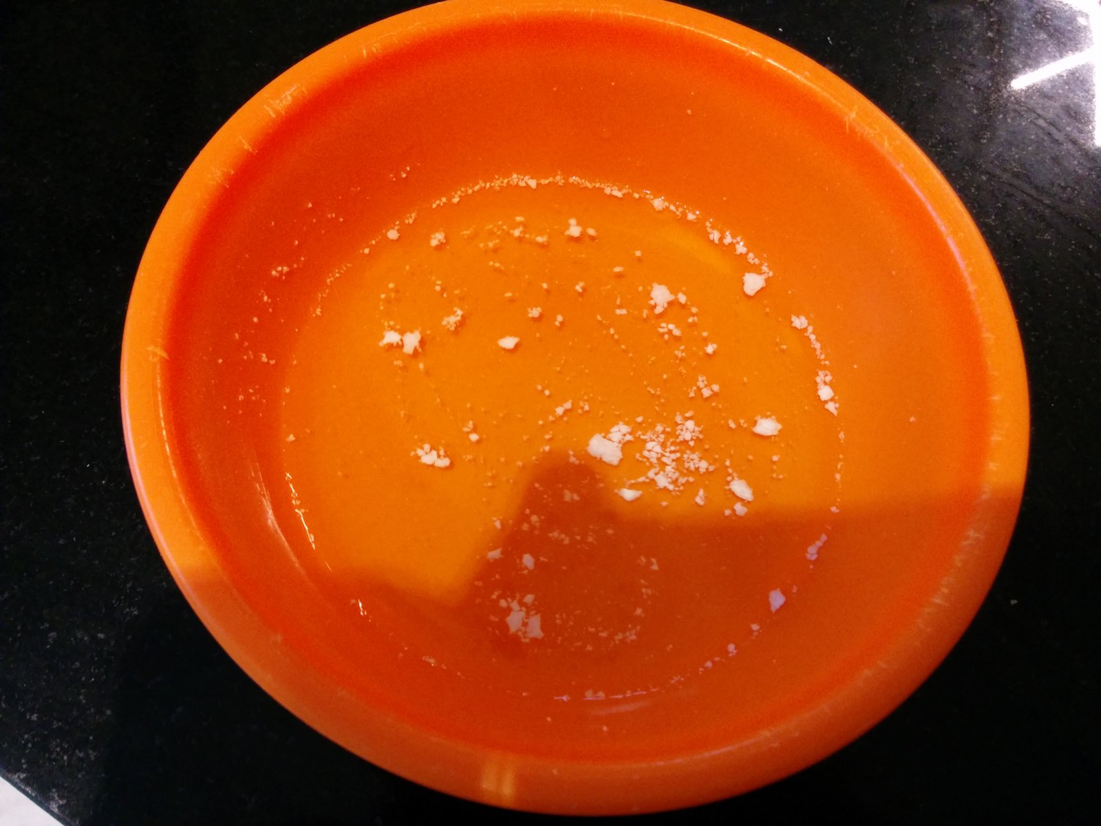

Fair point chaps. Water temp at the tap was only 45 degrees this morning so I've nudged the stat back up to around 65 on the tank and 70 on the boiler. Boiler ran for 20 mins then when it stopped I ran the kitchen tap for about 10 seconds before the familiar gurgling happened. Before this I hadn't had a major deposit for a few days, just the odd flake.
Sat them in pure oust for 10 mins - not even the slightest fizzing or hint at dissolving. Added boiling water, still nothing. Consistency is solid but soft. Can grind this to dust/sludge in my fingers with little pressure.
It's just constant now - kitchen hot tap gargling and banging whenever it's run. Mesh filter is off as it clogs within 1 second. Just filled a vase...
Have you tried drying the "scale" first and then seeing if it's combustable...perhaps the baffle is disintagrating.
Hi Gasguru. I hadn't tried that, but I just held a lighter directly to a small piece and it turned to a yellowish liquid, then immediately back to solid once the flame was removed. Definitely not combustable.
The tap appears to have cleared itself for now. Obviously the increased heat in the boiler/tank caused a load to dislodge and now that's come out it's running clear (with the boiler off). Water temp at tap 60 degrees.
I still think it deposits mainly when the boiler is running or has recently run.
That can't be scale. It looks like something inside the tank is breaking down. I presume there is no sign of anything in the cold water supply, ie nothing is coming into the house water system from outside.

That's correct Lower. Just from the hot outlets feeding from the tank.
I hadn't considered anything other than normal scale. I'm just sat here reading about debris from a disintegrated "water heater dip tube" but whatever that is (?) it seems an old issue.

Just an update. I got some Citric acid crystals and added it with boiling water to the 'scale' I'd collected. Didn't do anything.
I descaled the kettle to test and the citric acid worked wonders (better than Oust). So I added the 'scale' into the kettle and boiled it up with Citric Acid - still nothing. Vinegar also doesn't work. So definitely leaning to it not being scale. Will send a sample off when I collect some more.
I'm wondering if there could be something in the internal expansion vessel breaking down. I seem to have to recharge it quite often. It's supposed to take 2 mins to stop gurgling but this time it was still giving out glugs after an hour with the TPR valve open. In the end I had to open the 8 bar pressure valve to let a bit of water out, then it eventually stopped.
the internal baffle plate is made of a white plastic. when you recharge the air bubble you should open a couple of hot taps and the tprv. It normally takes up to 10 mins to recharge (noise to stop). The pieces of plastic look very much like resin out of a failed water softener.
