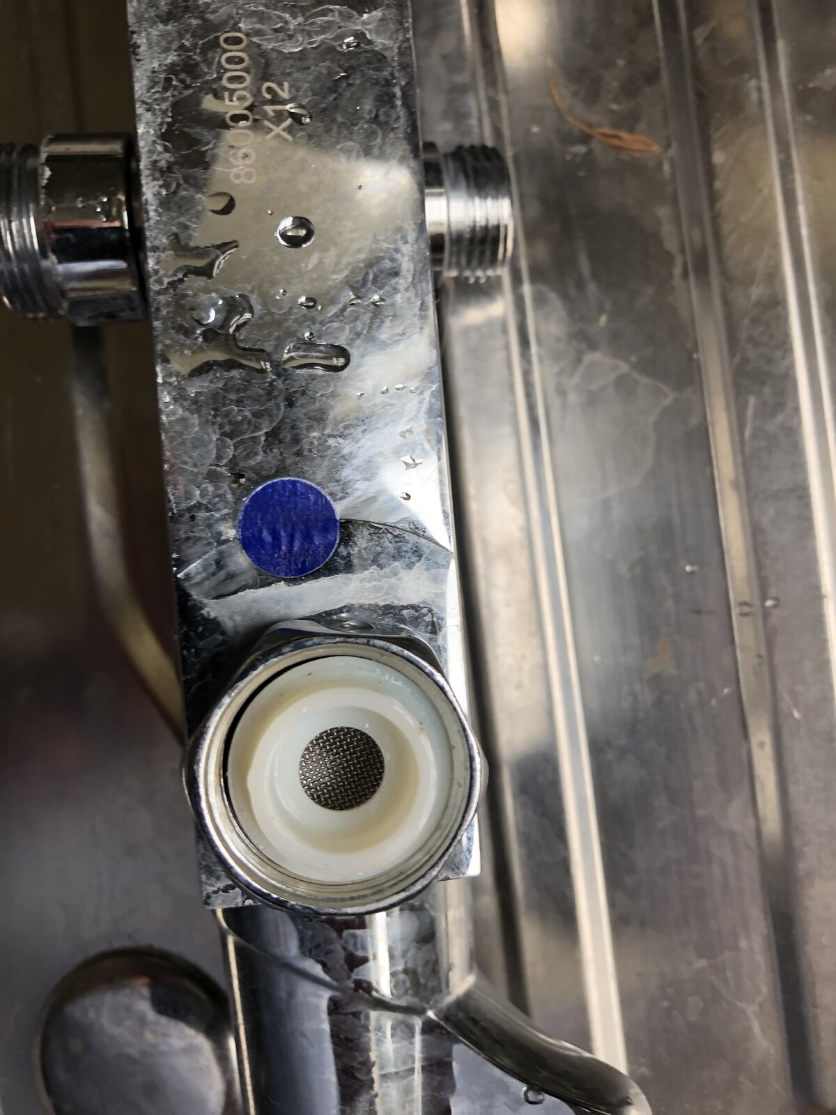

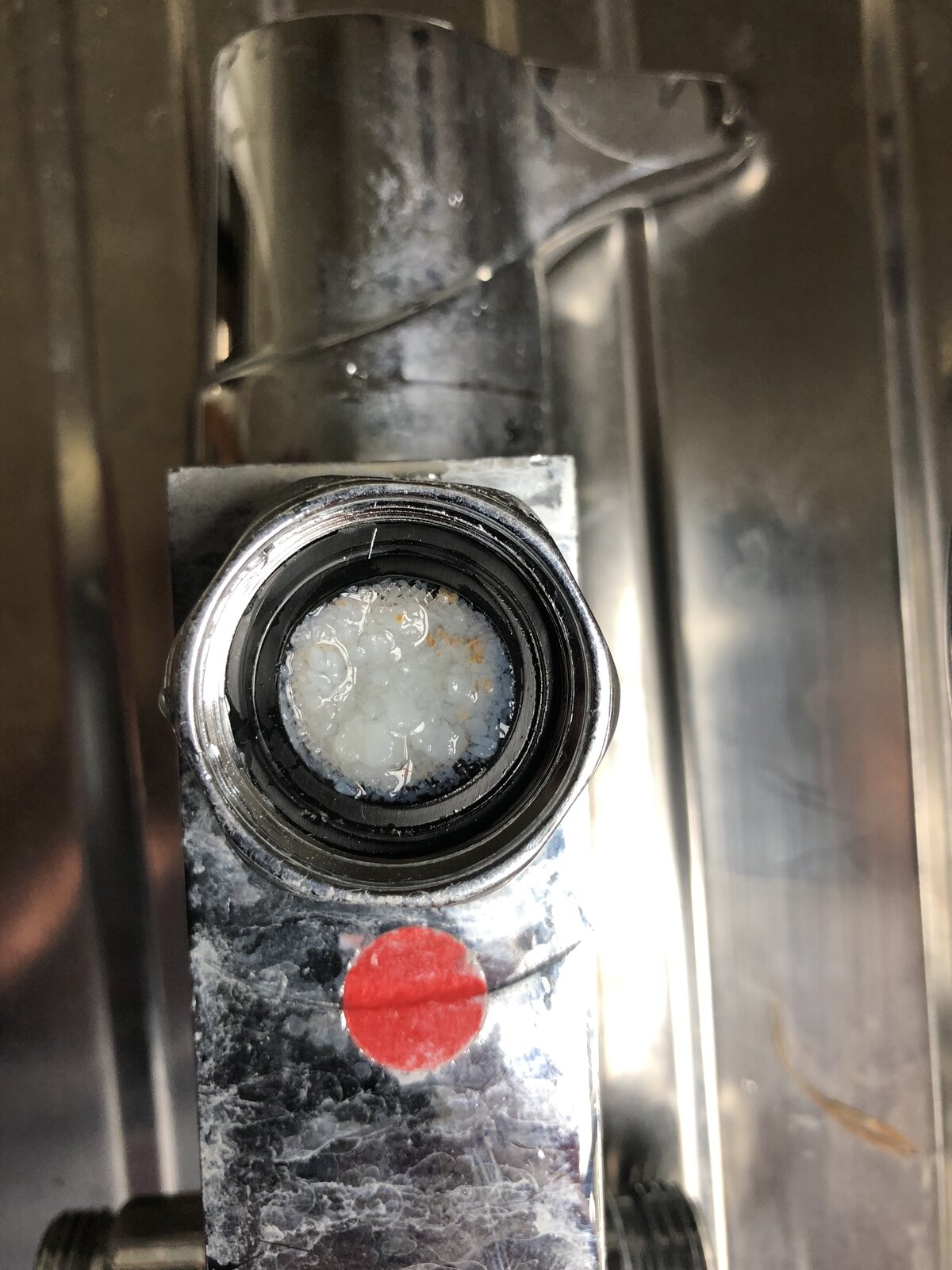

I have the same problem with white deposits In the hot water inlet filters to showers, taps etc. From what I read it looks like limescale but the water is very soft here. Kettle never needs descaling for example. I have attached a photo of the shower hot and cold inlet filters, any clues out there? The tank is 16 years old and I’m afraid it may need to be replaced. I’m getting good at cleaning the filters every few months but I shouldn’t have to do that. Someone mentioned installing a hot outlet filter?
Thanks for any advice.
