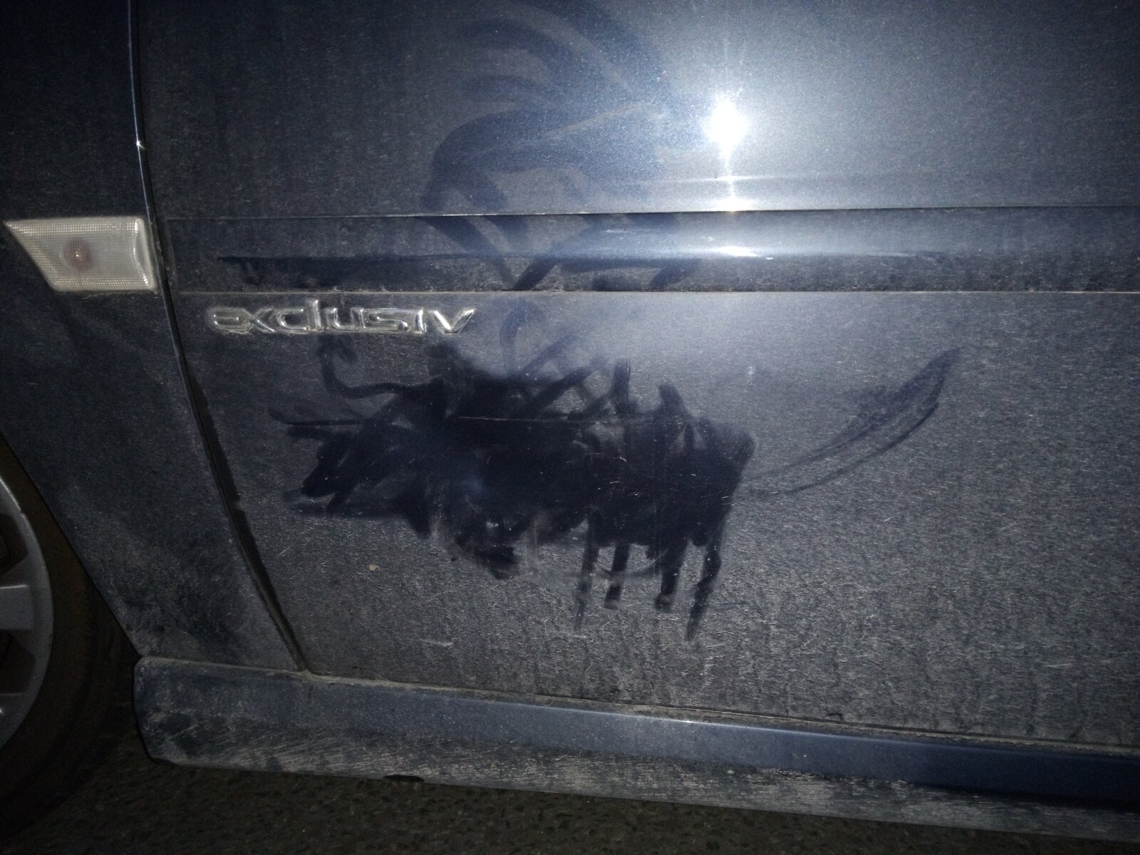

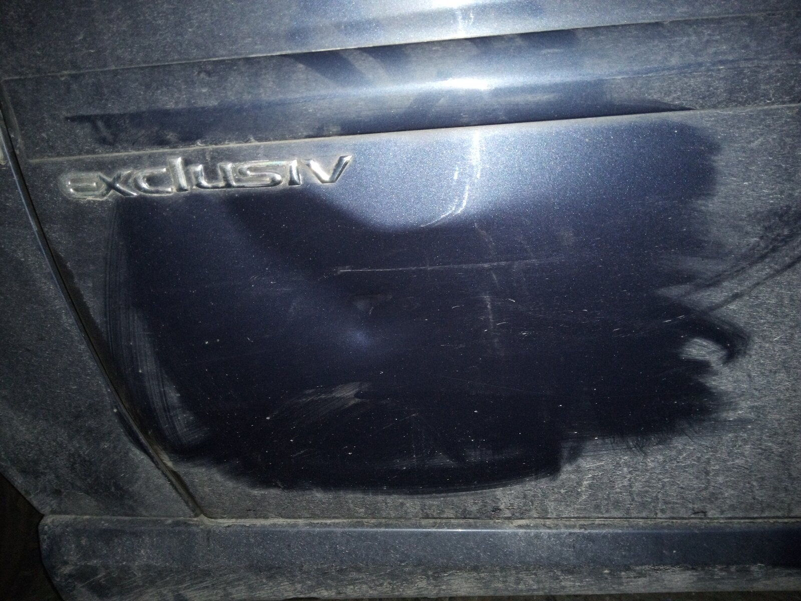

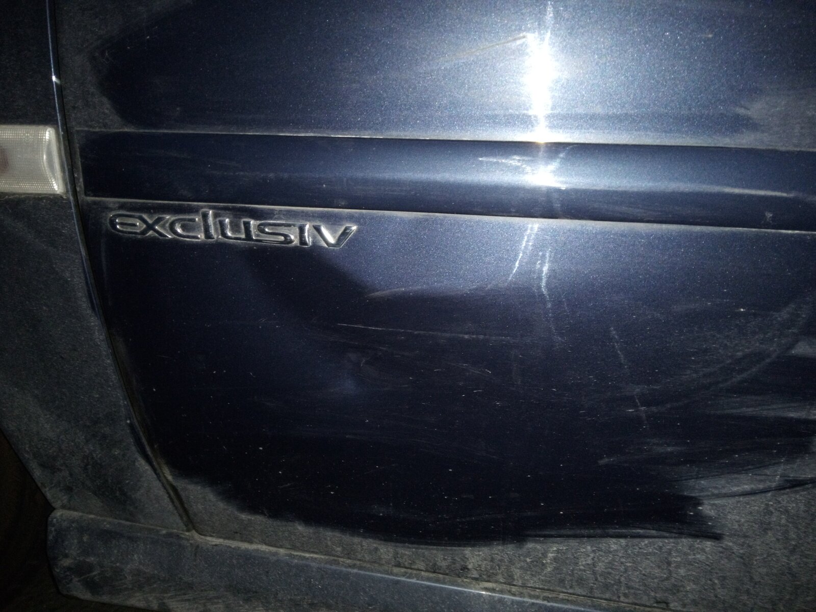

In fact only about a week ago some old careless guy backed out and hit my car door . I won't be getting it repaired, I'll be getting the door replaced. it's much more economical to replace the door which will cost less than than £100 I will be fitting it, and yes I'll likely be here to ask for people's help so don't come to be sarcastic when the time comes for me to do the door replacement.

Fitting a new door is a two man job due to the surprising weight - I have done it myself with the aid of a well padded trolley jack though, but I don't recommend it!

Firstly i believe your car is a 57 plate manual hatchback and if thats the case it doesn't have a DPF.
Secondly if you are changing a door on the front you MUST first remove the door module as this is programmed to the car and fit this to replacement door
otherwise the car will deadlock itself but will not be able to reopen that door.
