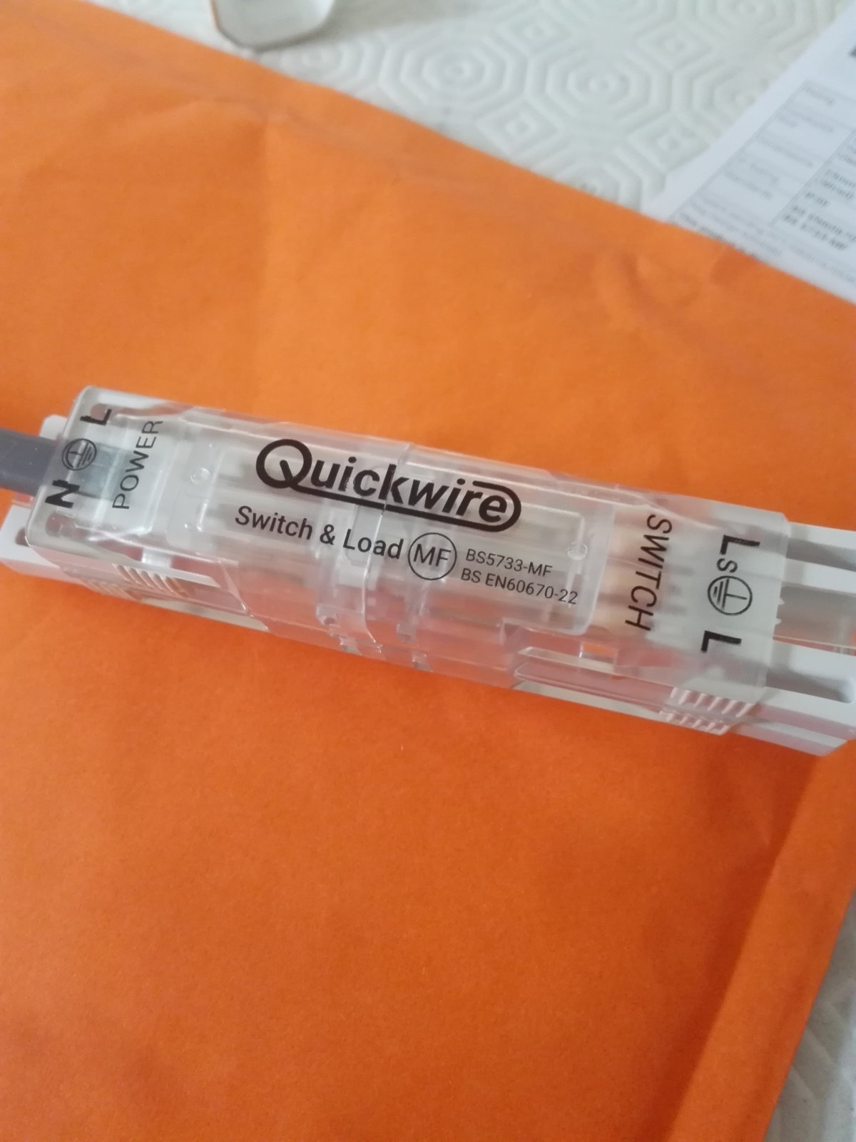

In answer to your question, I would carry them, yes.
Very impressed.
And they sell a cable stripping tool which looks good too.

In answer to your question, I would carry them, yes. Very impressed. And they sell a cable stripping tool which looks good too.
They certainly look very clever and very impressive. I must get one or two to play with!
I wonder if they are considering a 32A 2.5mm² verison of the 'splitter' one - since that would seem an obvious thing to offer.
Earth sleeving??? :)
Given that it's all enclosed, and the conductors maintained in precise posutions relative to one another, I don't think there's a need, is there? The CPC is in exactly the same situation as regards L & N conductors, and the outside world, as is the case within the T&E isn't it?
Kind Regards, John
As for the stripper, see the very start of the video on their website. It's technically 'two operations', but all over in about 1 second
Is continuity only made when the ends are pressed in - and vice versa?
Dunno. Not checked with meter.

I have four on the van, i got them to connect some small downlights as the T and E looked short and I thought they would make it easier.
Howevever i arrived on site to use them, only to find as BAS says they do not acccept flex so as the downlights were prewired i resorted to using Hagar J804 boxes instead.
Mine are 2 months old now and unlike the current ones are not MF marked, so if you need that, ensure the ones you buy are newer stock.
The splitter is £5.47 and the other £5.99
