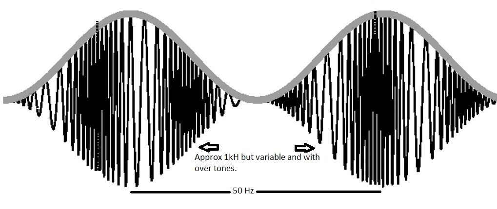

I don't have the actual scope screen shot but this is very similar to the wave form found on the output of a SMPS 12 volt AC supply
Interesting both kHz and 50Hz at same time, the point is the same however if not 50Hz then a capacitor used as a current limiting device will allow a different amount of current through than the designers intended, also if you look at a basic radio
and the components in a LED bulb you realise the latter is very similar, so with any other supply other than the designed 50Hz you could be building a transmitter. You have all the components you need, at random I selected a set of instructions for an electronic transformer "exclusively designed for the use in halogen lamp systems" and "max. 4m long" for cable length "The transformer can only be used with the halogen lamps" and "To avoid RF interfering radiation, the lengths of the supply cables of the lamps must not be more than max. 4m." as I say it was just selected at random not saying all "Electronic transformers" are the same. this one states 1.5 meters max it does not say quartz halogen only with this data sheet, but it does say "The output leads should not be separated by more than 10mm and should be kept to a minimum length to achieve optimum regulation and EMC suppression."

AM = amplitude modulated since the transmission is not modulated it is hardly a AM transmitter although it could be a transmitter, the second pdf I linked to states 40 kHz as output frequency, Low Frequency is used for things like time signals, and aircraft navigation beacons, so to cause interference on this frequency is serious.
The problem with electronic transformers is they are only able to comply with electromagnet compatibility requirements if the manufacturers instructions are complied with, since these differ even on the two examples I looked at the problem is when they are replaced or modified by non qualified personal, the general public are unlikely to down load the data sheet and find if the model they have states quartz halogen only, or 4 meters max length or 1 meter max length.
