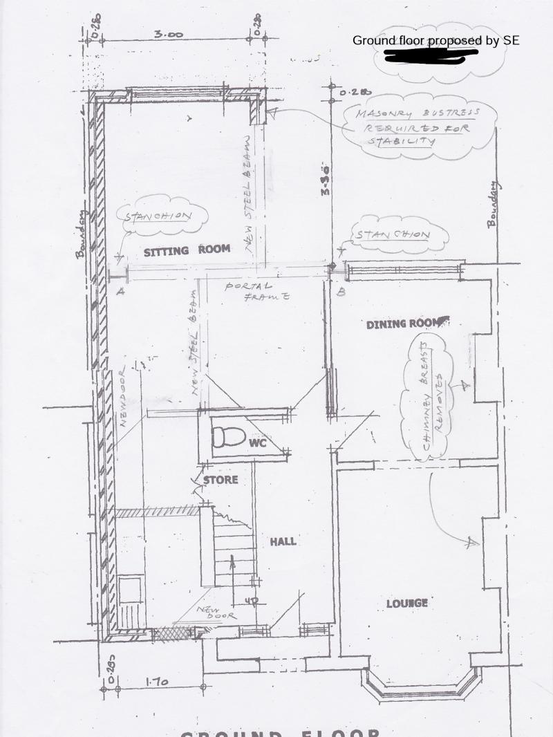

Basically my position is as this. I have currently have purchased a house which has previously had an extension done from North to South of the side of the house. This is a two-storey extension with the last one meter of the rear garden being a single storey extension with a pitched roof. I am now looking at the installing bio-fold doors which would be shaped as a cornerless L. the top of the Letter L being where the issue is with the return.
A further issue which has been identified by the SE is that the universal beams would be sitting on the parameter of the wall and therefore I need to consider thermal issues to cover the steal beams. Does anyone have any suggestions of how to cover the steal beams without installing a canopy? (And which can blend with the existing brickwork) below the beams would be the biofold doors.
Many thanks for your help in advance.
The plans posted is the proposed layout by the SE. He has used these drawings based on the architectural plans when the property was extended.
Don't know about the thermal issues - maybe one of the architectural bods can help there - but you can certainly lose the buttress with a little thought from the SE.
Maybe a wind post directly between the foundation and the steel beam (as long as the perpendicular beam can withstand the wind loads). Alternatively an "L" shaped wind post with the bottom of the "L" resin fixed to the existing foundation.
As above, it's possible an engineering brick pier would work if the circumstances are right.
You need to talk to your SE and ask him to explore alternatives if you are certain you don't want the buttress.
