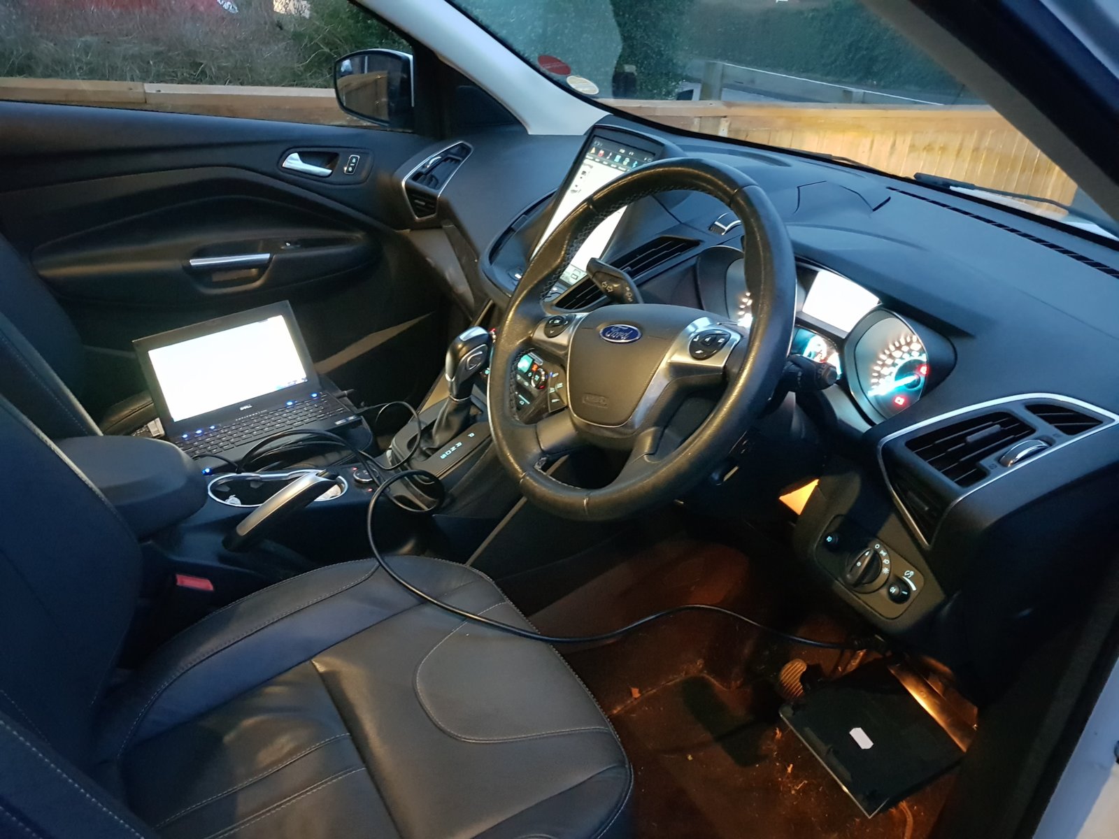

My gearbox ended up as a bit of a Frankenstein, 2017 mechanicals with a 2013 TCU (Mecatronic Unit).

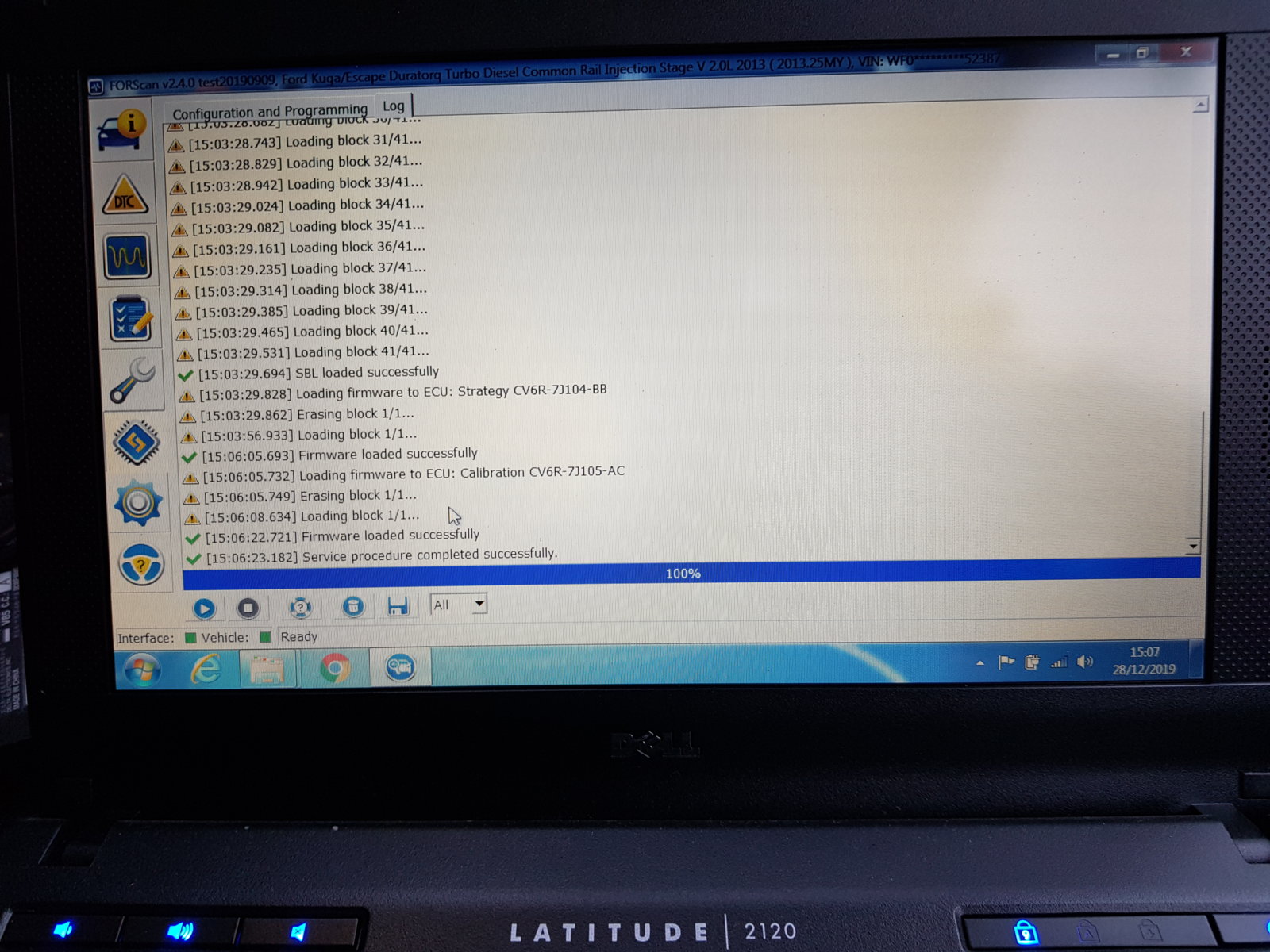

It was a touch snatchy when cold, after some more research I found out the was a Firmware Update in 2014 and mine had 2012 software on it.
The only downside is the possibility of bricking the TCU during update which would have been a nightmare to sort out.
So being a bit bored over the holiday I decided to have a go!.
The main thing is if the battery voltage drops below 11.5v the flash will fail, depending on what point it could write the TCU off completely.
Put my 4amp charger on and with the car sat with ignition on it was dropping to 11.3v!. Went to work and got the proper charger..
After seeing a reliably 13v I bit the bullet, FORScan said 2hrs but it was all over in 2 minutes!. DTC's galore (due to programming but all cleared and none returned.
She drives better than ever now!. Sent the developers at FORScan a message as I'm sure I'd have given up long back without it.

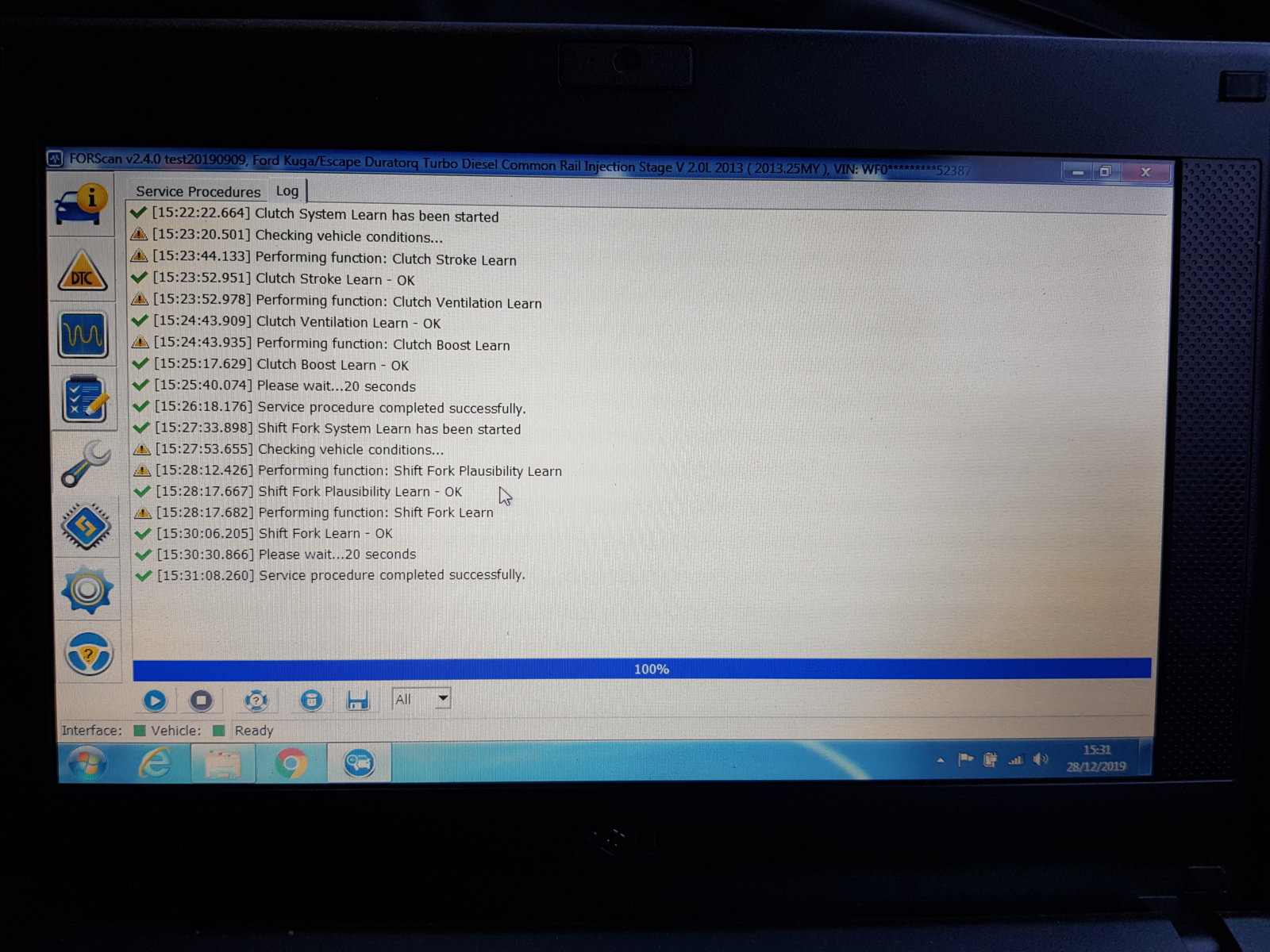

Sailed though a Clutch and Shift Fork learn (always a worry!).
Was a definite ass clencher when it says erasing blocks..
Anyway thanks to all who have read this saga from start to finish and hope everyone has a Happy New Year, I know I will now!.
