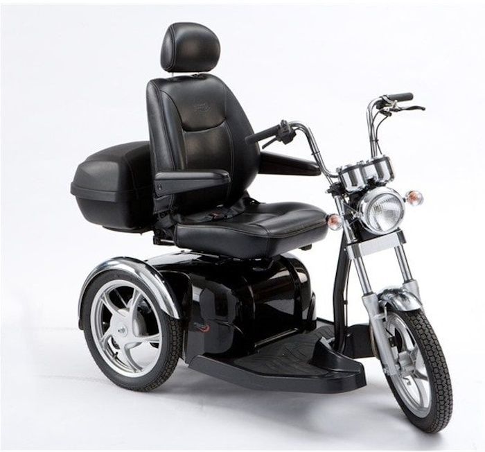

None, it's a tiny micro switch, set deep in the part of the lever which doesn't move, the part that clamps around the handlebar - it acts almost the instant you touch the brake lever. I've a switch in series with it for now.
Done and working...
Rather than make a hole in a panel for the switch, I made a bracket out of some soft plastic, and fixed that on an existing panel bolt, and added a little toggle switch. Just below my left hand, so handy for disabling the interlock when needed.

I think you would be suitably impressed with this - large alloy wheels, spring and damper suspension, a very robust looking ladder chassis, very effective lights, indicators, stop lights, mirrors, hydraulic discs brakes at the front, drum at the rear with handbrake. It has three speed settings, 4mph, 8mph, then an illegal in the UK a 16mph setting, for the 1000w drive motor. Rather oddly, on a downhill slope, it can just freewheel, so it can easily go a lot faster than the set speed.
Unlike my deceased partners old Rascal, which I began making use of, the new one doesn't slow down any on the hills, it just keeps going at the full set speed.

Whether set to 4, 8, or 16mph on the switch, it makes no difference to trying to manoeuvrer. The setting only limits the maximum speed it gets up to. It uses soft-start, applying the power and acceleration gently, up to the limit. The problem seemed to be, the soft start system was time based, from when the throttle is opened, but the time ignored the brake inhibiting power being applied to the motor. As it was - rear brake on, open the throttle, gradually release the brake, and by that time, the soft-start, could be set to apply much more power to the motor, with the result that it could jerk the front wheels off the ground.
The switch I've added, in series with the rear brake lever, allows the brake to be lightly applied, with the left hand, whilst at the same time opening the throttle with the right hand. I just need to remember to switch it off and on, manoeuvring, versus normal operation. At manoeuvring/inching speed, you can feel the 3-phase motor, 'cogging' slightly.
Just a shame the designers, never considered there might be a need to be able to use brake and throttle, on a hill start.
