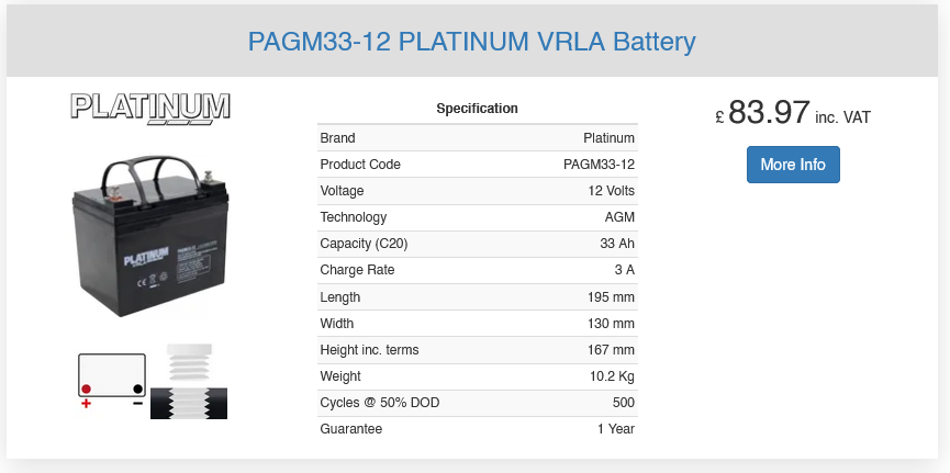

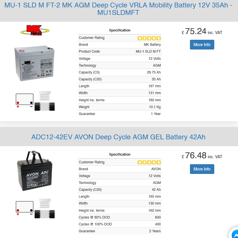

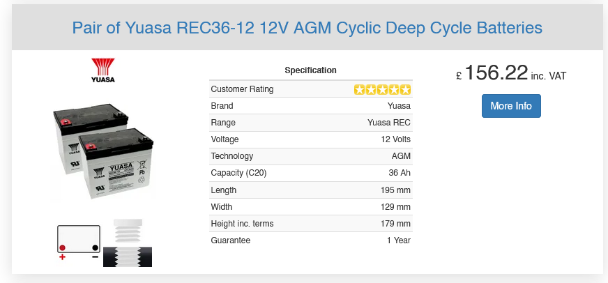

Based on elimination by size (maximum capacity for the box) I get these option.
Obviously I would need 2 for the singles.
The Avon is an interesting one with it being GEL based, 42ah and a 2 year warrantee.
While that kind of capacity might be overkill, I think having that extra capacity is a nice redundancy.
Thoughts on these options?

Yuasa all day long for me.
https://www.avonbattery.co.uk/ mainly sold by https://www.bblbatteries.co.uk/ are simply an unknown entity. MK brand were the ones installed in the first Pride GoGo charger (I'd avoid due to that).
NB That size Yuasa is sold on RS Components so is obviously not designed solely for Disabled Mobility Scooter use, and nor would any other same size battery be. So it will not be VAT exempt under HMRC rules. (Unless supplied and fitted by a mobility place, who would pay vat on purchase and reclaim that in their VAT return; but bill you at zero rate vat for replacing the batteries.)

Lucas have been made for the brand by many:
Yuasa made them for Lucas until 2006. Currently Numax make them for Lucas (Tayna website says).
Yuasa are still made in Wales, I believe. https://www.yuasa.co.uk/2021/05/gs-yuasa-celebrate-40-years-of-battery-production-in-south-wales/
MK is a US brand and Tayna seem to rate them highly. (As I said my bad experience clouds my judgement of them; due to that faulty Pride GoGo scooter charger.)
