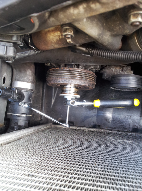

The china bearing precision was right on the money. The inner race was an exact fit, making my improvised mini-bearing press perfectly adequate. Here's my giving the shaft circlip a final push to make sure it sat fully in the groove. The force was such that I curved the 3 stacked small washers closest to the thrust nut. There's more power to the M6 press than expected. I can't test the AC until tomorrow to allow the thread lockers to cure for 24 hours. I am quite hopeful I will have a like-new AC.
