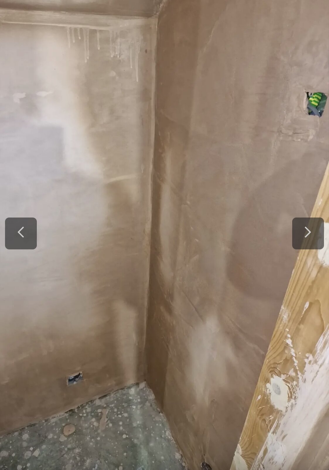

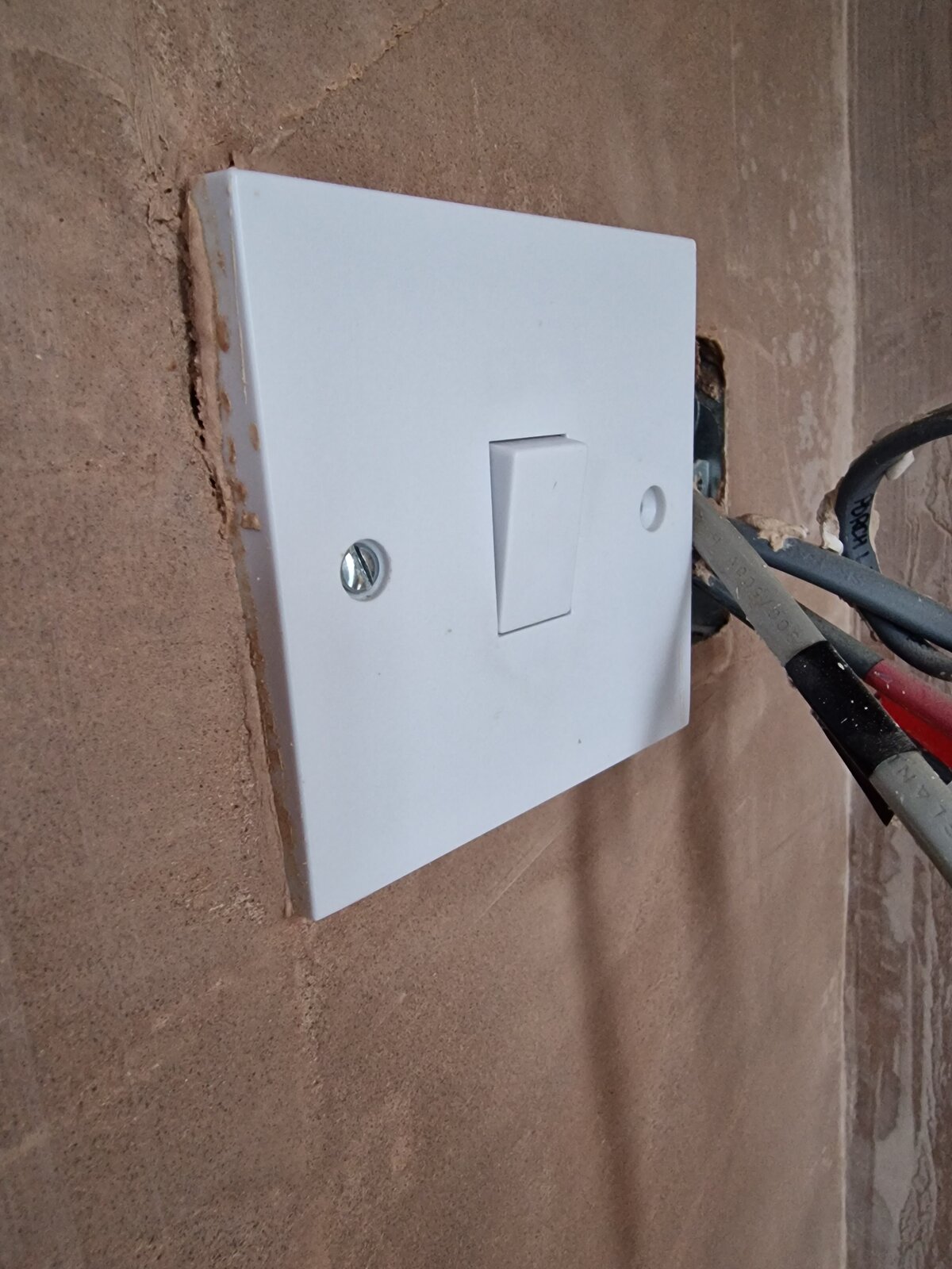

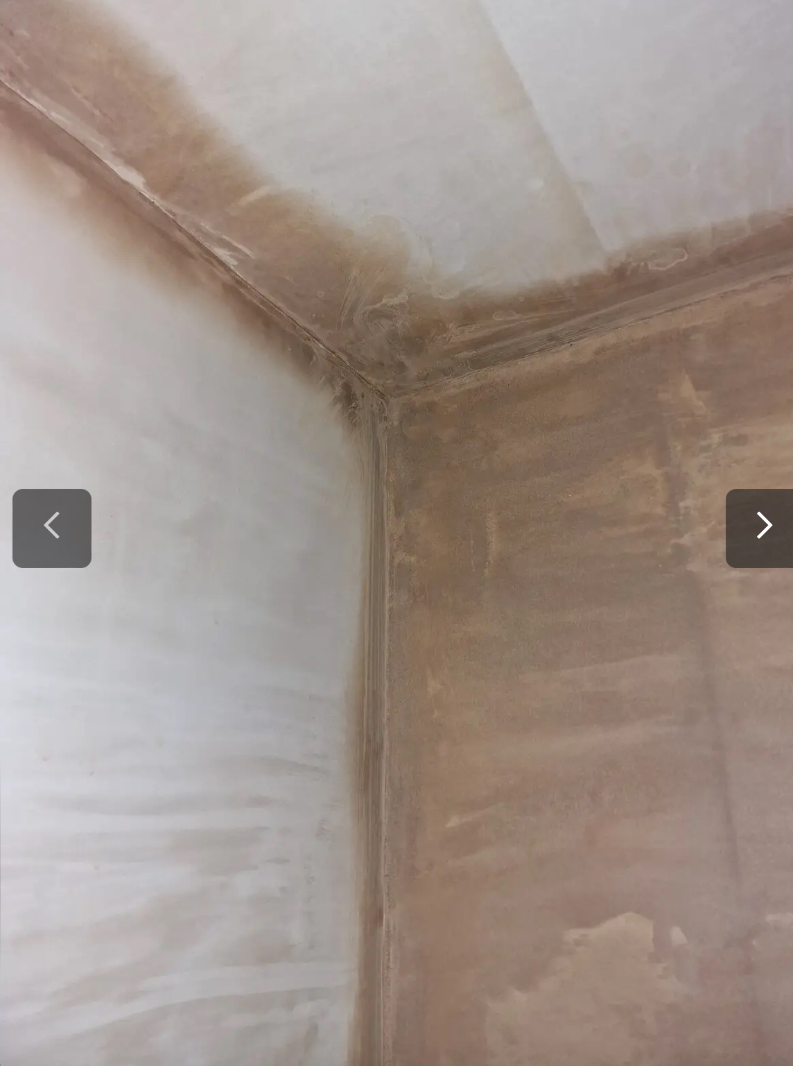

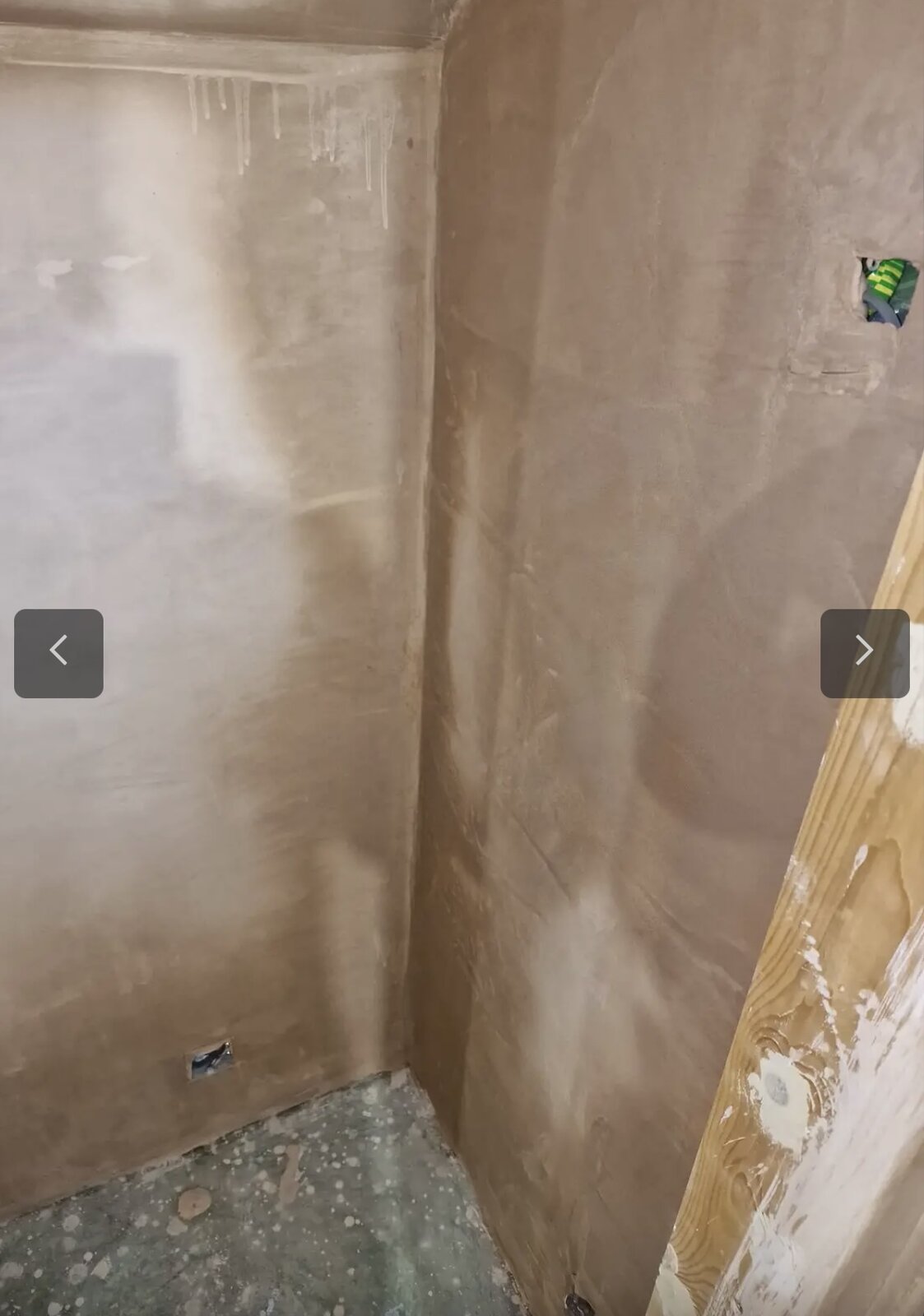

Back home from work, couple more pics as it's drying out...
Chap at work mentioned it could be possible to chisle out the worst of the thick plaster in the curved corners, then sand, fill, sand, fill until it was right?
Only exploring options until a second plasterer comes round to give his/her opinion for any further action.

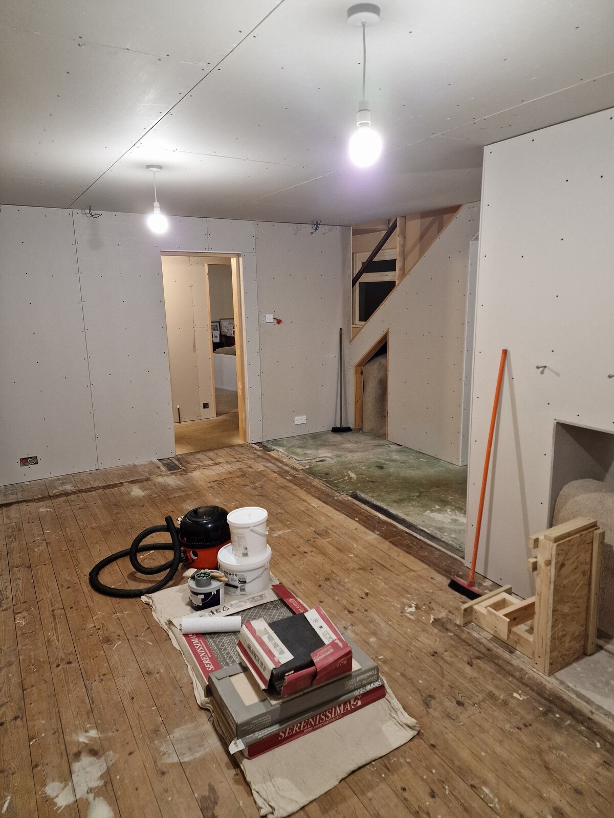

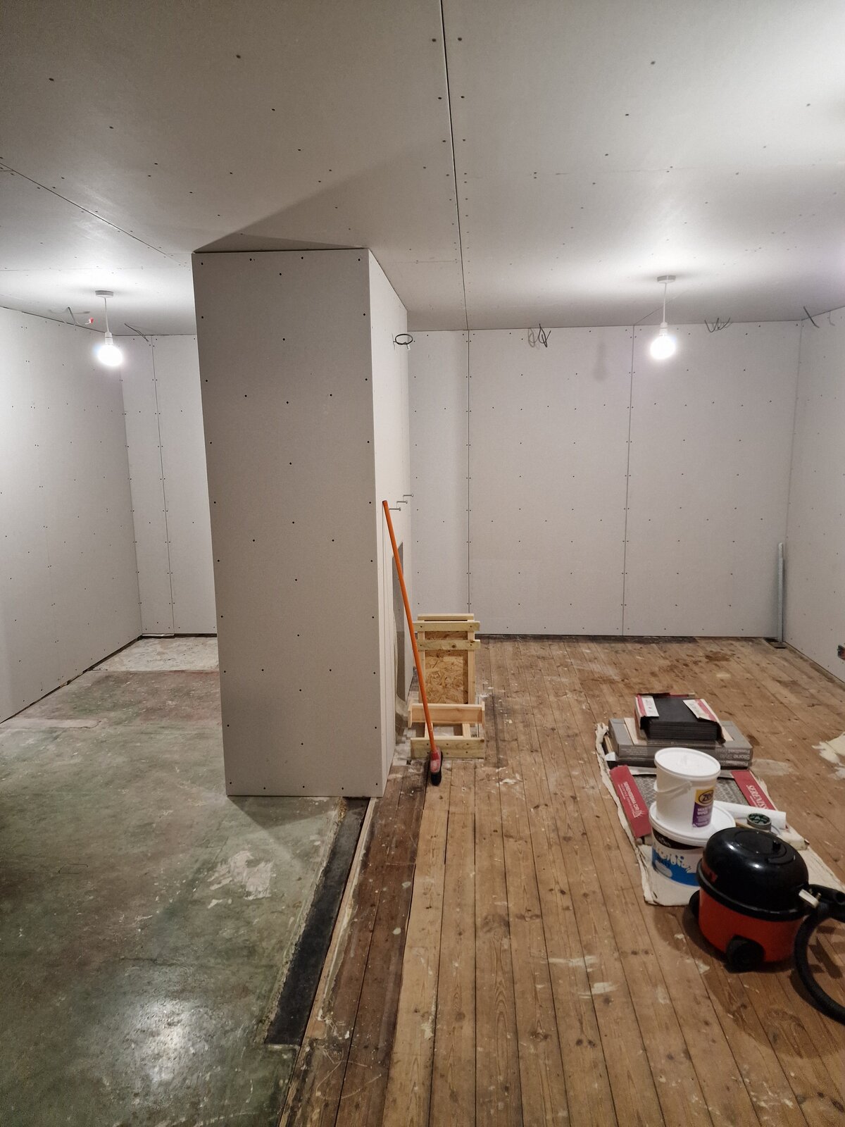

Looking at some of those pictures I think the plasterboard can’t have been straight/level/flush before any plaster hit those walls…
I'm an self-confessed, anally-retentive, ex-chippy. The stud work, battens and boards were fitted to perfection. Took a long time, but you could have calibrated your tools off those walls before the plaster went on!

I'm a self-confessed, anally-retentive, ex-chippy. The stud work, battens and boards were fitted to perfection. Took a long time, but you could have calibrated your tools off those walls before the plaster went on!

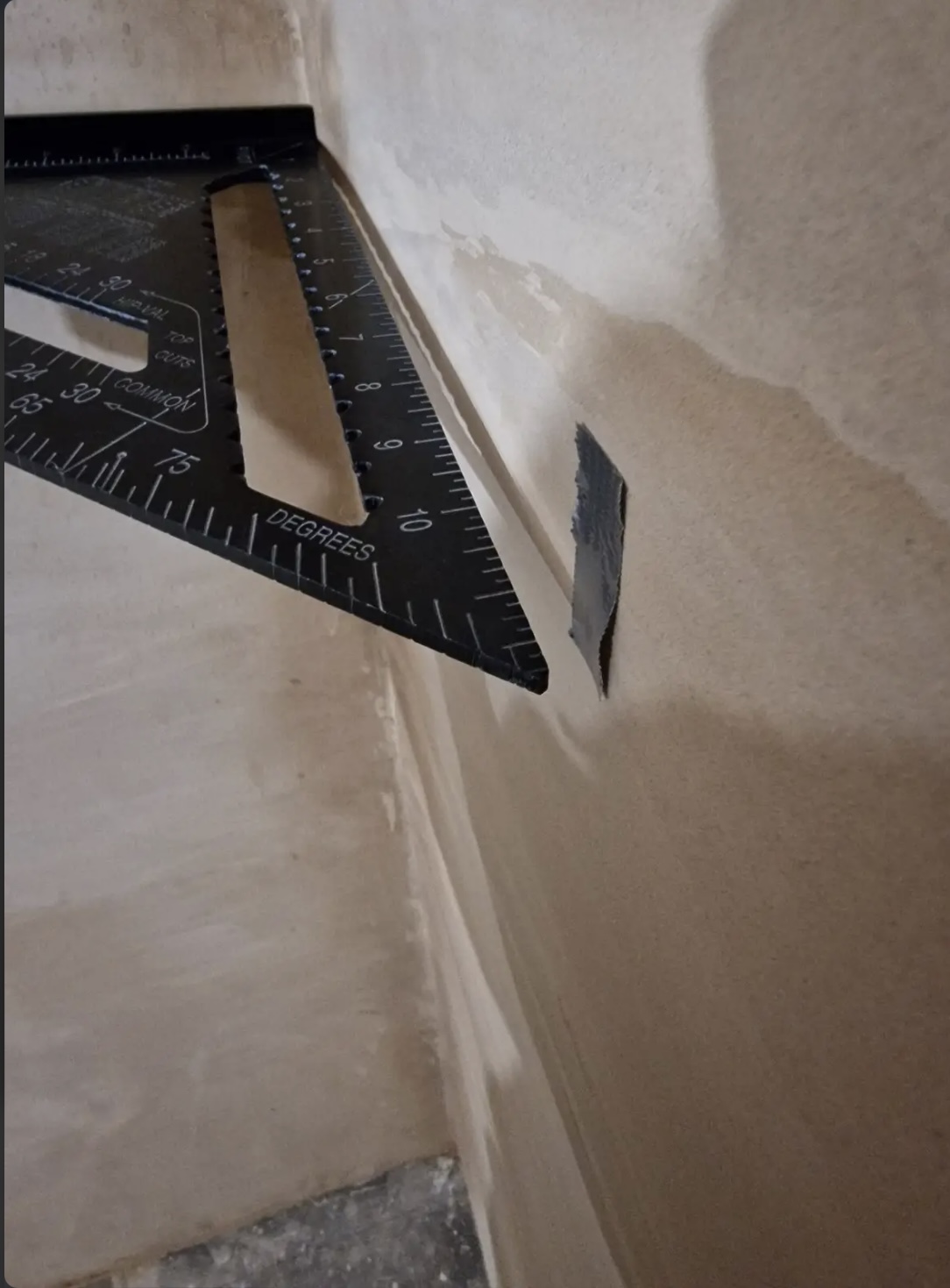

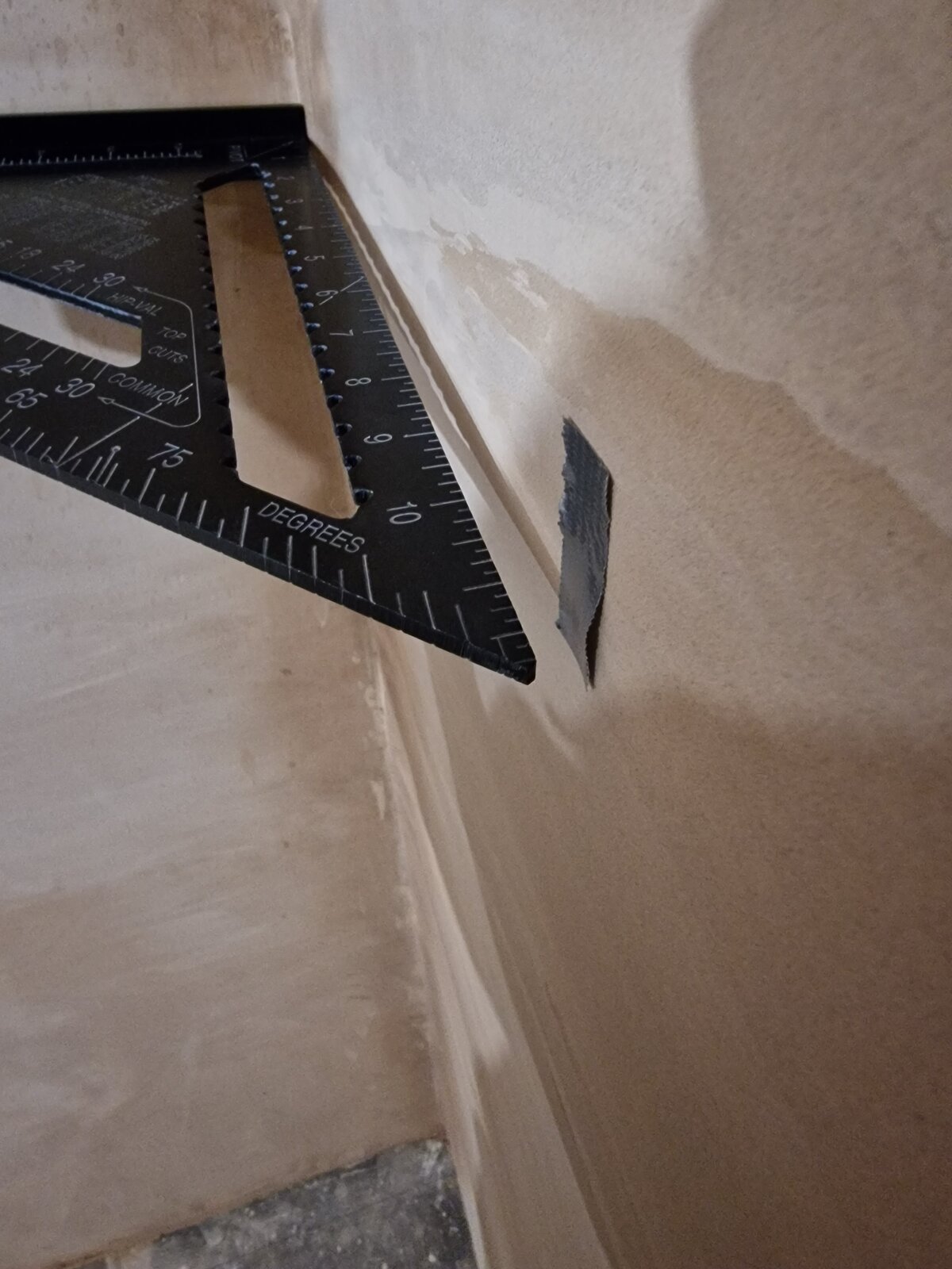

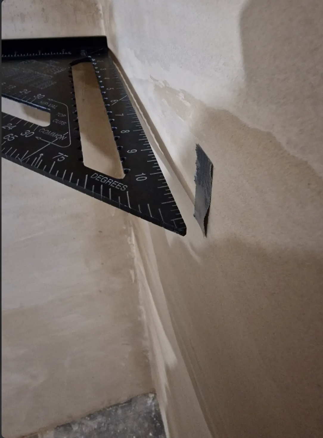

Ok, but it would have taken a very high degree of skill to get that corner (with your square on it) to be >10mm out of square and still maintain a relatively flat surface with multi finish.
Similarly, you can see very straight angles /lines where the PB joints are, that look like they’re not flush.
Don’t get me wrong, doesn’t look like a great job either way by the plasterers.
For sure it's an awful job but surely if all the walls were boarded it was only a skim coat? It seems difficult to achieve those levels of inaccuracy with a skim coat.

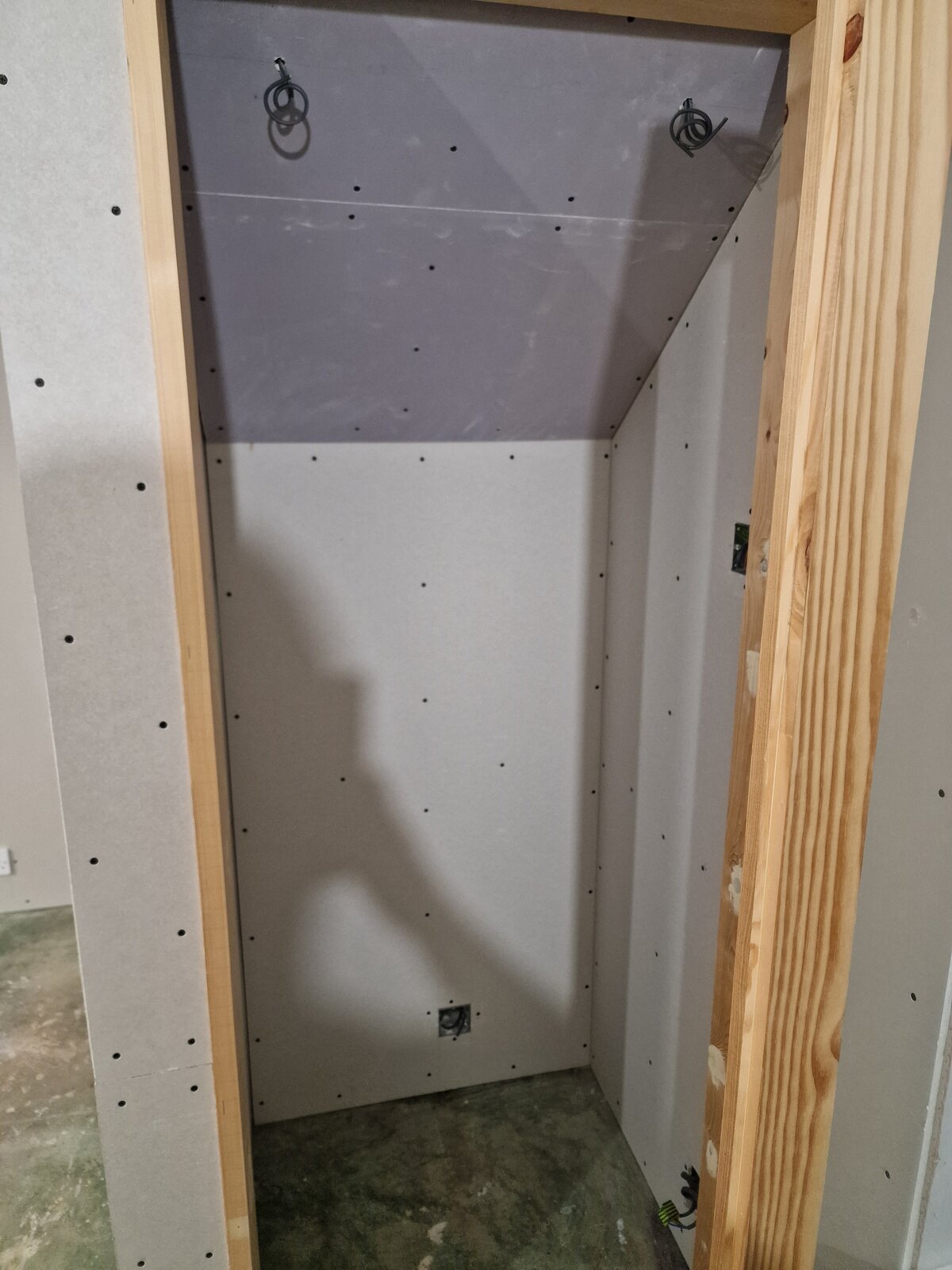

I can assure you otherwise, everything was 'bang-on' in square, straight and plumb with correctly screwed and flush boards.
For example, where you have skillfully noted a plasterboard joint that is not flush, there is no plasterboard joint - please see the 'before' pic!
If you would like, I can drag out some more 'before' photos for you to expertly critique, or can we just blame this one squarely on the gash plastering?
No idea how they managed it, but was boarded all around and over!
