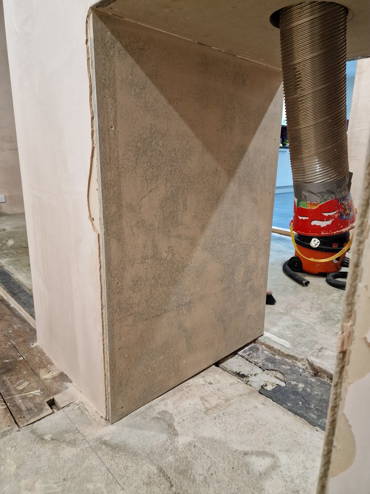

That is some shoddy work and it looks like the tradesman has gone off and left the apprentice to do the job
The work is much better than the first wall I tried plastering, but that’s a proper low bar anybody plying for trade as a plasterer should be able to achieve a decent finish.
And I didn’t accept what I did, I put SBR on the wall and did it all again, it ended up slightly less sh1t and I filled it with easifill and sanded flat. End result was a dead flat wall when painted.
Made a start on chipping the Thistle Hardwall from the inside of the fireplace. Despite it having to come off anyway due to not being even remotely suitable for the inside of a fireplace (49°!), it almost fell off by itself.
"When I confronted the original plasterer, I gave him several opportunities to get the work sorted, but he just stood there looking shocked saying "What do you want me to do?" When I replied "I'm not a plasterer, what do you think you can you do?", he just repeated over and over "It's within tolerance, what do you want me to do?"
What are you actually gonna do here? Why not get some stone or some proper fire rated board and affix to sides. Whatever plaster products you have will need painting and maybe the heat with the paint will be similar issue
The background is already A1 rated cement board. For some reason the cowboy decided to skim it with Thistle Hardwall which is not fire rated, so it would have had to have come off anyway. The stuff almost dropped off in places as I scraped it off yesterday. Don't know if a surface prep is required on this stuff, but as you can see, there is none anyway. Incidentaly, the corner beads were stapled on and they fell off too.

I'd drill a hole in the area's where it is not level just to see how thick it is in places.
You can then make some records, evidence of how unsatisfactory and below standards the workmanship is!
That's a good plan - may help if the 'plasterer' wants to take things further.
