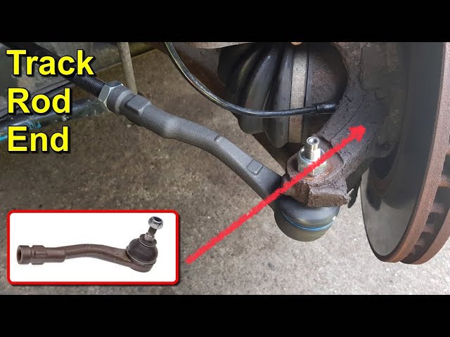

Repairs going ok, so far. Only a couple of hitches. The tie rod BJ is really in there. Tried tapping on the threaded part with the nut near end of thread to protect it. Then tried banging the side of the casting where the BJ sits in to shock it out, but no joy, don't want to use more farce otherwise I'll be shopping for a new track rod end. Off to Machine Mart tomorrow to get a decent BJ seperator.
I've never ever used a BJ separator in nearly 50 years of fixing cars. You'll be very lucky to tap it out by banging down on the thread as there will be too much flex in the arm which absorbs the shock. A good shock with a steel hammer (not copper) in THE RIGHT DIRECTION has always sorted it for me. Must be in the right direction along the length of the track control arm otherwise it flexes and the shock impact loses its effect. I could guarantee you that I could get that rod end out in no more than three whacks. Hit it like this and it will just drop out:
It's only ever been one hammer for me.
I've never used a separator.
I've actually had a track rod end come away in my hand, the ball came out of the socket when I was checking for wear.
Thanks again to everyone for their invaluable knowledge. Will give it another go with hammers to save the boot. Was worried I might break the casting if I went too mental.
When I replaced the broken spring on other side about 4 years ago, the ball joint came out with one or two feeble taps. This ball joint doesn't want to, er, play ball. :(
