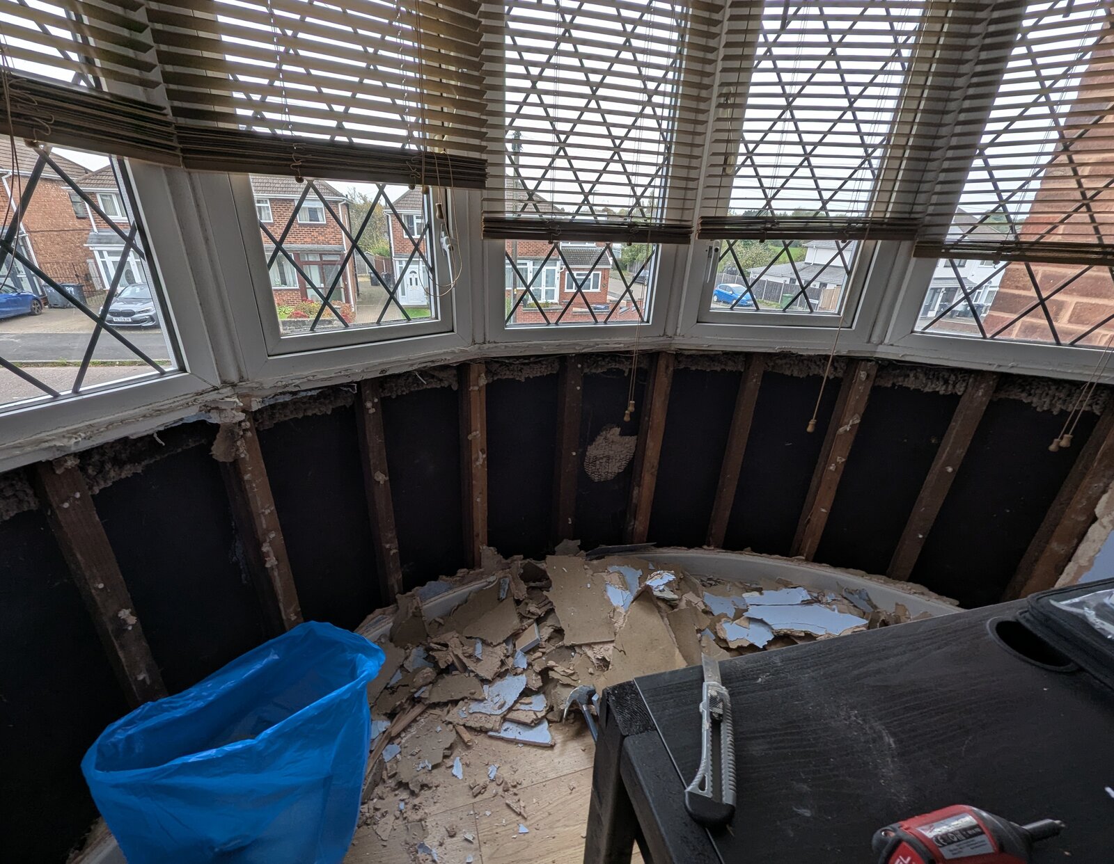

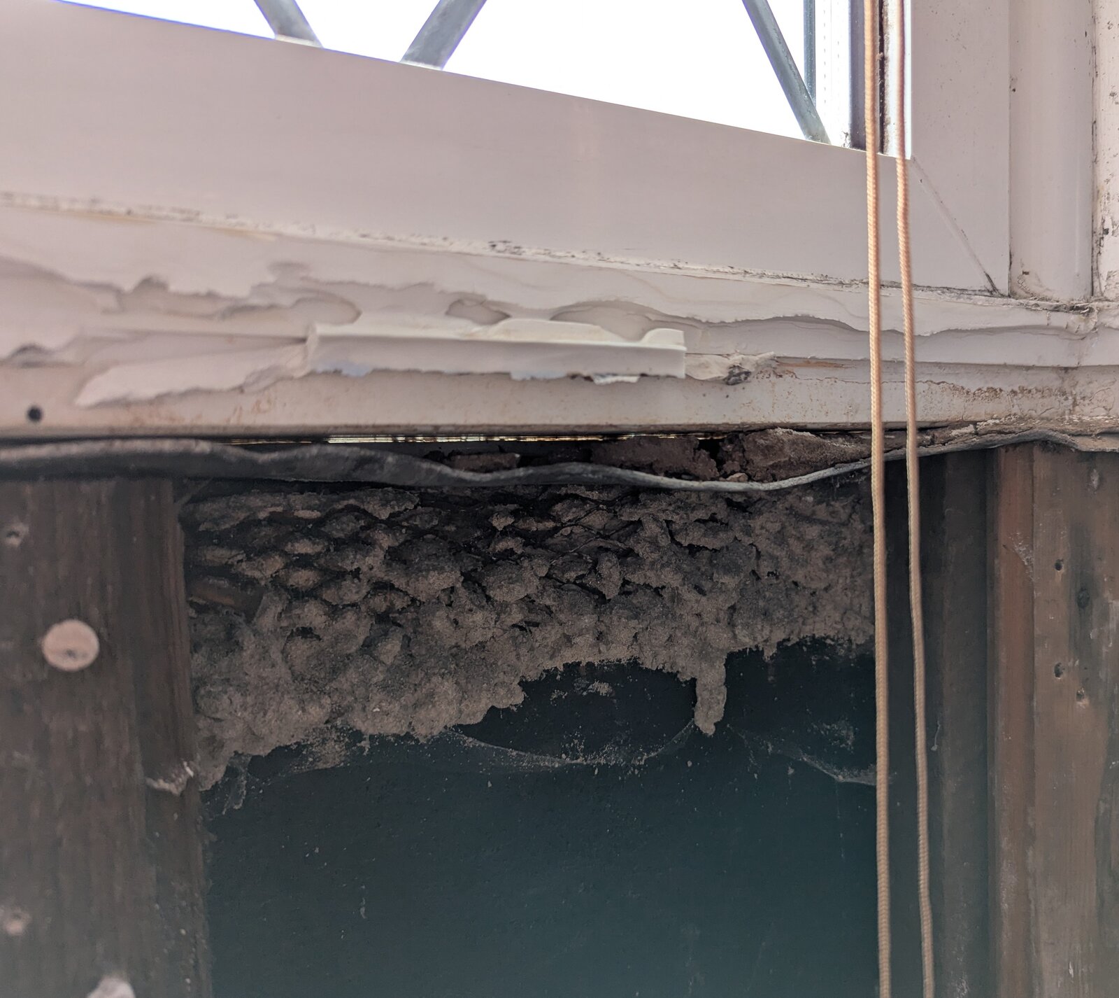

Hi all, finally got around to starting this. Please see photos.I will hopefully be doing it in 2 weeks when I'm off so I'll check if there any and post on here.

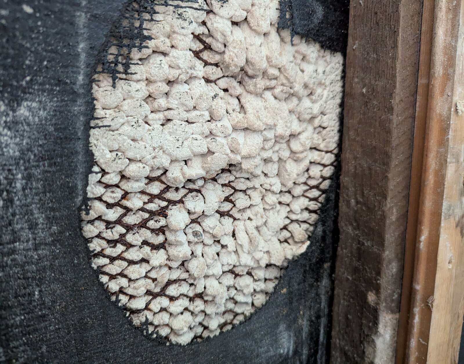

It was me that cut away that section in the black felt to see behind. If i was to want to check all the render i would have to cut away the rest. I was thinking that as the felt looks like it's in good condition so hopefully the render is too, just to repair the hole i made with something like breathable membrane then do the rest of the things you've said but not to have to do the sand and cement bitThe metal mesh (expanded metal lathing) and black roofing felt look like a fairly modern repair. I don't know what caused the hole.
If it was me, and I was working from inside, I would brush and hoover away all dirt and dust and use a timber preserver, then patch any gaps in the render with sand and cement, brushing on PVA solution first to help it bond, then staple roofing membrane to the timbers so that any penetrating rain runs outside, then fill between the timbers with mineral wool insulation, then apply an insulated plasterboard to the face of the timbers, skim or fill, and decorate.
