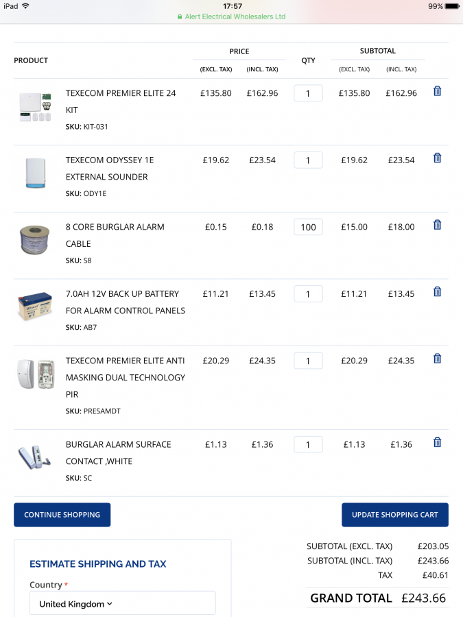

Right I've gone for the texecom which sparky recommended (THANKS SPARKY!). I've chosen next day delivery, so hopefully I should get it by thur, allowing me 2 days to read up and test the system before doing the wiring over weekend.
If there are any manuals/guides or links you can recommend, then that would be much appreciated.

The excellent kit I've gone for was recommended by sparky:
image-png.99454
8 core, 1 device 1 cable.
the door contact, has no rear tamper, but 4k7 resistor across the reed(silver terminals) the a 2k2 from one of these silver terminals to a spare brass terminal, wire back to the panel brass one end silver the other.
Wire to zone 1.
don't know which devices are going where, but if the keypad has a pir covering it, then wire that pir to zone 2.
The rest doesn't really matter.
the compact IR, wire power back to the panels AUX+- and first alarm terminal and last tamper terminal (diag/section 9 on the Compact IR), use the jumpers to select 4k7 Jp3 alarm and 2K2 jumper tamper. diag gram/ section 6.
the antimasking PIR, should have option A board already in if not insert that out of the pack provided, wire power to aux +- and EOL terminals to the zone, in zone setup change the wiring type to TEOL (triple end of line).
the com 2400, plug it in, wire T and R to the phone line and wire the earth to the earth to the mains earth.
You can wire the panel with a plug but a fused spur is better but that will depend on your skill set. remember mains can kill and you should ensure its isolated and safe to work on.
Keypad, just wire the network terminals and wire the same in the panel
The bell box, wire same at the bell and panel ends ABCDS, it can help if you take a picture of this, so you don't have to go up and down the ladders double checking which wire went were.
switch the battery jumper to the on position, close and seal the unit.
Don't connect the battery until everything else is done, it will help you short term, just make sure the wires are tidy enough to allow enough room for the battery.
Texecom have a you tube channel with a video explaining what to do on first power up.
Before powering up you need to be aware that unused zones will show up as in tamper when you do power up and the lid tamper may show if you have thelid off as will any other faults, enter the default engineers code until you gain access to the engineers menu.
