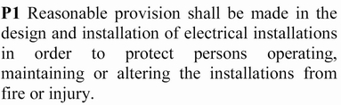

Part P says nothing about that. It just says:
upload_2017-4-24_23-20-37-png.118103
It makes no mention of protecting property from fire nor does it mention protecting a person who is in the property but is not operating any switches or any other part of the installation. It seems to suggest that injury from touching a switch is acceptable but injury from operating the same switch is not acceptable.
To me this is one reason why common sense and knowledge of hazards is more effective in protecting people and property than a book of bad written rules and guidelines.
