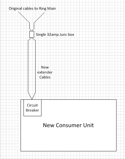

There are 2 mains rings and 2 lighting circuits, 6 Tw/E cables. The lighting circuits are straight-forward enough, but, would it be acceptable to have the feed and return from each ring main to go through a single Joint if I had two extender cables coming out to the new CU, as below;
or does that contravene regulations by creating a pinch point and some potential problems with earth currents or some such?

Extend the ring final tails with a junction box for each one.
would it be acceptable to have the feed and return from each ring main to go through a single Joint if I had two extender cables coming out to the new CU, as below;View attachment 97924
Why use 2 cables for the extension? //www.diynot.com/diy/search/5250483/?q=lollipop&o=date&c[node]=8
I have to say that those notions do not betoken anywhere near enough basic knowledge for you to be doing this work.

The extender tails will run for about 2m-2.5m as described above, I can't make the lollipop search link work but are you suggesting that I use only 1 tail from each closed ring to the CU?-? (I'm inferring from the term lollipop)
And you might be right, I may lack a little knowledge but then I'm not 17th edition qualified. There is a difference between what will work and what will be considered to be an acceptable installation. I certainly have the skills though, and the information and knowledge is gained through such conversations as these.
