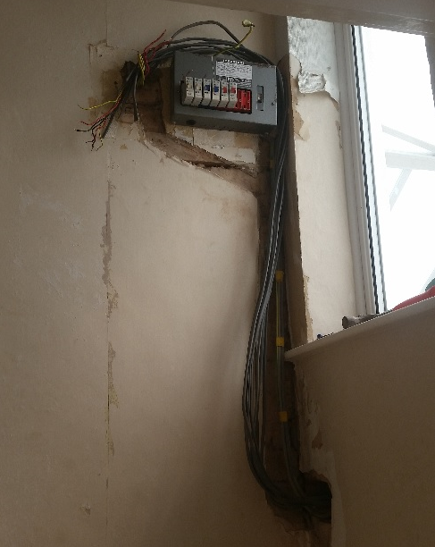

I'm going to continue the rings as you suggested. Now I have a pic, when I said
the cables pop out of the wall to go to the CU at the moment and then chase down the corner to disappear into the (currently empty) electricity cabinet, so creating a safe zone/danger zone by using specifically a blanking plate(accessory, installation is not necessary.
The ring circuit cables disappear into the cavity through a gobbed up hole in the brickwork that I intend to remove to install the enclosure for the joints. Metal box, metal lid, under an inconspicuous removable panel.
