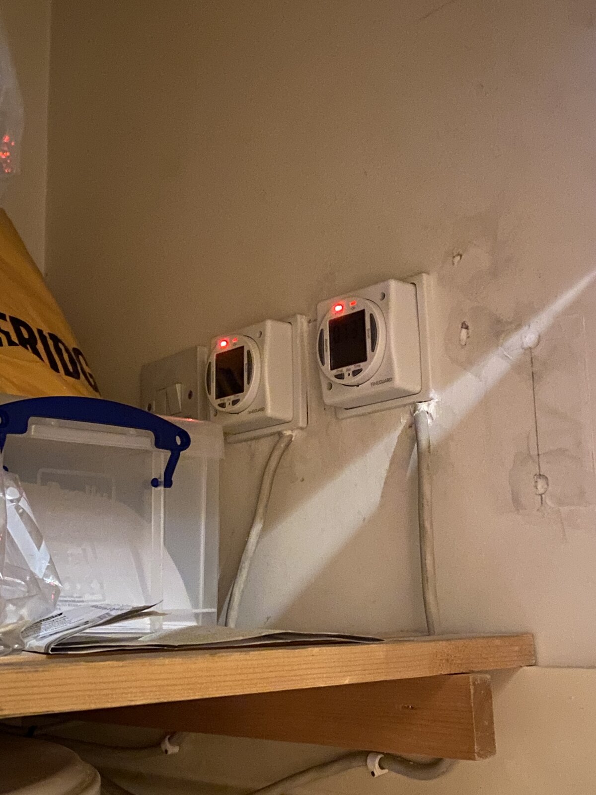

Yesterday I swapped my RTS meter (two rates-Economy 9) over to a Smart Meter as I want to be on a one rate tariff; my radiators are electric and I no longer have storage heaters & my only appliance that is currently on economy nine is my thermal store that heats my water.
When the thermal store was installed, I was on an economy 9 rate/tariff. I had two Timeguard timers installed that are connected to the thermal store; the timer on the left was my off-peak supply (till yesterday) and the red light was always on-indicating it had power supplied to it. That timer was connected to my lower (off peak) immersion, and the right timer was for the "boost" on the 24/7 supply and that is connected to the top immersion.
When the electricity company meter guy came I explained that I want to keep my off-peak supply *live*, but moved over to a 24/7 supply. My electrician told me to tell him that "I want both meter tails put on the 24/7 supply". He assured me that he had done just that.
However shortly after he left I went into the cupboard where the thermal store is and noticed that the red light on the left-hand timer was faded; it was not on (indicating that there was no power to that timer). The red light on the right hand timer (24/7 supply) was red-indicating that there was power coming into that timer.
So as far as I'm aware ,yesterday there was no warming up of my water from the lower immersion-the old off-peak supply. However this morning when I woke up, I checked the cupboard and lo and behold the red light on the left timer was on, so I thought problems solved.
However, an hour later I went into the cupboard again and saw that this light was off again, indicating no power to the left timer. Although I have my left timer programmed to come on at certain times, the immersion doesn't kick in at those times (since yesterday); the water wasn't warming up yesterday during the times I've set the timer to, and it hasn't been warming up this morning at the times at the time was set to. I do not know what caused the red light to come on this morning but somehow it has gone off again.
Having done my own research this morning looking at various articles online and different forums I'm questioning whether the timer (Timeguard) that I have connected to the off-peak is the right timer now that I'm on one rate/tariff. I can't help but think that the answer to my issue lies somewhere in this thread, but I can't make head or tail of this:

My situation is this: I currently have two timers connected to my thermal store that heats my hot water. When I was on Economy 9, I had my Off Peak timer come on 2-3 times/day at the cheap rate times. I never had any need to use the Boost (top immersion-connected to the timer on the right).
Now that I'm on one rate/day-do I *need* two timers? I do want to retain the boost function, just in case I never need to use it.
But I am confused as to why my left side timer (that was connected to my old/former Off Peak supply) is not getting Power (consistently) when it was supposed to be put on the 24/7 supply?
Is the timer that I have not compatible with a one rate/day tariff?
Photos are attached-one from last night when only the red light on the right timer was on, and then bizarrely, both red lights were on this morning-and not at a time that the timer was set to come on. And an hour later the red light on the left timer went off again.
If any of you have a clue as to what went wrong when my supply was moved from Economy 9 (two supplies) to one, please advise. I'm trying to get my electrician over on Monday.

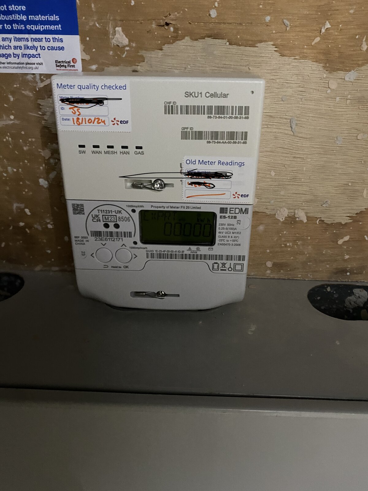

Some smart meter have two outputs, others have one, and the supplier can with two output type switch the second output when they want, so could be on 24/7 or could be switched off at some times of the day.
So the question is has the meter 4 or 5 wires coming from it? I will guess 5?
Thanks very much, Eric-yes, it has 5. In fact, the meter guy was very clear in telling me "your former meter had 5 wires, and the new one also has 5"-he said he was swapping a like for like. Strangely though, when I logged onto EDF's website and checked my new tariff details, for some reason it states daytime/nighttime, whereas in the email they sent me it confirms I'm on a one rate/day tariff. I've emailed them to ask the Q. because I don't want two rates-I specifically asked for one rate/day.
So, given what you wrote, what does this all mean re-how my timers are working? (or not, as is the case for the left one, which used to be my Off Peak and should now be on the 24/7 circuit. :unsure:

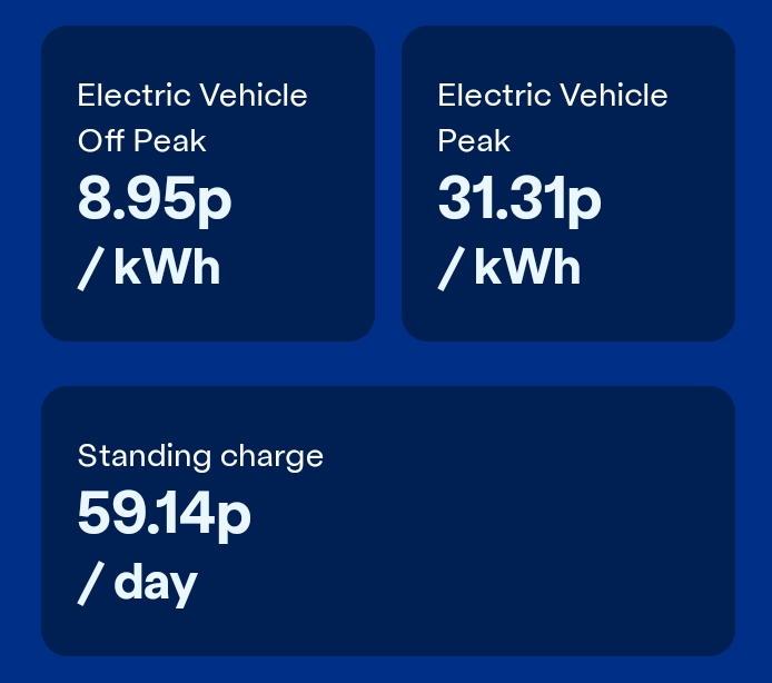

The old economy 7 had a white meter, and the supplier was responsible for the times when off-peak was supplied, this resulted in not getting the off-peak rate for using the washing machine, tumble drier, and dishwasher overnight. So in latter versions, the timing was left to the user. This is what I have, with an EV tariff which runs midnight until 5 am, although they have not said if that is BST or UTC, so I only use it for 4 hours.
The split tariff, resulted in a lower standing charge, and a higher peak rate, now 31.31p per kWh was 28.something can't remember exact amount, but off-peak dropped to 8.95p per kWh, and we hardly use any peak power, the solar panels and the batteries, mean in the main we only use off-peak.
The supplier can remotely change the off-peak output, and make it run 24/7, and they will also have an app for the phone. Mine shows me energy used in both kWh and £, and my average for September is 16.1773p per kWh, so with the app very easy to see if single or dual tariff works out cheaper.

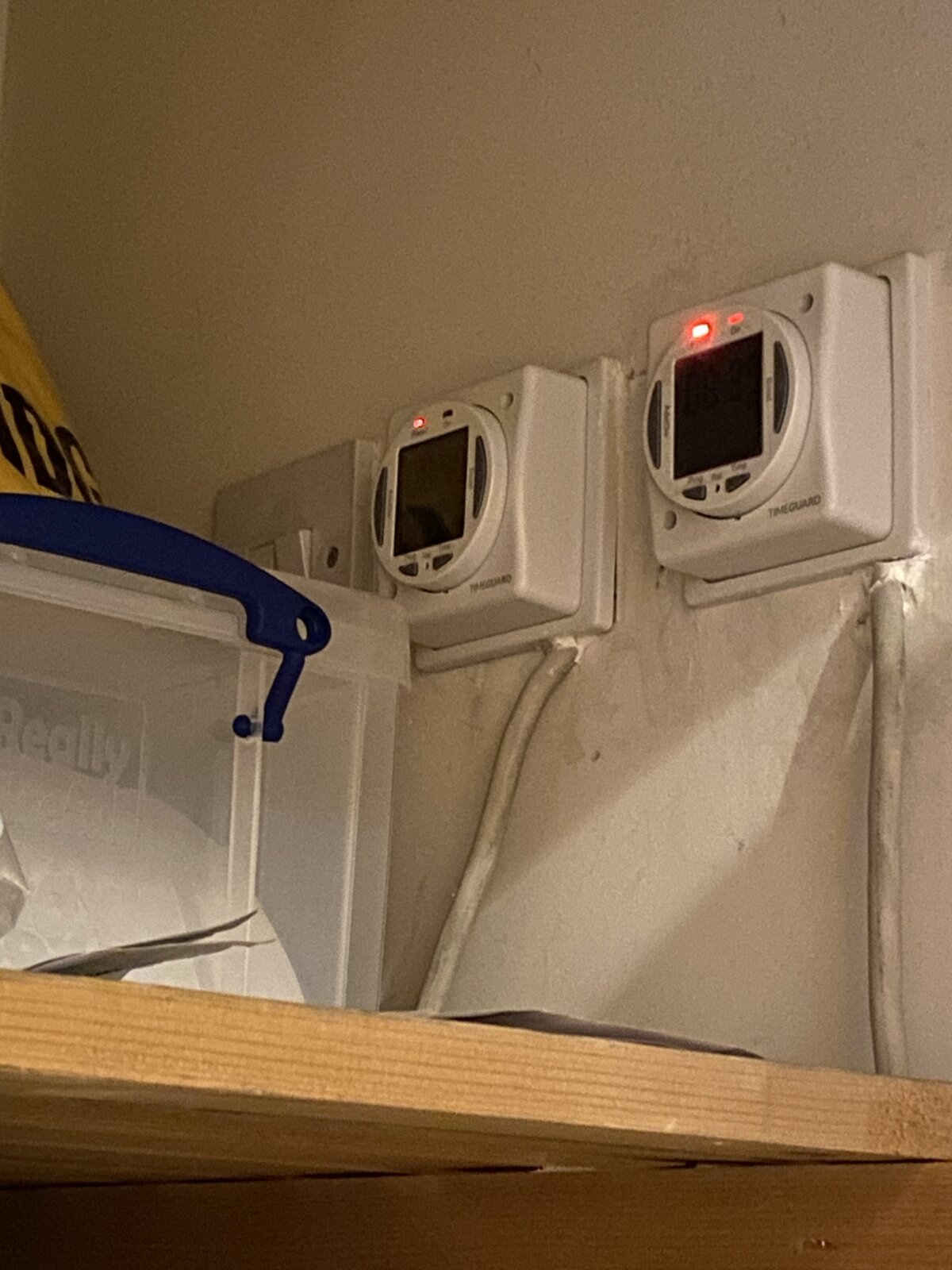

Update: yesterday AM and this AM I opened the cupboard door where my water cylinder is (yesterday at 6:40AM and this morning at 6AM) and both red lights on both timers (what was my Off Peak timer and what is my 24/7 timer) were on: so I know that my Off Peak timer is getting power to it. As of 8:14AM this morning the red light is still on the (former) off peak timer, but yesterday at 7:40AM it was no longer on. My issue now is that the (former) Off Peak timer/immersion that should now be on 24/7 supply is not coming on at the times I've set the timer for. It is coming on in the middle of the night/early morning and I don't know what time it is coming on, because I'm asleep pre-6AM.

When my supply was Off Peak (left timer) the timer worked fine-it came on at the set times and did *not* come on at any other times. This allowed me to control how much I spend on heating my water.
But given my water cylinder (thermal store) is coming on in the middle of the night, and not coming on when I have set it to-I am just not understanding why this is. EDF had strict instruction to feed both meter tails (Off Peak and Peak) into the 24/7 supply so that my (former-pre-Friday) Off Peak supply is now on 24/7 supply.
What is happening overnight is something I just can't understand.

a) whether I do have an Economy 7 meter-is there any way I can tell on the meter itself or do I need to ask EDF?
b) does having an Economy 7 meter prevent me from being able to use the Timeguard timer?
When I was on Economy 9, I was able to program the timer to come on for an hour here and there.
But at present, the former Off Peak supply is coming on overnight and *not* coming on at the times it is set to vis a vis the timer.
1) Does anyone know whether the below meter *is* an Economy 7 meter and if so, what are the implications of having an Econ 7 meter if I want to rely on my Timeguard timer to control when my thermal store heats my water?
2) Can anyone advise please as to what I need to ask EDF tomorrow? I honestly don't know what "set up" they have left me with.

Yet another update: I believe what EDF have done is moved me from an Economy 9 to an Economy 7. I've just emailed them to ask if they can switch my smart meter out of Econ 7 mode....apparently they can do this remotely but what I don't know is whether that would also put my existing Econ 7 supply on the 24/7 supply which is what I had been asking for all along. *I* want to be able to control when my water cylinder heats up-but I've figured out myself that is must be on Economy 7 (Off Peak) right now and *not* on the 24/7 supply-which explains why it comes on overnight and by 8:45AM the red light on the Off Peak timer is *off*. :rolleyes:

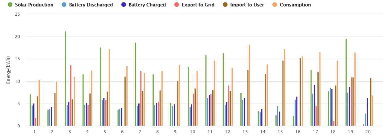

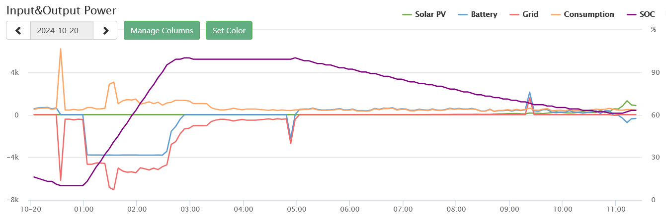

Unfortunately the smart meter is rather dumb, it tells one very little, my software shows 1729419658995.png each day import, export, how much in/out of battery, how much solar, and how much I have used, and each day I can see how it has gone, 1729419854702.png I can see my battery charged over night, until 5 am, and then it has supplied the house until now, and at this point I am starting to recharge the battery, getting 850 watt from solar, and using 431 watt, so rest going into the battery, smart meter app is two days behind, so rather useless. Since neither drawing or feeding power into the grid, for most of the day, the in house display (IHD) flits from import to export all day, but needle stays at zero. And meter is so complex to read, not a clue what it is showing.
