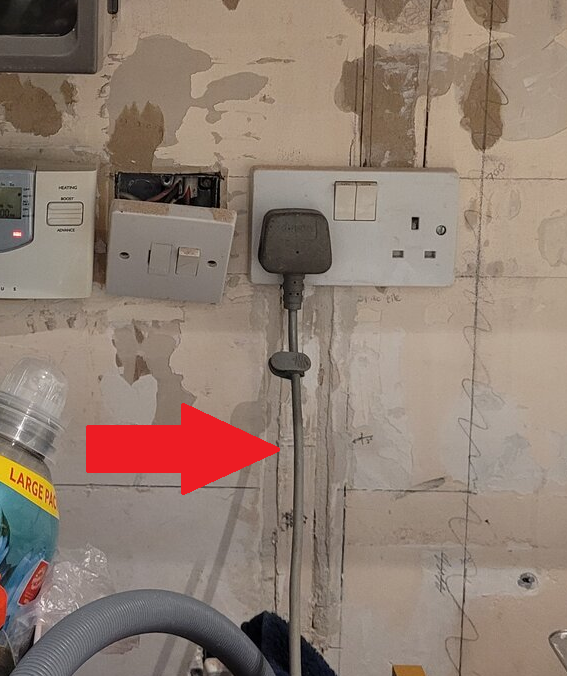

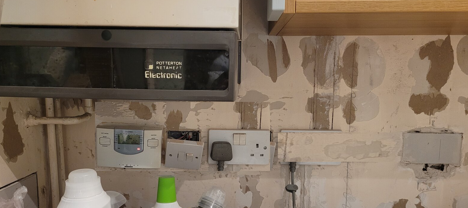

We have altered our utility room slightly and moved the sink into the middle. I now need to move one socket over to the left side underneath the boiler. Problem is I can't drop the wires down vertically from above as the boiler is in the way.
In the photo you can see where the socket is and I want to move it onto the other side of the boiler switches.
I know I could put a blanking plate over the old socket area then run the wires horizontal but would rather not have a blanking plate.
It’s a utility room. Use the option with a blank is the option BUT any cables will be outside zones , which isn’t a good idea
It appears to me that this:
is some for of trunking to the socket from below.
