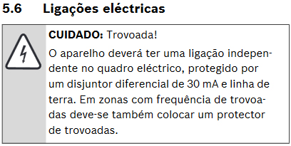

Of course, it is difficult to prove a negative but here are the instructions. Note '3A' is the same in Portuguese.
https://vulcano-pt.resource.bosch.c...4_3/imesquentador_click_ventilado_wrd-kme.pdf

It does seem 30 mA RCD only, it says
CAUTION: Thunderstorm! The device must have an independent connection to the electrical panel, protected by a 30 mA earth leakage circuit breaker. In areas with frequent thunderstorms, a thunderstorm protector must also be installed." followed by.
The device is equipped with a three-conductor cable (phase, neutral and earth) with a cross-section of 1.5 mm2 and a suitable plug. In this way, the socket to which it is connected must be earthed. Preferably, the circuit of these sockets should have a two-contact circuit breaker (phase + neutral).
Connection to electrical panel
If you want to connect directly to an electrical panel and need to replace the cable supplied with the water heater, you should do so with a similar cable, and preferably reserving a two-contact circuit breaker exclusive to the water heater in the panel. check that the appliance is properly grounded in the control box.
So it seems it does not ask for a fuse in Europe so installers are not going against any manufacturers instructions fitting European models with external fuse. And a hunt for English version quickly shows this boiler is not marketed in the UK, there is a different version for UK so what is required in Europe has no bearing as to what is required in UK they are different products.
