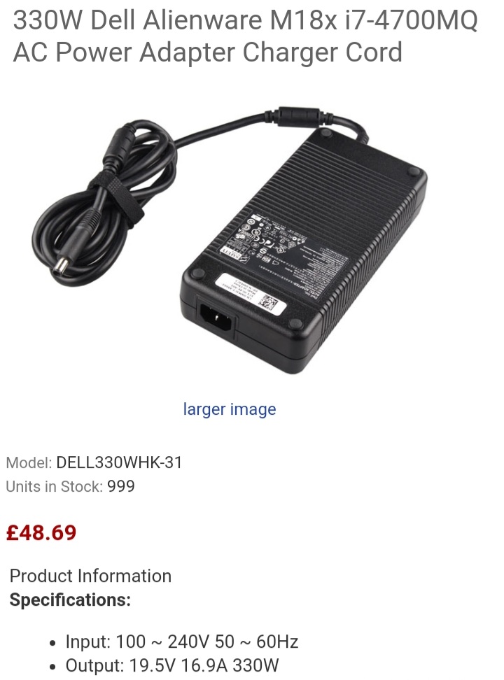

Unless it's an Alienware! ;)

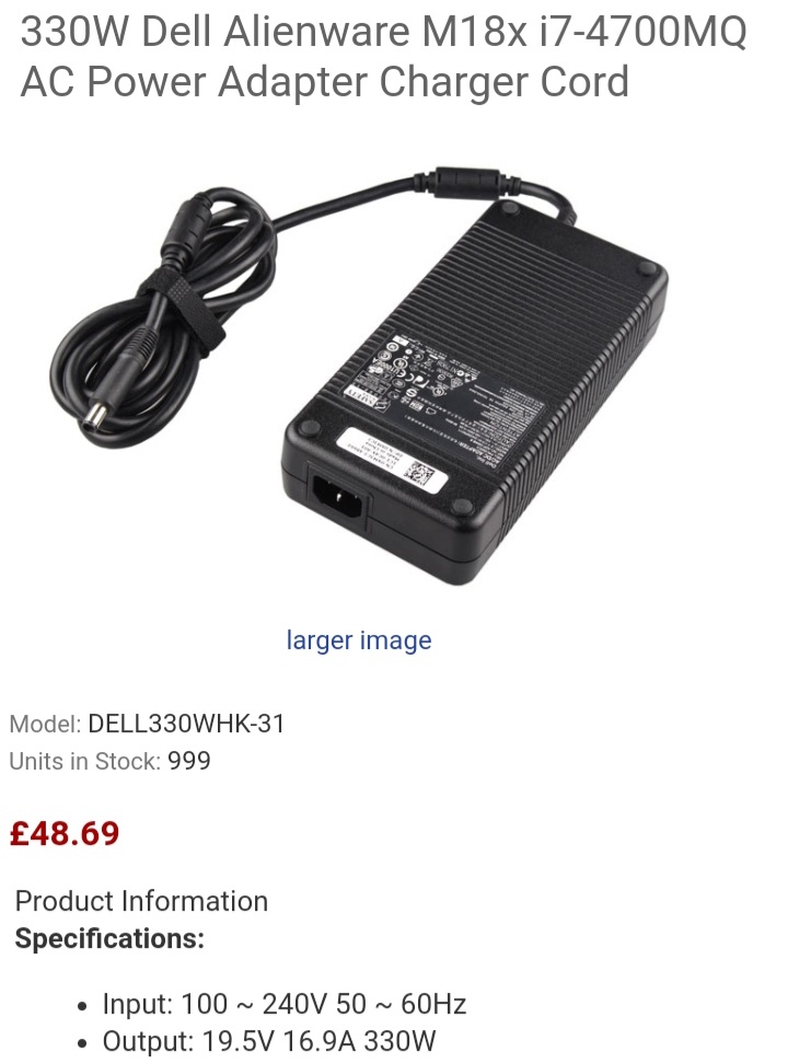

hear is what I have but mine is only half the size of it
it uses a lot of power just to run nothing though. the guy with the unit at the end of the street dose camper vans up and one thing he recommends is to use a house hold fridge with an invertor, he says you wire it off of the termostat of the fridge to the DC out put of the invertor so when the fridhe wants to run it will switch on power to the invertor and when the fridge wants to switch off it will switch off power to the invertor (how he dose this i do not know! dose the thermostat on the fridge put out a circuit or no circuit when it tries to switch on, what kind of swithc on the DC side he has in mind i dont know)

hear is what I have but mine is only half the size of it .... it uses a lot of power just to run nothing though.
Particularly if it's fairly small, it must therefore get pretty hot when it is 'doing nothing'? Does it have a fan?
