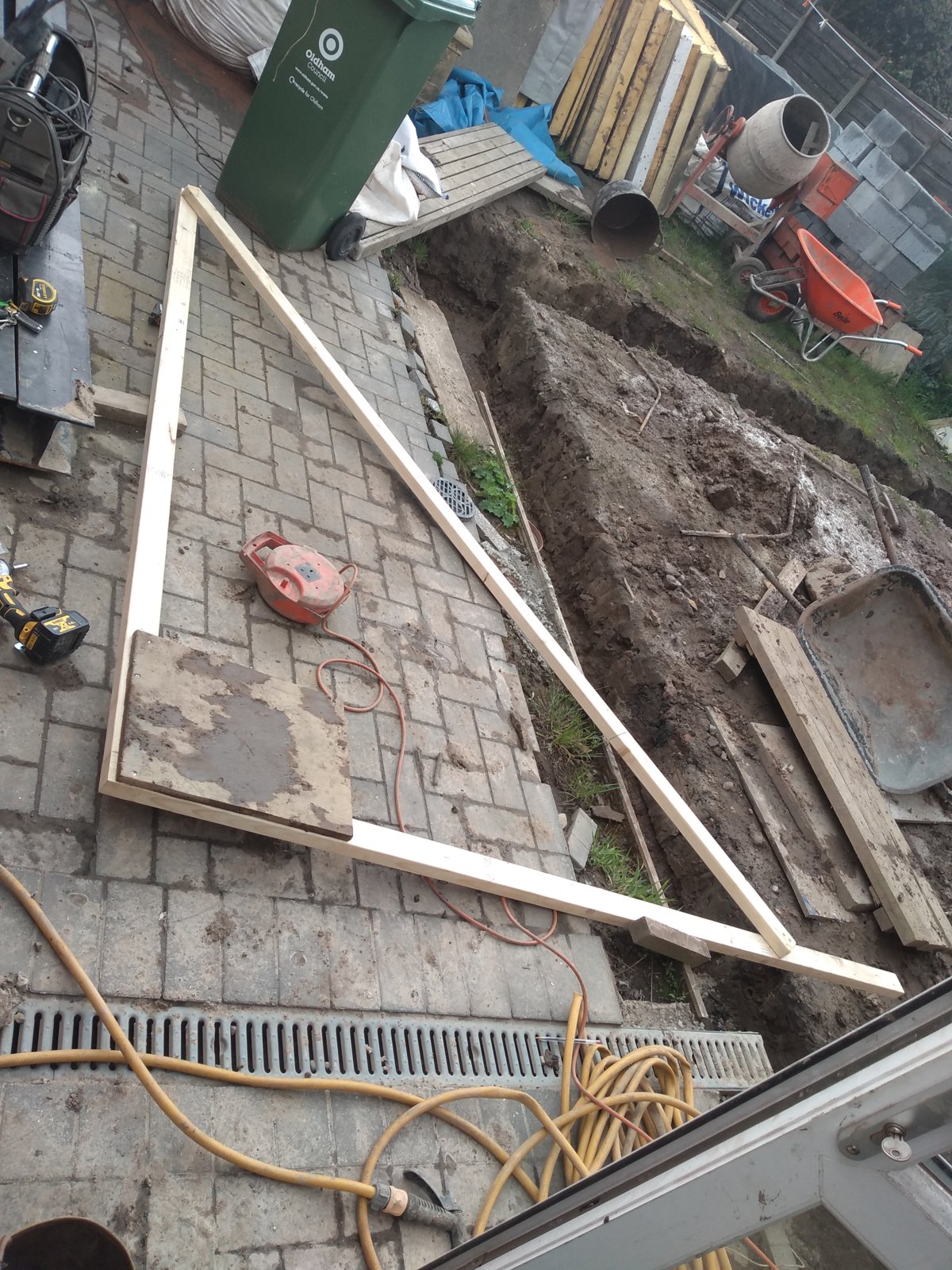

Just a quick update - slow progress due to clearing spoil, bringing in materials and some trench flooding/collapse to deal with!
I've made a big 3-4-5 triangle to square off the extension and got it to within 10mm over the 5.5m length - good enough for me.
Then finally some building, first course of blockwork - a mini milestone for me.
Thats a good traditional method -10mm is pretty good.
Just a tip for anybody - the most accurate method is to use triangulation......use a tape measure to set the diagonals, use as many points of reference as required to check.
Every dimension can be broken into a right angled triangle.
