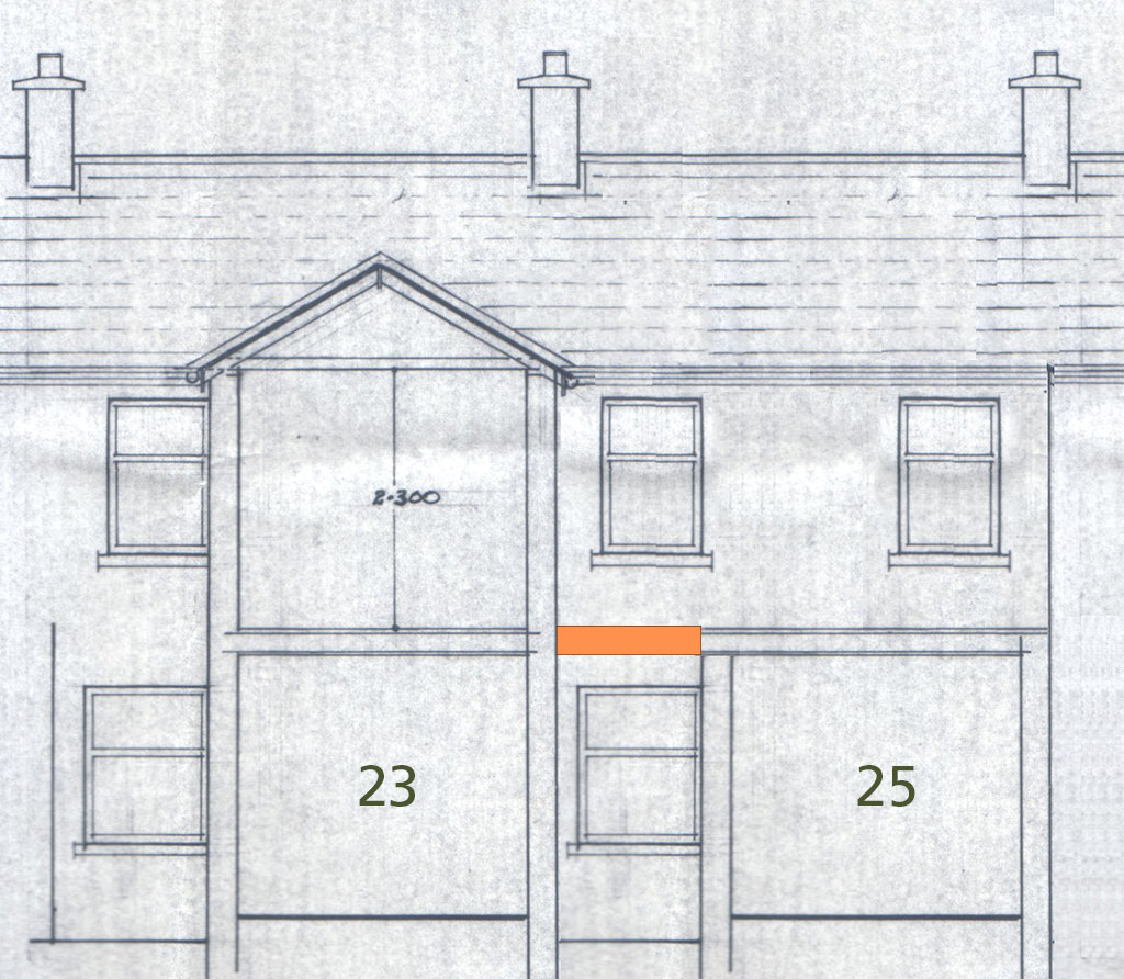

Comrades, my next-door neighbour happened to mention that, maybe next year, he intends installing decking over his wee back yard and possible over his single-storey extension.
He said he intends to connect his joists to my extension (23) on one side and to his extension (25) on the other side of his yard - see image (joist indicated in orange). The image I've uploaded is from the own plans for my extension years ago.
Do you reckon he has any right to do this if I don't want this structure attached to my house?
No, he has no right, as far as I am aware.
It's your property, write to say sorry, you do not give permission.
Also, that isn't decking, that's a balcony surely? No permitted development rights for balconies, would need planning.
Guessing he is hoping to make some sort of roof terrace with a door replacing a window?
The only chance he's got is if you built right on the boundary line.
And even then, would be difficult for the council to approve.
As mentioned, this need planning permission being a balcony.
Balconies are highly contentious and require PP and BR. The regulations associated with the balcony safety railings etc, are also quite strict. He'd be expecting to fix the rails to your wall, so I'd say it's a non started from the outset.
He may be able to build it free standing but would still require PP.

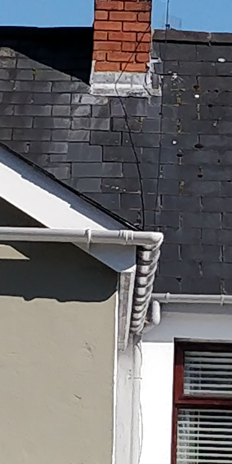

The consensus is that, apart from the almost possibility of getting the project past planners and building control, he needs my permission to connect his joists to my wall. In terms of the wall, there's doubt as to whether it's a party wall or not with one contributor suggesting that the centre-line of the chimney is the boundary. If that definition were to be true, my outside edge is plumb with that line - see pic.

There's no doubt. Its not a party wall as its not separating rooms between dwellings. And he cant make it a party wall either.
The permission he requires is one of basic property law, fixing to (ie interfering) with your property within your property boundary, and that needs express permission from you - which if you follow the legal principles becomes an easement or a licence for the right of support for the neighbour's structure.
