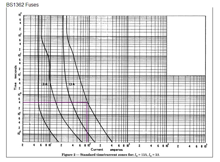

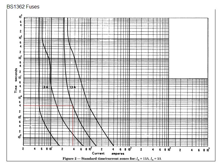

I don't think the arithmetic supports the feasibility of the scenario you are postulating ... to get 0.4s disconnection time (i.e. assuming TN installation), a 13A BS1362 fuse requires a current of about 36A. With a Cmin of 0.95, that equates to a max Zs at the end of the extension lead of about 6.07Ω. Assuming the extension lead is fed from the 'highest Zs socket' on a circuit protected by a B32, which has just a low enough Zs (i.e. 1.37Ω), that means that the maximum (R1+R2) at the end of the extension cable (max for EEBADS) would be about 4.70Ω (6.07Ω - 1.37Ω) - which, if the extension cable were 1.25mm² flex, would equate to a maximum permissible extension lead length (max for EEBADS) of about 127 metres - longer than any extension lead I can recall having encountered!

According to Table 41.2, .... the maximum Zs for a 13A 1362 is 2.3Ω.
So it does (I've never noticed 1362's in that table before!). However ...
... so, as I said, around 36A to get disconnection in 0.4 secs ... and. as I stated before, (230 x 0.95) / 36 = 6.07Ω ... so I wonder where the Table 41.2 figure came from?
Hang on .... Ah, I was looking at the wrong curve! .. In the above I used the minimum current required for 0.4s disconnection. However, it could be as high as 90A ....
... that changes the calculation to (230 x 0.95) / 90 = 2.42Ω, not a million miles from the Table 41.2 figure.
So, using the Table 41.2 figure (2.3Ω), we get the max (R1+R2) of the extension lead as 0.93Ω (2.3 = 1.37), which equates to a maximum extension length (1.25mm² cable) of only about 25 metres, which is quite a credible length for an extension reel.
... so, JohnD was right, and my apologies for having looked at the wrong curve on the graph (and for not knowing that there was a readdily available max Zs in Table 41.2, anyway!) :oops:

The Table 41.2 max Zs of 2.3 for a 13A BS1362 implies that, at (0.95 x 230V), one would require a current of 95A to guarantee disconnection in 0.4sec. That is so close to the current required to guarantee disconnection by a B32 in 0.4s (i.e. 100A) that one could not have hardly any length of extension lead if the Zs at the supplying socket was already 'on the borderline' (unlikley, see below) and there were a requirement (which there isn't) to satisfy the disconnection requirements at the end of the extension.
As for the likelihood of your scenario arising, a 2.5mm² radial protected by a B20 would have to be about 93m long for the socket at the end to have a borderline Zs - not impossible, but very unlikely in a domestic setting. Indeed, if one is concerned about such things, a 2.5mm² radial would have to be no longer than about 24.5m if one wanted the voltage drop with a 20A load applied at the end to be within the 5% guideline. For those concerned about VD, that circuit length limit is one of the downsides of a 20A radial.

It's also worth remembering that the calculations we do relate to very much 'worst case scenarios' which will rarely be experienced in practice ... for a start, feeding an extension from a 'marginal Zs' socket is an extreme scenario and, secondly, (when I look at the right curve!) we look at the worst-case current needed for the BS1362 fuse to result in disconnection in ≤0.4s. I suspect that, in the case of a 13A BS1362, the required current is probably much nearer to the bottom that the top of the ~36A to ~90A range - in which case my initial ('incorrect') calculation which led to the 127m figure may usually not be far from the truth. ... and also don't forget that I was assuming a 1.25mm² extension lead - if higher CSA things would be very different, and probably not a concern.
