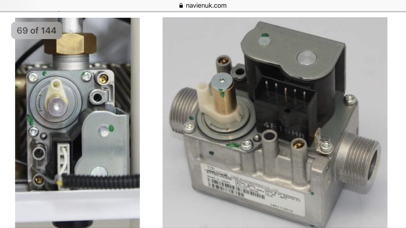

What does that look like ?
Some negative pressure gas valves when coupled up to the right fan with give -50 mbar at the valve's oulet. That is minus 50. That may help you along the way.
After the venturi. I don't think you will get it. Remember I did give up on you.
Our fans create a negative pressure and pulls gas and air through Venturi but it is then positive pressure on the other side of fan to push through burner.
How does your burner work then?
Fecking fan the size of a jumbo jets engine to get -50mbar.
Ours creates -11pascals on full rate at gas valve outlet.
That sounds rather high, 500mm water.
And that seems low, 1.1mm water. Maybe it's enough for your burner.
