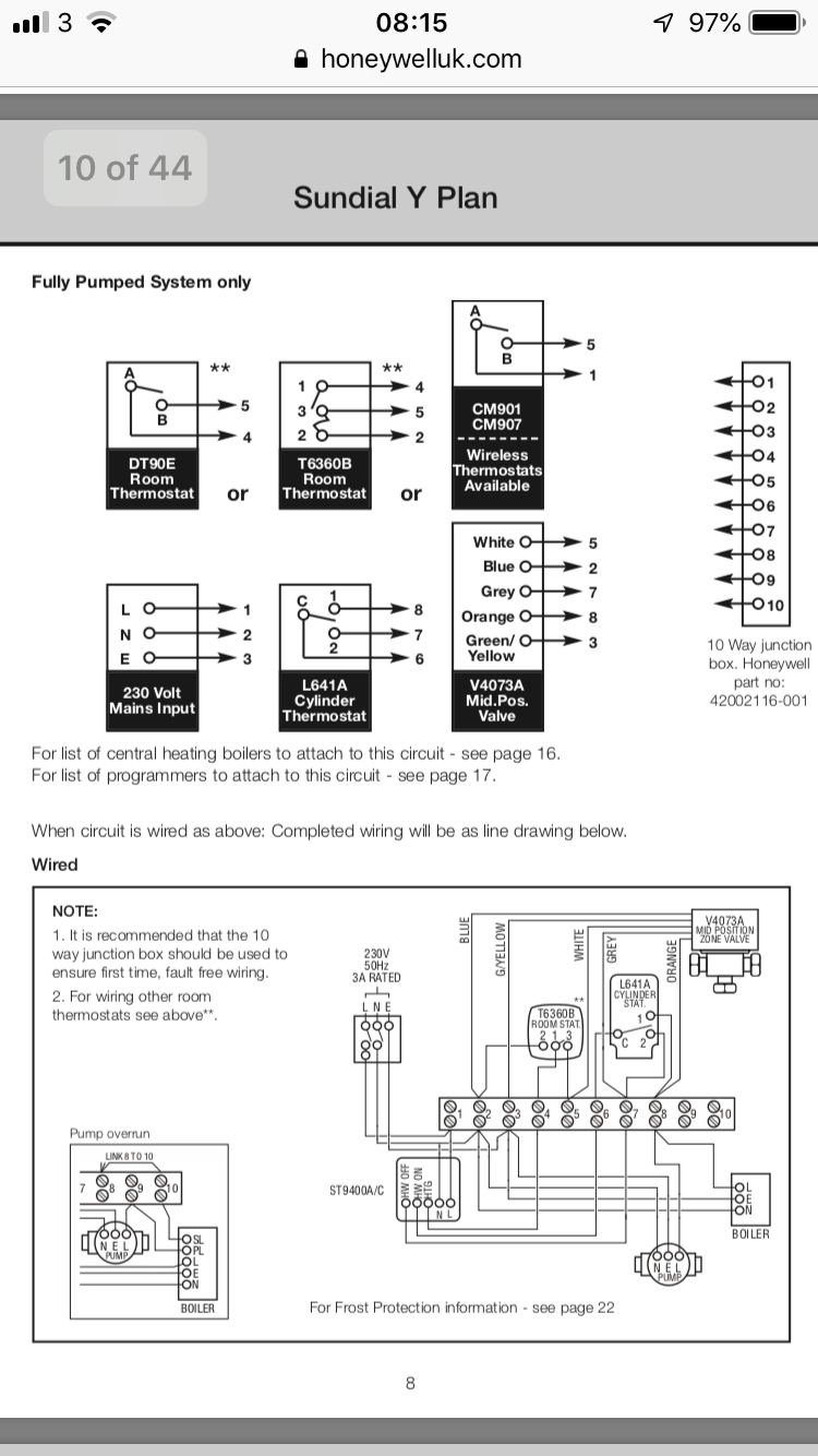

Hi all,
First time I wired it - given that it was all a bit ad-hoc, I just switched the wires around but must not have wired the pump properly, so the boiler started and went a little crazy!
I guess the clue is here. The boiler overheated
I don’t think so, the earth wires from the mains, boiler and thermostat were all wired in to one earth cable. When I first had a go with the Programmer wiring, I think I wired in the boiler without the pump and it may have just overheated the PCB or something.

View attachment 148886 I just tried switching the cylinder stat 1 & 2 wires (although I actually realised I had them as @EFLImpudence had suggested) - so this was now:
7 - valve grey cylinder 2
8 - valve orange, cylinder 1, pump and boiler L
I said it was this way around before as (maybe I’m being an idiot but) that’s what the Nest wiring diagram (previous post) seems to suggest, but having relooked through the Honeywell diagrams (above) they state as @EFLImpudence does, which is how I had originally wired them.
The power came on after changing the fuse, tried HW on first and nothing happened, then I tried heating and the fuse blew again. I’m assuming the cylinder stat is wired incorrectly this way and therefore the hot water remains off as the boiler didn’t come on (and the circuit didn’t blow on just HW).
It sounded like the valve clicked over when I turned the heating on, so I’m once again assuming that it’s either the boiler or pump that’s shorting the circuit?
So do you think the circuit shown in this pic relates to the boiler requirements?
