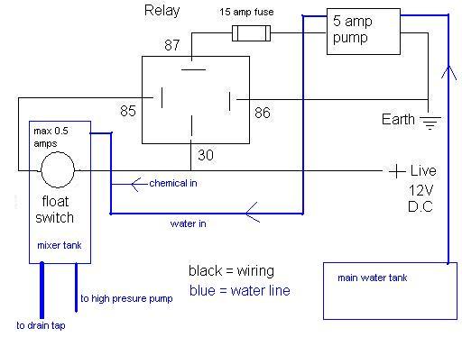

Hi
I need a time delay circuit, had a look on the internet and could not find any for sale
So I probably need to build a time delay circuit that when the float switch closes (opens the circuit) there will be a time delay from when the pumps turns on
And/or when the float switch opens (closes the circuit) there will be a time delay from the pump turning off
And the time delay must be started and reset from the switch opening and closing not the circuit to have a set time regardless of what the switch is doing
The reason I need this is to stop the constant on/off cycle of the pump turning on and off with the float switch bobbing up and down on the water surface as the mixer tank is being filled and emptied
The mixer tank is supplied by a 12 volt 5 amp pump controlled by the float switch and has a max switch of 0.5 amp
The tank is emptied at the bottom by a drainage tap and water being drawn from the tank to a high pressure pump
I am working on a ball park figure of a 10 second delay from when the float switches and the pump starts or stops
This will probably have to be tweaked once the time circuit is build and fitted to the mixer tank and once I have seen how it fills and empties in the tank
A believe there is the ‘NC555’ chip and the ICM7555IPA chip that can be bought from maplins
But maplins don’t sell a complete circuit
Please note the only electrical experience I have is with 12 volt plug and play and recently relays
So diodes capacitors and resistors is all new to me
If possible could someone post a diagram of how to wire the NC555/ ICM7555IPA up and wear it should be placed in relation to my schematic

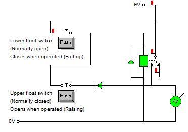

Why not have 2 float switches, lower one to enable a latching relay and a upper one to switch it off?
Why not have 2 float switches, upper one to switch enable a latching relay and a lower one to switch it off?
Beat me to it.
Using a latching relay ( or contactor with a contact wired to latch ) is a far better way to achieve the end result when controlling tank filling or emptying.

Sorry spark123 the 2 float switches in the mixer tank never rely worked
No matter what I did the lower switch just kept welding/arching together to the point now wear ist knackered and can’t be reused
I had a man from switch and sense draw me a diagram of how to wire both switches into 2 different relays all that happened is when the water reached the lower switch it switch on and off all the time eliminating the point of have an upper switch
The only reason for the switch welding would be too much current flowing through it owing to ommitting the diode or a spike caused by the voltage caused by the relay switching off.
This can be overcome by fitting a reverse biased diode across the relay coil:
So all you need are 2 switches, a couple of 1N4001 diodes and a 12v relay!
Having 2 relays should have worked too, ignoring the spike mentioned above the the 2 relay coils would have been wired in parallel, one relay used for control and the other to switch the pump.

the original schematic I posted cane from the manual it self
