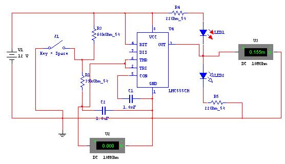

The NE555 timer will switch states at 1/3 and 2/3 of supply voltage so with a potential divider and through a resistor either taking the control voltage high or low it would give a controlled delay in the output.
But I am not too sure exactly what you are trying to do. And is it for fun in which case yes play with 555 or is it more important in which case use a liquid control relay which has this all built in.

Once the water level reaches the upper float switch and operates it the pump will switch off. The cycle will then start again, when the level drops past the upper float switch it will go closed again but the relay will not close until the lower one operates.
This circuit
is really an anti-bounce in that it has a min time in either mode so if your float switch was where my switch is shown then instead of reacting immediate there would be a delay which would stop the relay contacts from chattering.
This is theoretical as I don't know what times you want.
And yes it is a multi-vib circuit but instead of going to pin 7 it goes to float switch.
