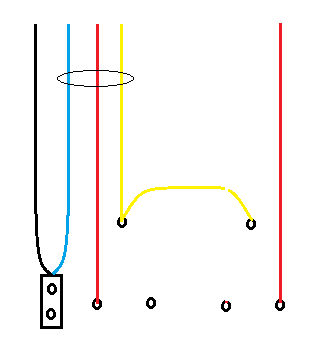

Send some pictures of the switch so we can be more certain.
Too tight to the wall to get a decent picture of connections. As I said, two red wires, one to the L1, one to L2 and the yellow SL going into COM on one L1 side with a crossover wire from that COM to COM on L2. The blue and black neutral wires are going to an old style connector block.
That description is confusing me.
Can you say which WIRE comes from each CABLE, and which SWITCH is for which room or light.
two red wires, one going to the L1 and L2 on each side and the yellow SL going into COM on one side with a crossover wire to the other COM.
Your descriptions are careless and confusing and the wiring more so.
Is this what you mean?

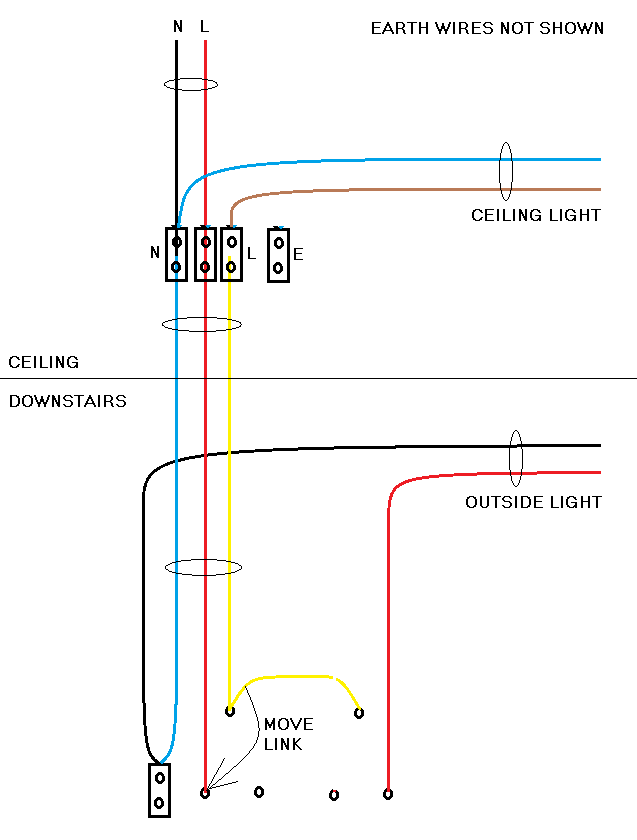

This is all I can make of it - from what you say - sort of.
You really ought to test that the wires are as I think.
That is that the L and N really are L and N, and the cable to outside actually is.
If you want the outside light only to come on if the hall light is on then leave the switch wiring as it is.
If you want it to work independently then move the link wire as shown.

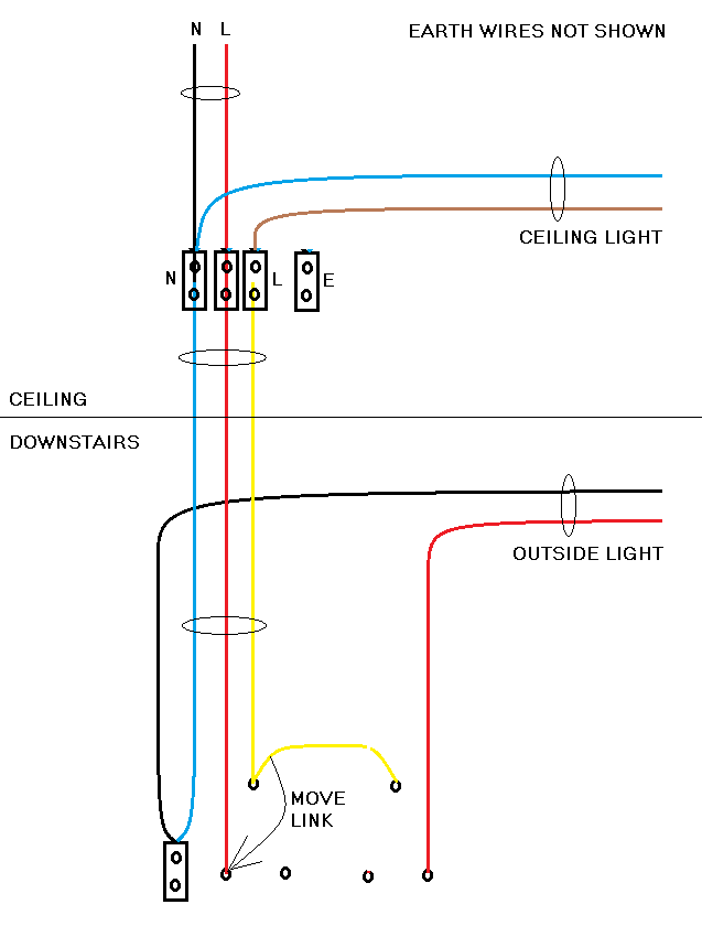

That works great. Thank you for all your time and effort.
