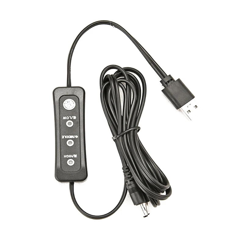

Although one could easily make an adaptor for this purpose
I doubt that there is an "off the shelf" adaptor to do this.
HOWEVER
there are these - with a High, Middle and Low adjustment.
https://www.aliexpress.com/item/100...41OZc57c&utparam-url=scene:search|query_from:
I expect that you could "interpose" that "adjusting" device at the input USB connector of your gloves !

I suggested connecting in SERIES - to reduce the heating to 25%
The Controller giving High (normal, Middle and Low heating costs less than £3.00
(Plus the equivalent of USD$2.00 - for postage. Total, about £4.35)
and
should take 10 to 14 days to reach your postal address,
by which time it will be early December - if you order NOW !!!
