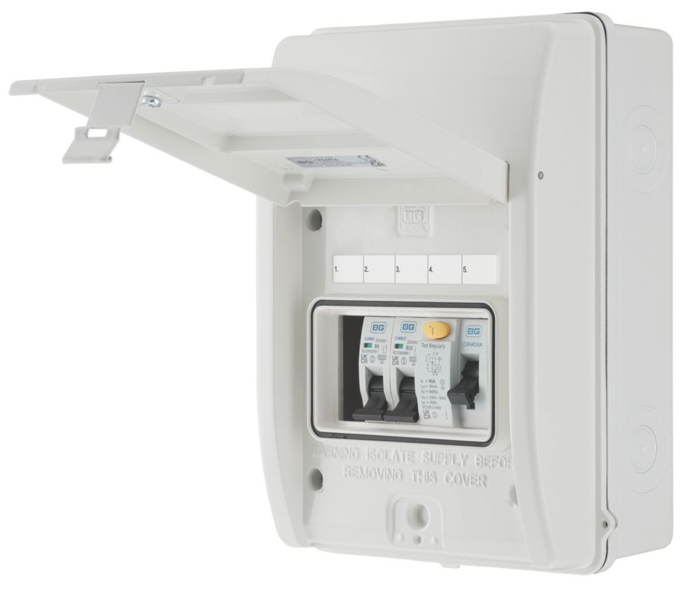

what should I use for this purpose?
If you actually need an RCD in it, then
and https://www.screwfix.com/p/british-general-16a-sp-type-b-mcb/35253 if the 16A MCB is actually needed.
If there is an RCD / RCBO on the supply to the garage then no RCD required, same unit with a switch only would do.
Or just connect the supply direct into the sockets and fit a couple of FCUs for the lights and door opener.
