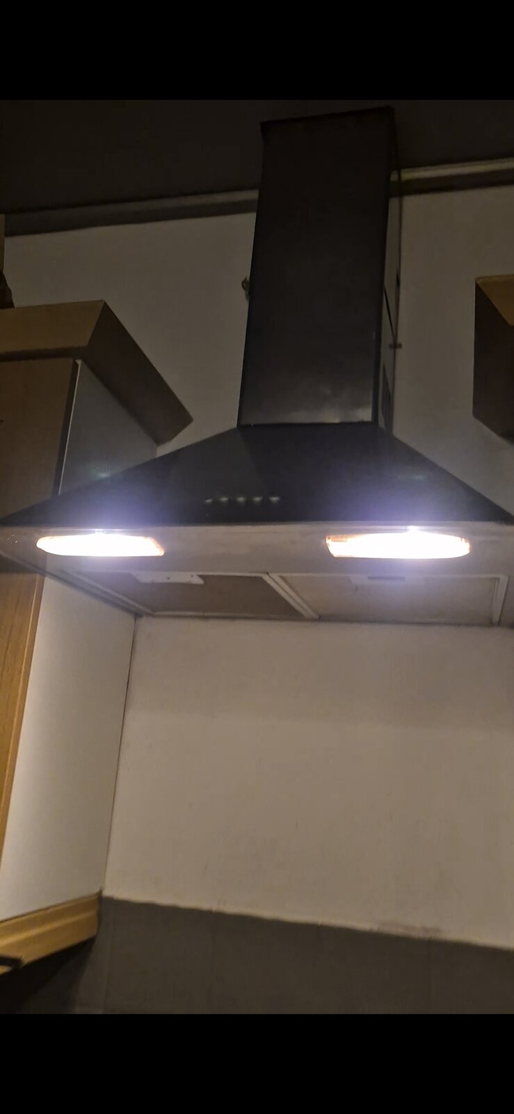

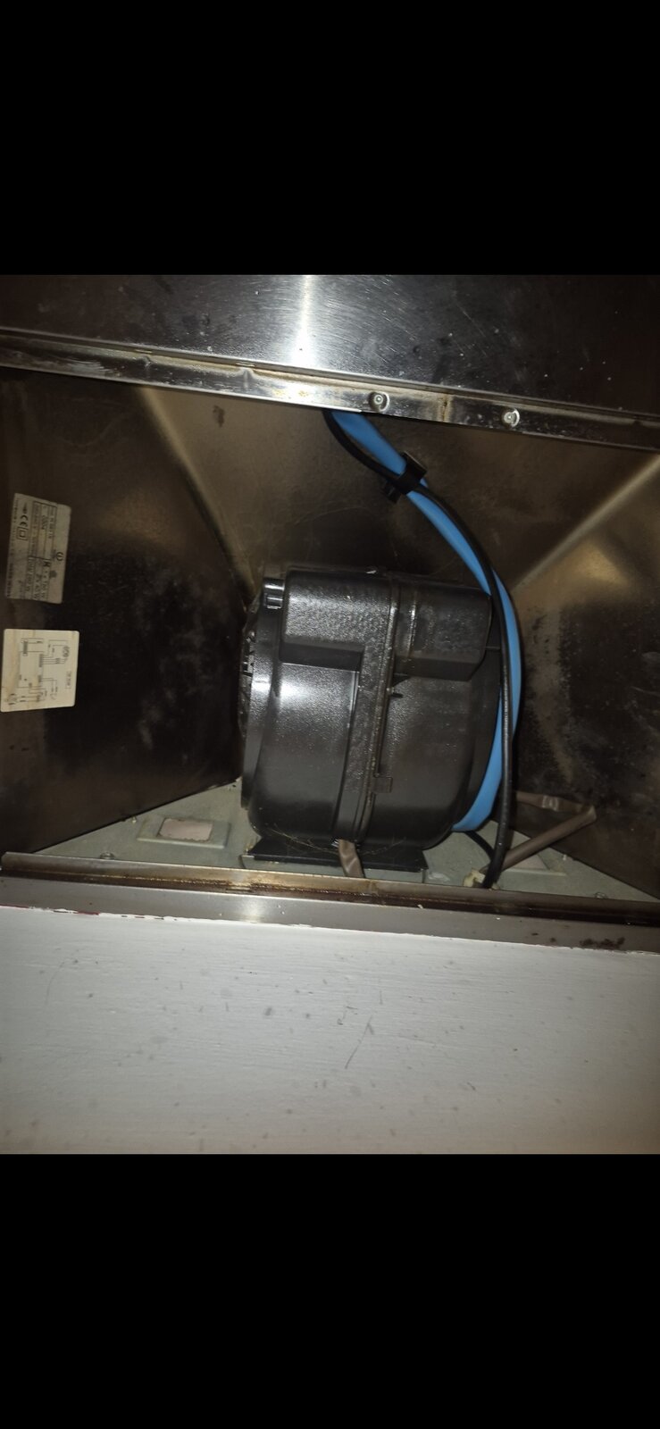

Hi all
Hoping for some advice.
Our next door neighbour, terraced house was saying he's getting all the smells from our extractor fan when we cook in his upstairs bedroom.
Even though our extractor fan is at the opposite end of the kitchen to our joining house walls. He let me smell in his kitchen and it does seem like he's right? But hiw can this happen? The smells travel all the way along the whole length above of our kitchen ceiling then through the wall into his upstairs bedroom?
He ofcourse wants a solution.
We just moved in a few months ago.
There's no pipe going out to the outside from the extractor fan but maybe this extractor fan doesn't need one?
Any advice appreciated .
Please see attached photo and it's a
Indesit H 561 IX​

In theory ductless extractors with carbon filters work. You need to duct the fumes to a suitable location on an outside wall. At the moment they are probably finding their way into the neighbours bedroom via joists in the ceiling and through gaps/cracks in the party wall.

The fumes are coming out of the hood through the vents at the bottom of the chimney. Unless the grease filters are regularly cleaned and the charcoal filter replaced (although I see they are no longer availible) all you will be doing is blowing fumes around. They are a bad idea. Ideally it should be replaced with a vented hood. Have you tried not switching it on and opening a window/door to the outside?
If you have just moved in and started using this extractor that perhaps your predescessor did not, then I think that unless you get the fan vented through the wall you will start getting black mould forming on your walls and ceiling in the kitchen due to condensation. As others have said the recirculating type are useless. If you look at it from your neighbours point of view then it is you who are causing the nuisance and you that should rectify it, even if it was because it was not installed properly from new.

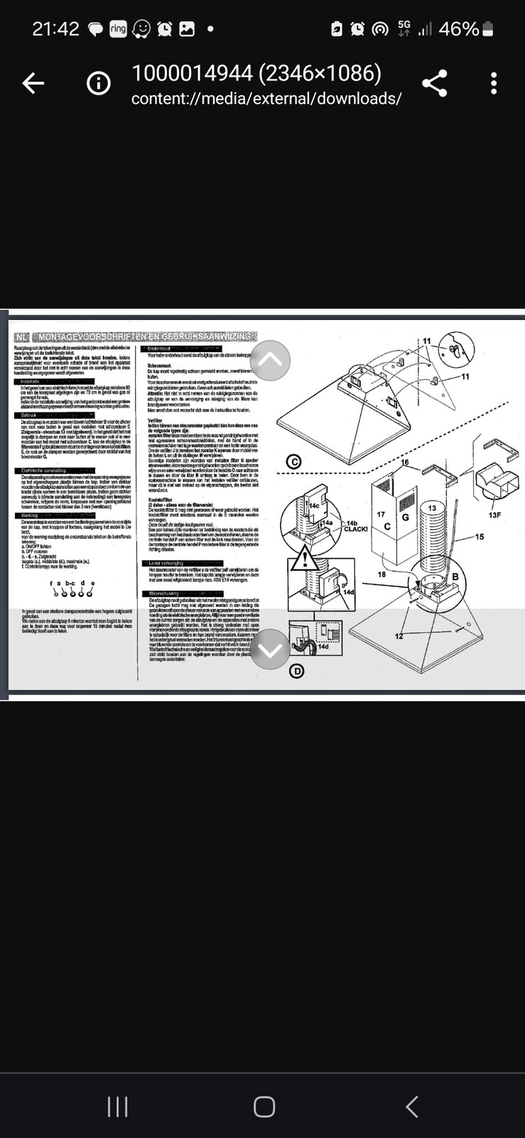

If your extractor hood is a dual purpose one (extractor or recirculate) firstly check it is set to recirculate. Looking at the pretty poor manual it would seem that it needs a director vent to be recirculate. I wonder if the previous owner or installer let the extractor vent into the cavity - a concern as that will promote damp in the most unexpected of areas.

As far as I know all extractor fans can be either recirculating or can extract externally.
I don't believe they make recirc only. All extractor fans have a hole in the top "some you can vent out immediately at the rear with some jiggery pokery" but most have either a 4/5/6 inch hole on the top behind the metal cowl that hides all the gubbins.
Your extractor only works for external extraction if its fixed to an outside wall.
An alternative is to put a flying shelf on top of the wall units, lower the extractor to achieve 750mm from top of gas burners if gas or 650 if induction. You can then cut a hole in the flying shelf that's smaller than the cowl instal ducting from extractor across the top of the wall units to the outside world and fit cowl between extractor and the bottom of the flying shelf.
Recirculating mode is only meant for kitchens where venting outside is impossible or the kitchen fitter is lazy.
