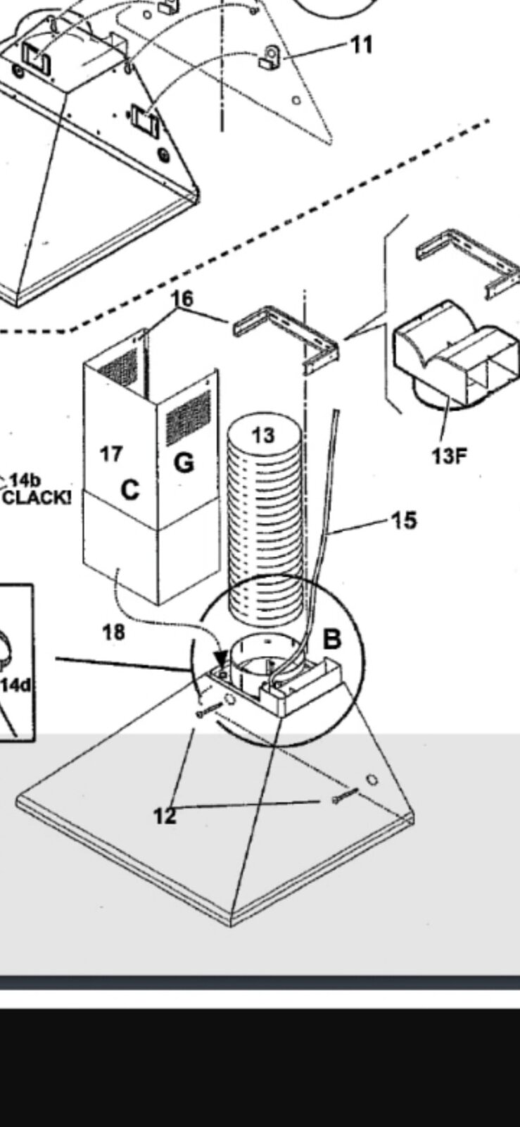

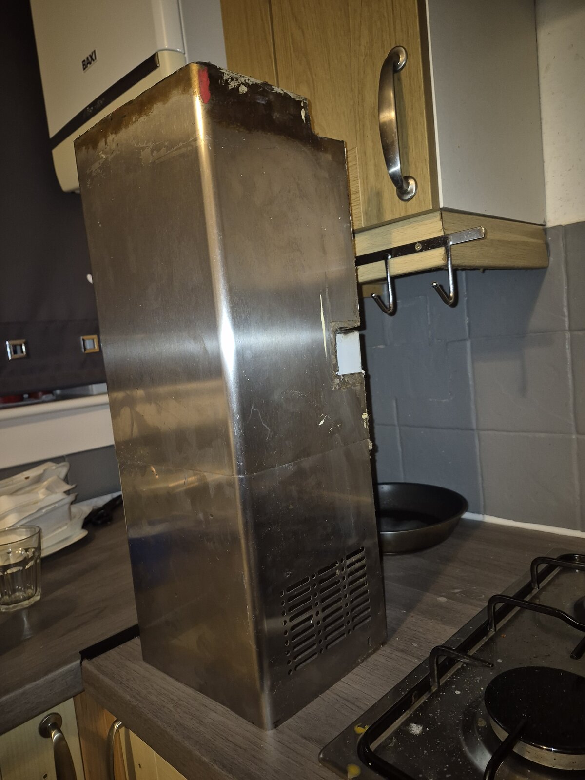

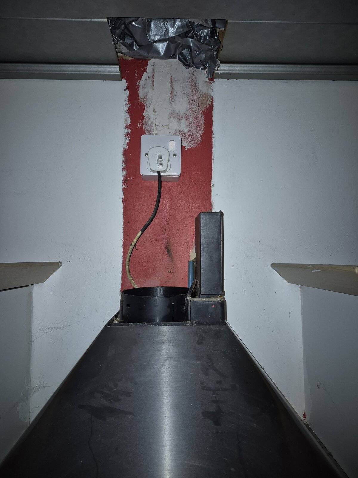

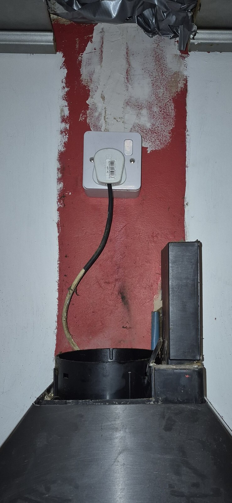

Now looking at the diagram on the manual and the actual pictures. It is missing part 13, the long tunnel thing that's suppose to go up the fan chimney and missing 13f and 16 and also part 17 is on upside down!!!! It's off at the moment but that's the way it was fitted. Either installed totally incompetently or there was no room at the top between the ceiling and the hood that they have just improvised and came up with that.

I think I know why they removed part 13, 13f and 16 when fitting it. The wall socket is in the way, so they just didnt install those essential parts and in order to fit it.
and to fit part 17 ie the cover they put a hole in the false kitchen ceiling which then allowed the fumes to travel straight into the space between the false kitchen ceiling and the real kitchen ceiling and traveling to my neighbours bedroom.
the issue I have now is how can I ensure when I buy a new extractor fan that the wall socket will not be in the way and prevent fitting it?
Wish there were companies who deal with these and can come out and look and tell me which will fit etc and then install them.

If the socket were made into a flush socket, or simply moved to one side - those missing items might have fitted, but there is still the issue of cooking smells and fumes escaping. Your only worthwhile solution is the find a way, to pipe the fumes of cooking, outdoors. Recirculation systems are not permitted any more, because of the problems you are experiencing.
Thanks. But how can we get a vented extractor fan with that wall socket sticking out there I wonder?

The issue is there's a wall socket right where a cooker hood chimney would be which is clearly the reason the previous owner removed various parts which has caused the issue with the smells going into the neighbours bedroom. As these parts would have directed the fumes into the two side grills at the top rather than directing them fumes into the space between the false and real ceiling and up to his bedroom.
