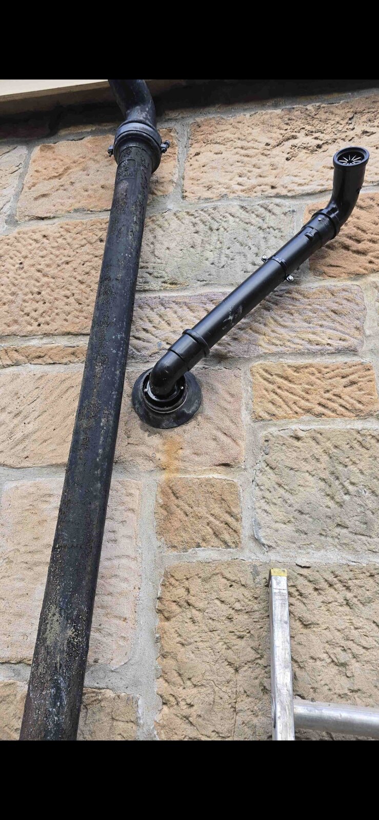

I spoke to an electrician and said it's not possible to vent an extractor fan, in fact let me quote him. "To get pipe out will be a problem, your boiler flue must be min 300 away from any openings to the building inc extractor openings"
He said he can fit a plume like in this photo but I'm mot keen on a plume going along the wall, would rather just the one opening coming out and run it along inside the wall cavity somehow? If possible

What I have done to pacify the neighbour and hopefully stop the smells into his bedroom I've covered the top of the largest circle part at the top in this picture also where it says 13 on the diagram.
Is this OK do you think and won't cause any serious issues or dangerous?
