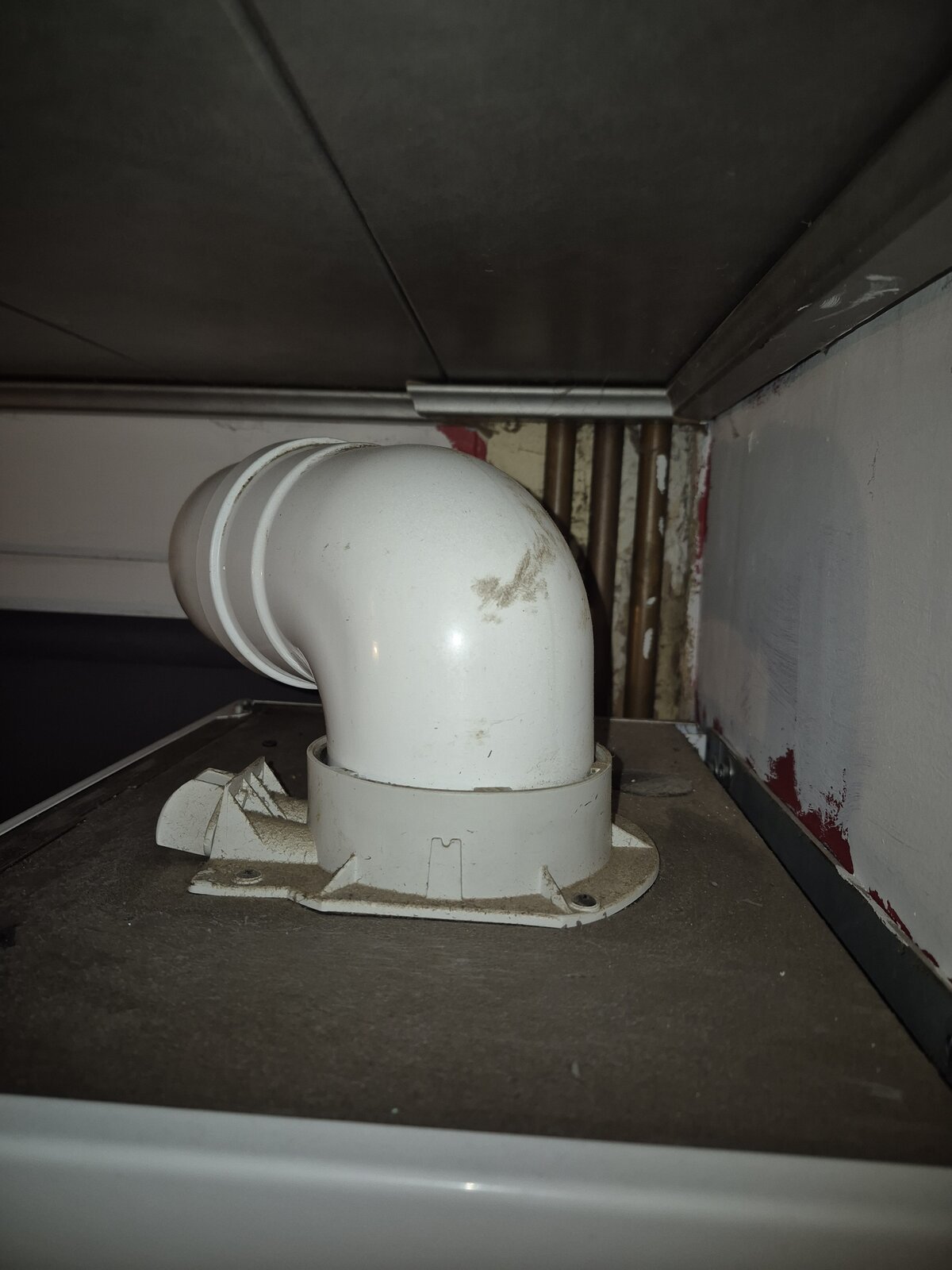

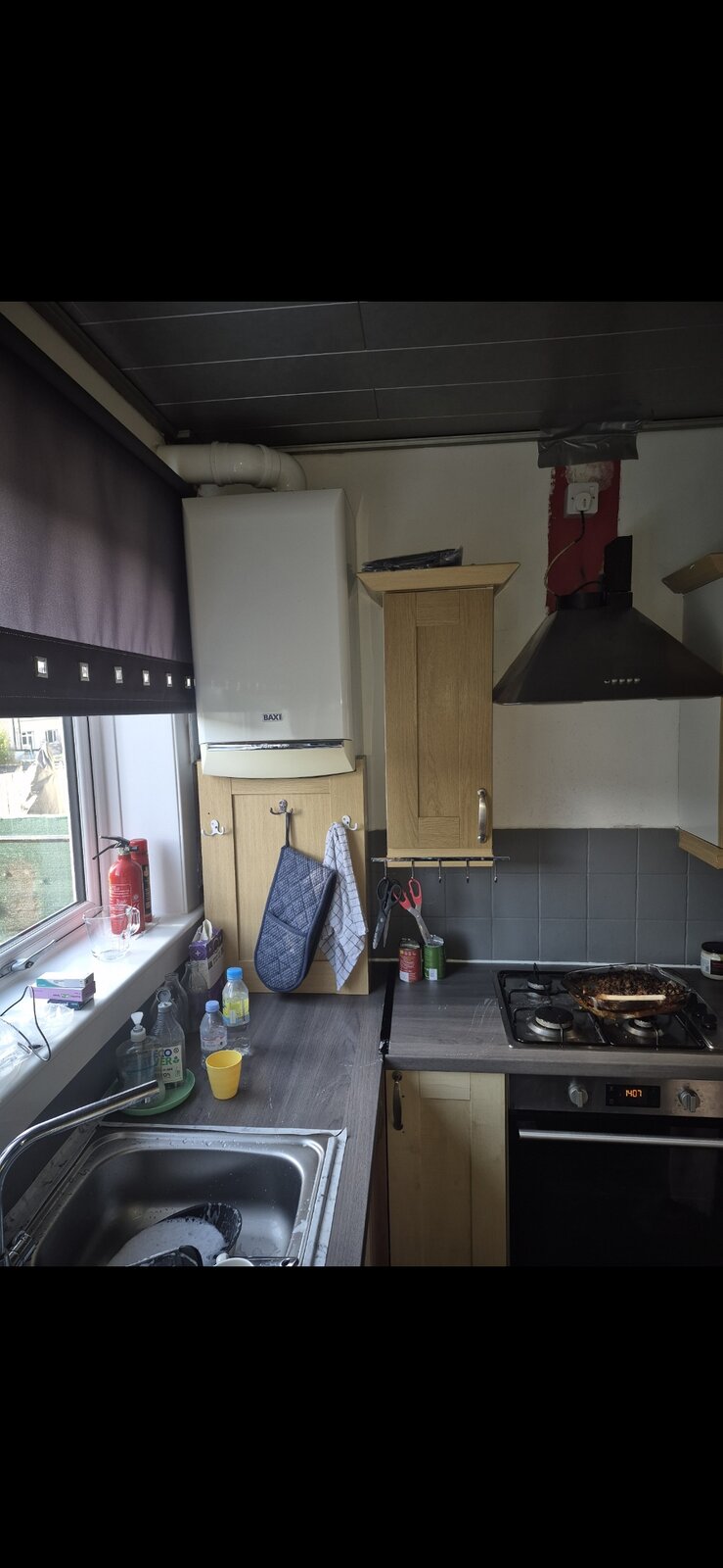

I have had a look above the false ceiling where the previous spot lights were and can see the previous owner has cut holes in the real ceiling in order to install the spotlights.
Please see photo.

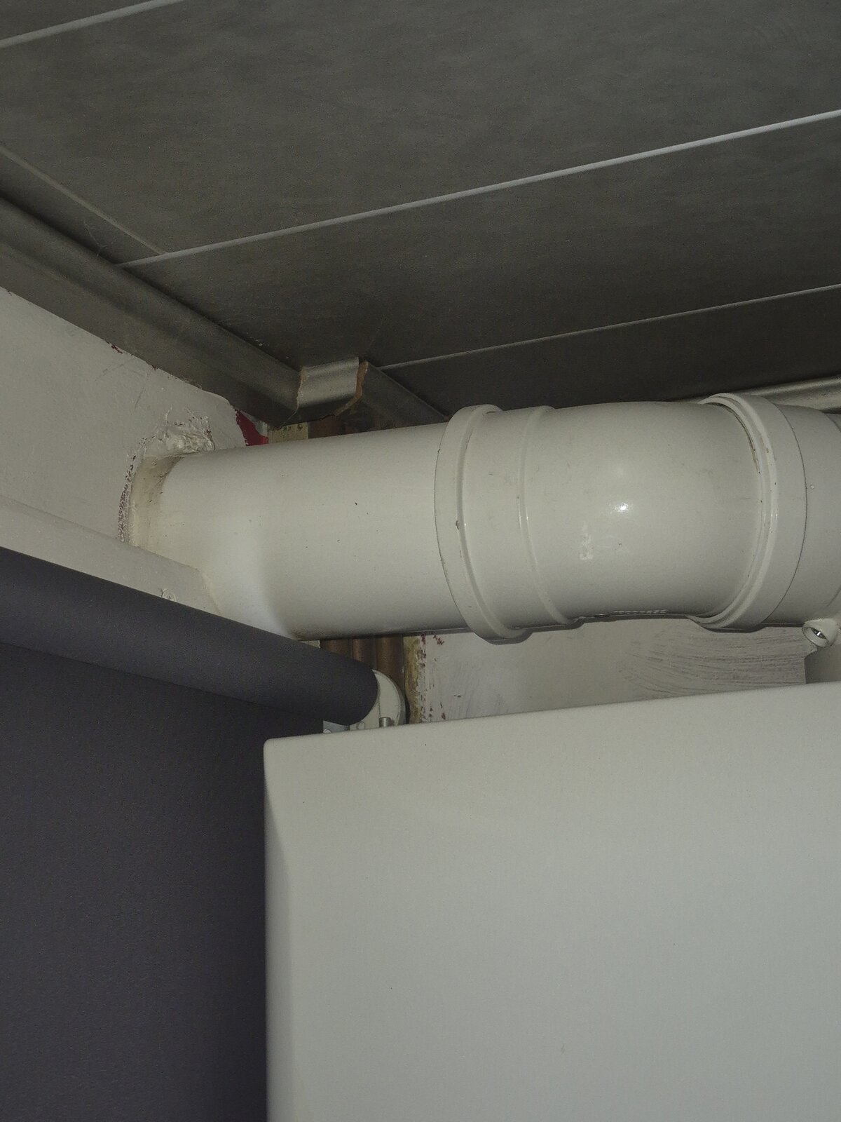

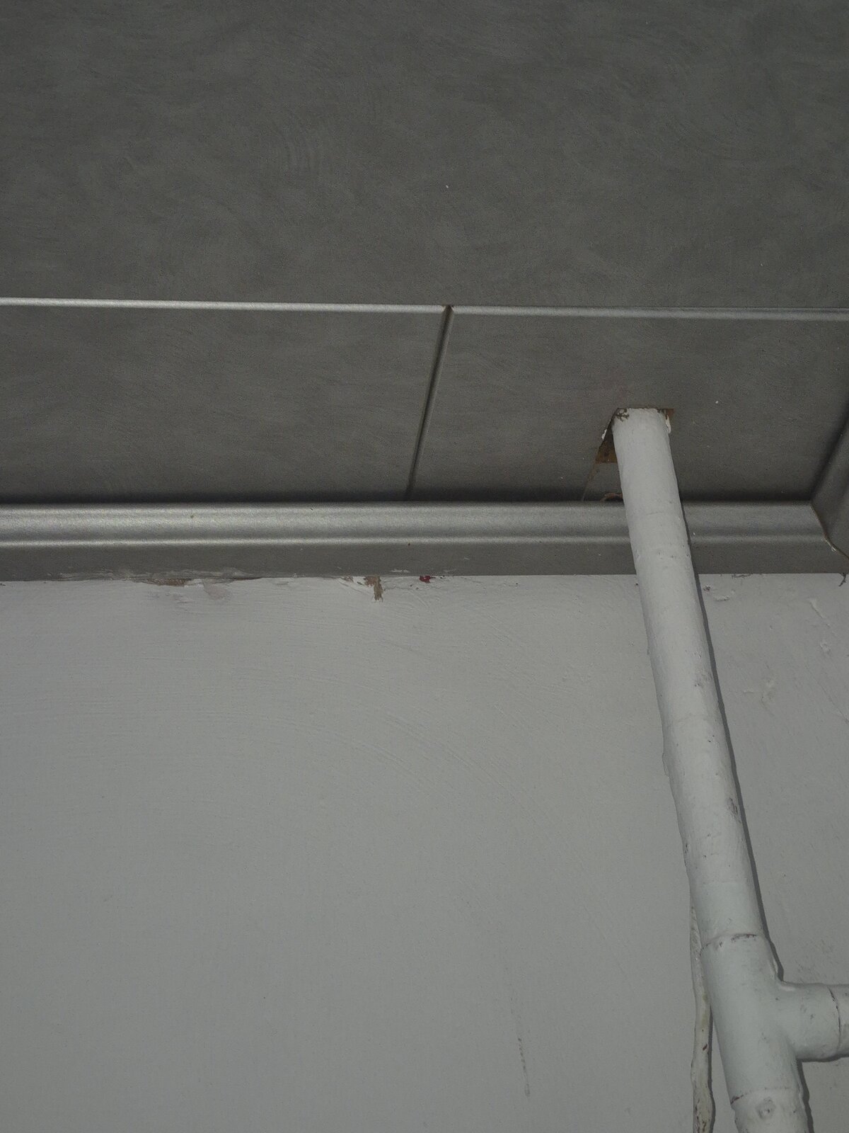

We could caulk between the gaps yes. Would take a huge amount of time as there the top and bottom of the skirting. Please see photo. Rather than masking tape.

No gaps I could see between his skirting and the wall and floor in his bedroom.

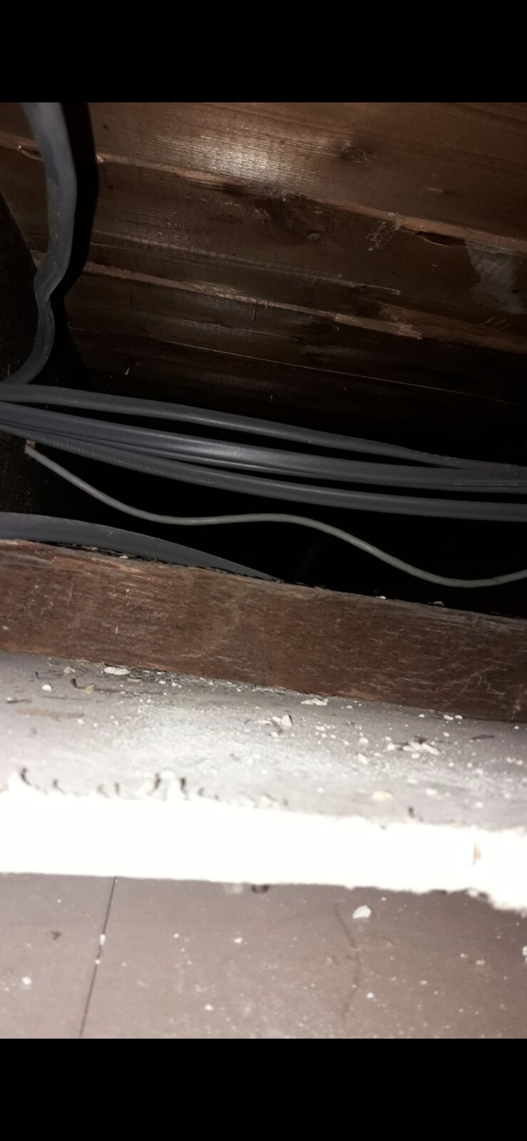

Even if we get an extractor to outside it may still not solve his issue. I need to also see if there's an option to do this under the false ceiling above the boiler to see if there's any joists there. I did try and remove the false ceiling to look but it's so well attached and not sure how to remove one of the panels to see. Any idea how I can do this easily?

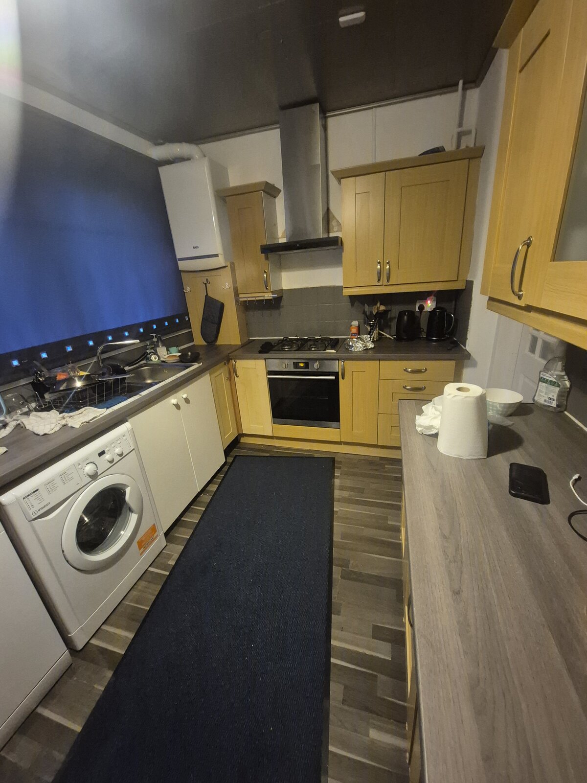

8 pages, and we don't have much idea of the full layout of this area. All we are getting from the OP, is close-up photos, of small areas.
My apologies Harry here's one.

As a trial, to see if it fixes the problem, get some flexible trunking and run it from the cooker hood outlet to the window whenever you are cooking and run the cooker hood. If that solves the problem you will know you have to somehow get a permanent arrangement installed.

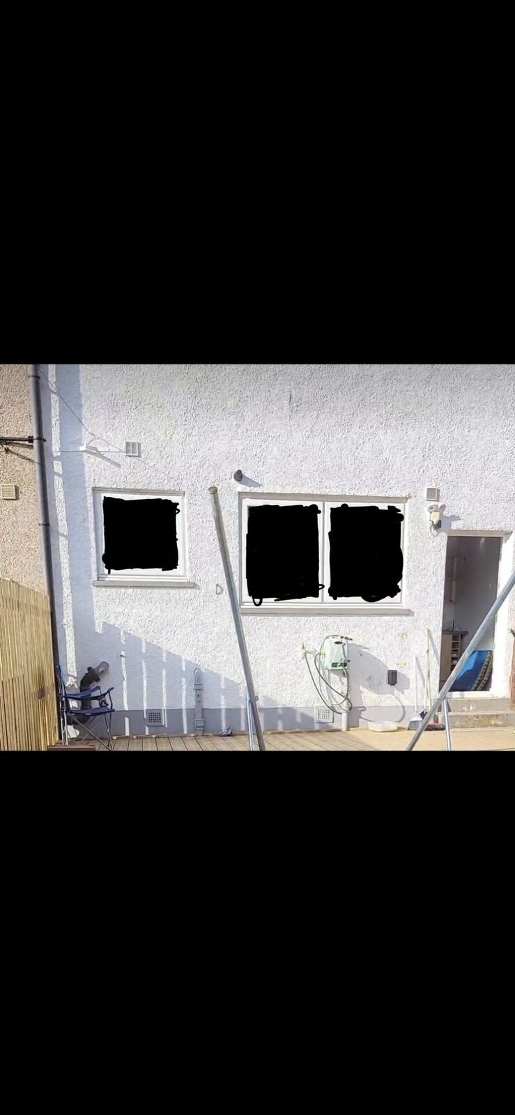

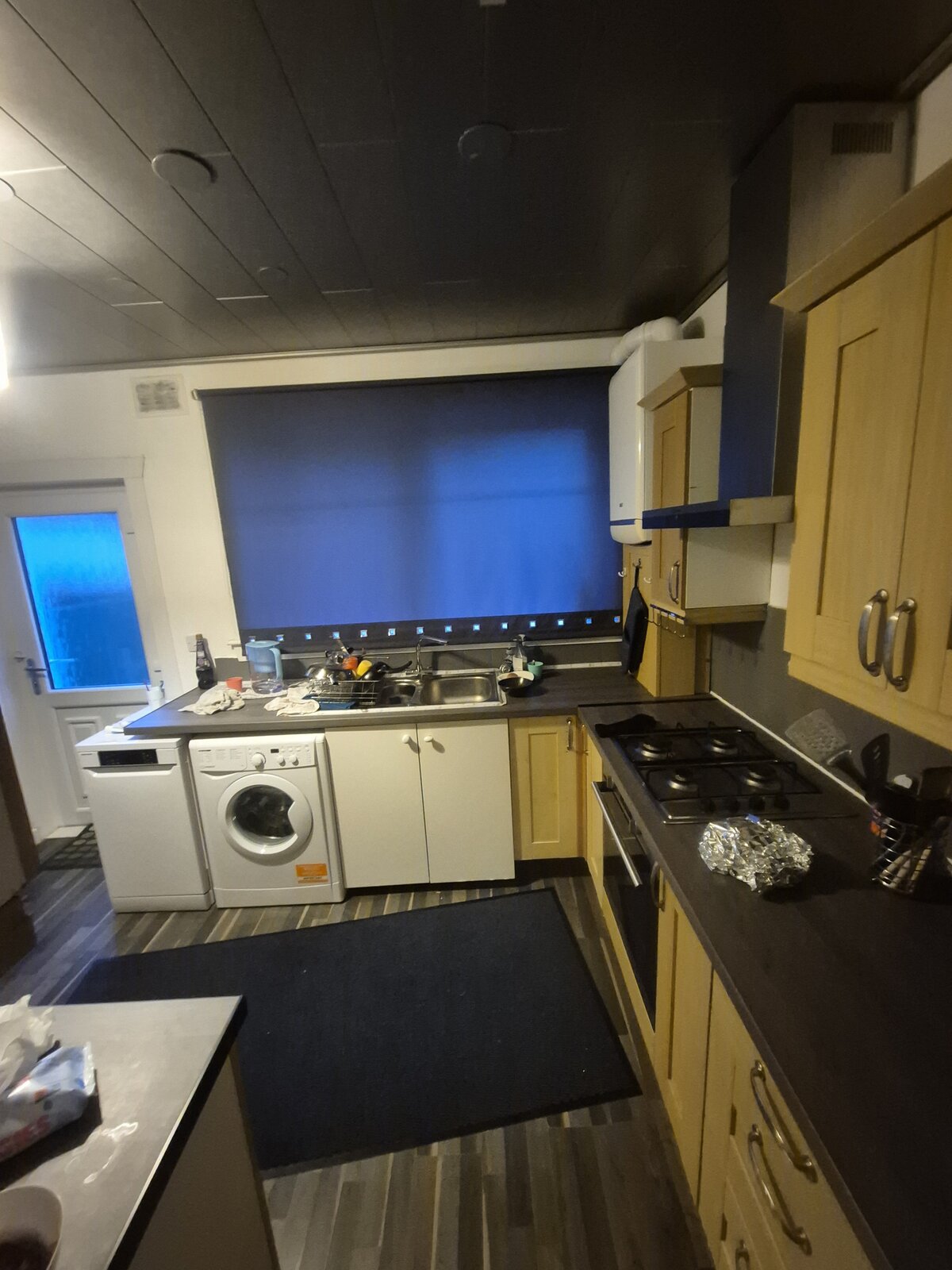

We've seen that before. What we need is outdoor photos, from far enough back, to get an idea of the general layout, and layout diagrams. So far, all we have seen is through a keyhole photos.

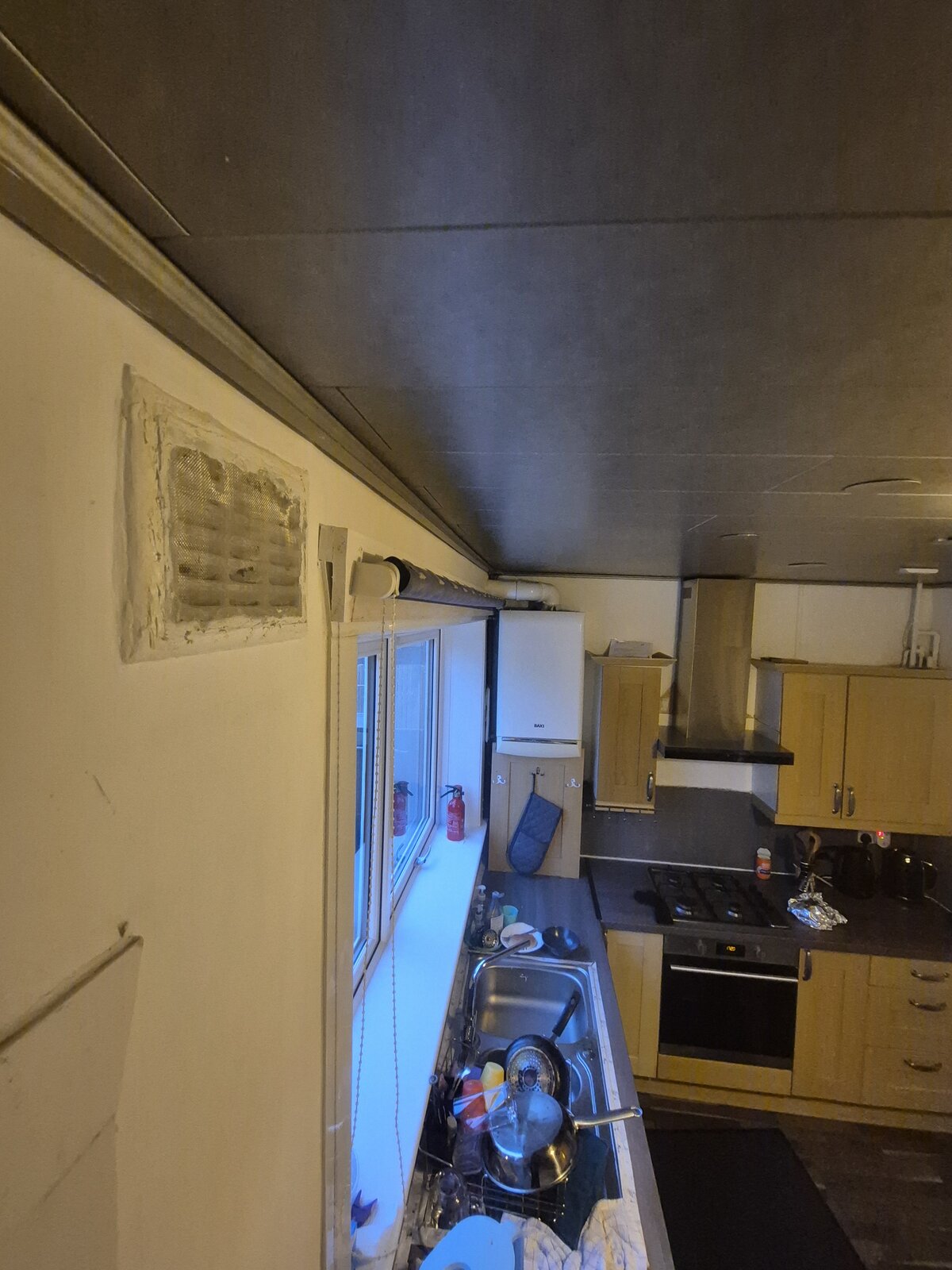

This might be a possible route, for a duct, mounted on the ceiling. It looks from the shadow on the blind, as if it would clear the lintel over the window, but without adequate photos, it's anyone's guess.
Thabks Harry here's some more photos and hope adequate enough

Much better. The route I suggested above seems feasible, however..
The outside view, suggests there is some sort of small room, or at least a window, at the other side of the wall to the cooker. In which case, might it make for a tidier looking job, to make hole through that wall, then run a duct in that room, then out through the wall?

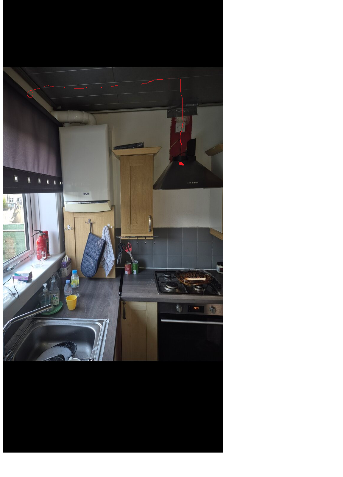

Thanks that's actually a bathroom window there. One of the electricians said he could run it though the bathroom wall but for some reason he said you would need to have a pipe running under the bathroom ceiling though and my wife said she wouldn't like that.
On your orginal picture with the red line we were told this can't be done due to having to cut a hole though the joists which run parallel along and also told you can't have it vented above the window for some reason.
I was suggesting running the duct on the surface, clipped to the ceiling.
Run flat channel ducting from your extractor fan along ceiling, above flue along to existing vent
Yes this is the idea we liked but an electrician said you can't put a hole above the window but the window runs to where the blinds start so only about 20cm from the ceiling and also you would need to cut a hole though the concrete that holds the window and wall in place. This is what the electrician said and why it can't be done this way. Not sure if he's correct or not.

No space as there's pipes from the boiler there.
