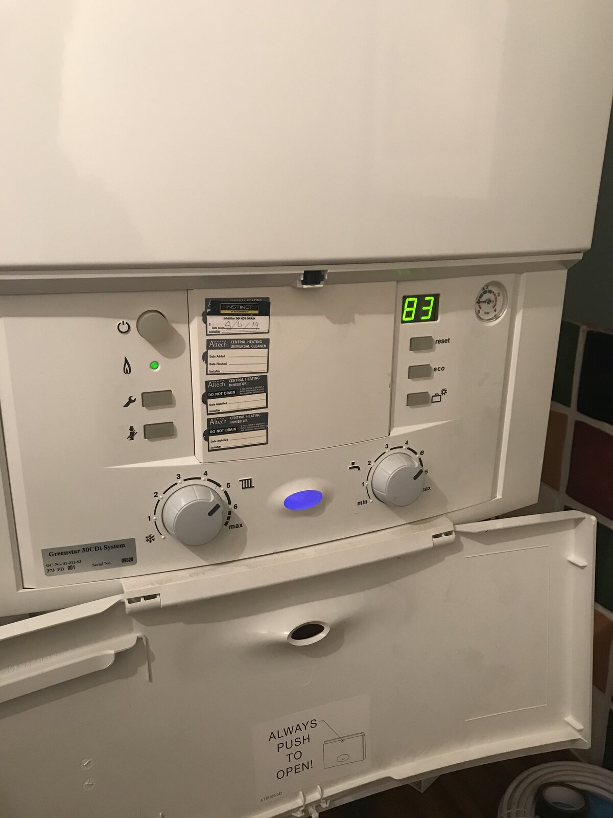

As above I got the boiler running last night which was fine for rads and hot water. It ran really hot (85 degrees C?). Got it to turn off by flicking the valve back over to auto (took about 5 mins then switched off).
This morning I did a similar procedure to get the radiators warm -> valve to manual, controller HW/CH both on continuous, ran some hot water for a few minutes then around 5/10 minutes later the boiler fired up and started heating the water (which had the effect of warming the radiators too since the valve was open). Again ran really hot (picture attached) till I flicked the valve back over to auto.

EDIT: forgot picture

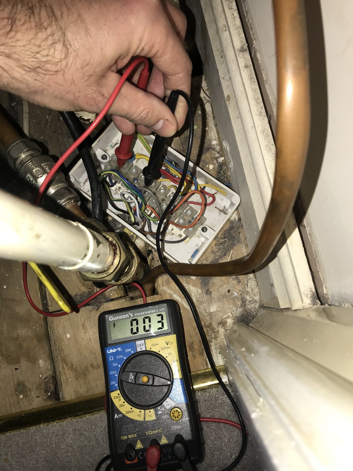

[Ok so with the nest on manual (both hot water and CH on) I’ve got a reading of nil across those poles (see picture).
With just CH and no HW same result. Pretty sure I’m on the right wires from the valve (black cable entering wiring from the bottom in this picture -as awkward as everything in this system!)]

your Multi meter is set to DC you need to set it to AC, also why are you testing to earth when you have been told to test between the white wire and neutral ?
Doh! I blame the crap lighting in that cupboard!
You are right on both counts. Testing white to earth 240V... more importantly... testing white wire to neutral with HW or CH on gives 0V in both cases.

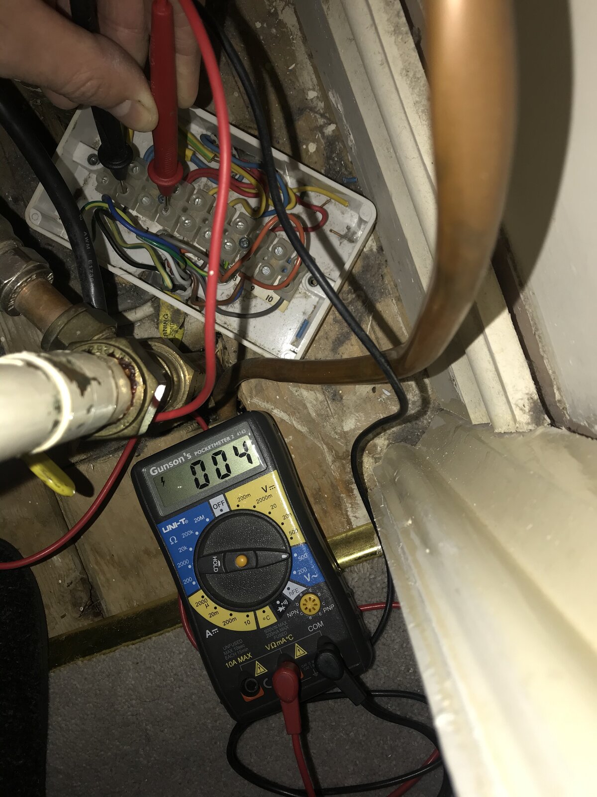

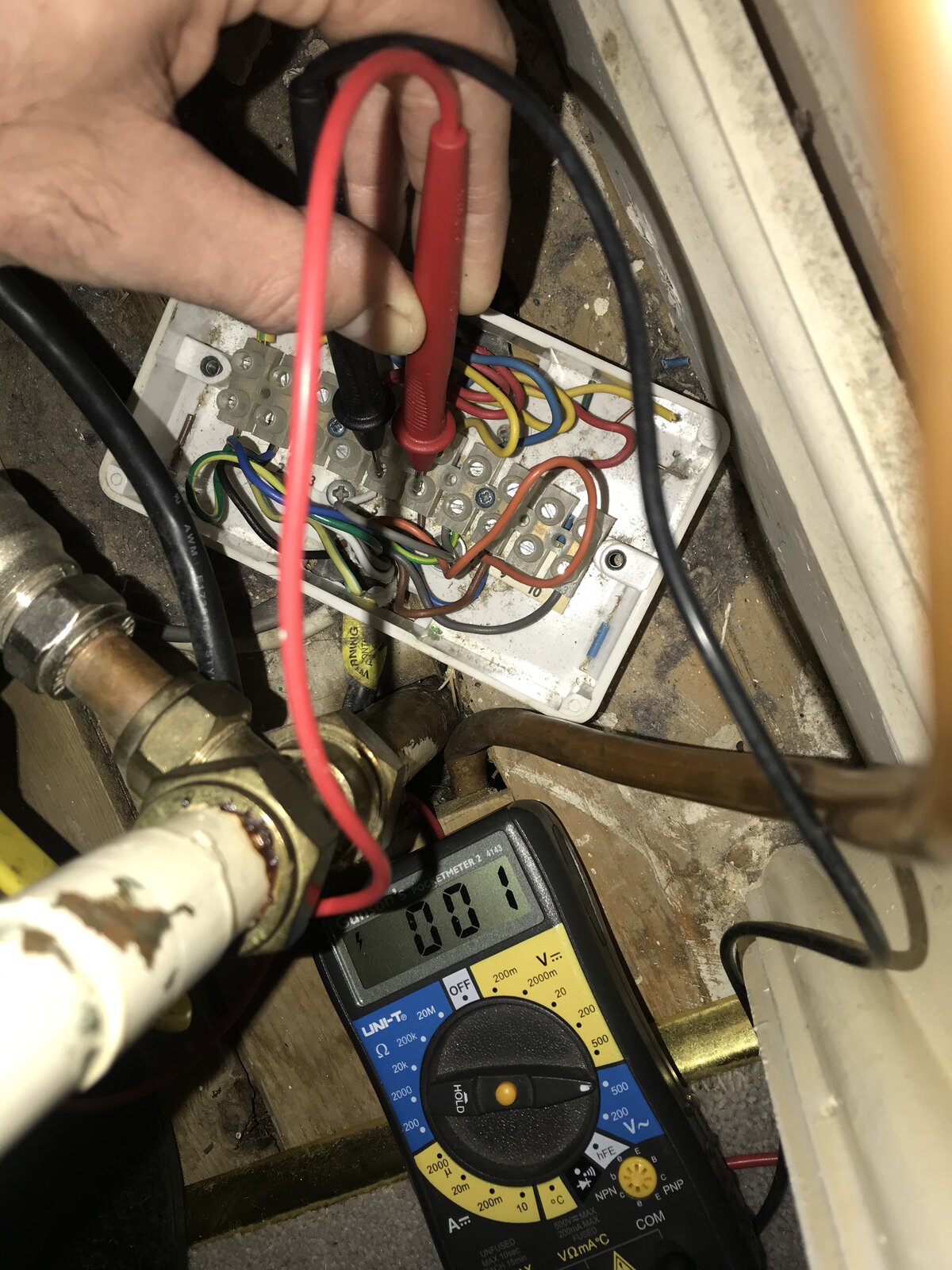

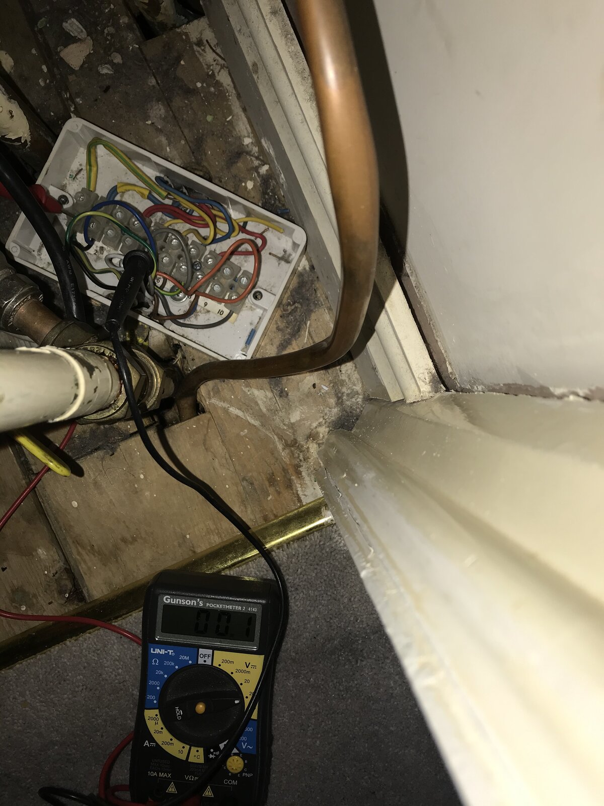

select heating and HW both to on and test at the nest between N and 4 then 5 then 6 you should get 230v AC at all 3 terminals
Both CH and HW on
Neutral and 4 - nil
5 and 6 - nil
appreciate pictures aren’t great terrible angle let me know if need better ones ... many thanks for your patience!

you have no idea what you are doing, put the red probe on the terminal with the white wire and the black probe on the second end terminal with the blue wires going into both ends
The white wire is terminal 5. You said terminal 4... so I did terminal 4 - see picture 1?
I guess you meant N+4, then N+5, then N+6?
If I knew what I was doing I wouldn't be asking chap.
Give me 2 mins and I will update.
